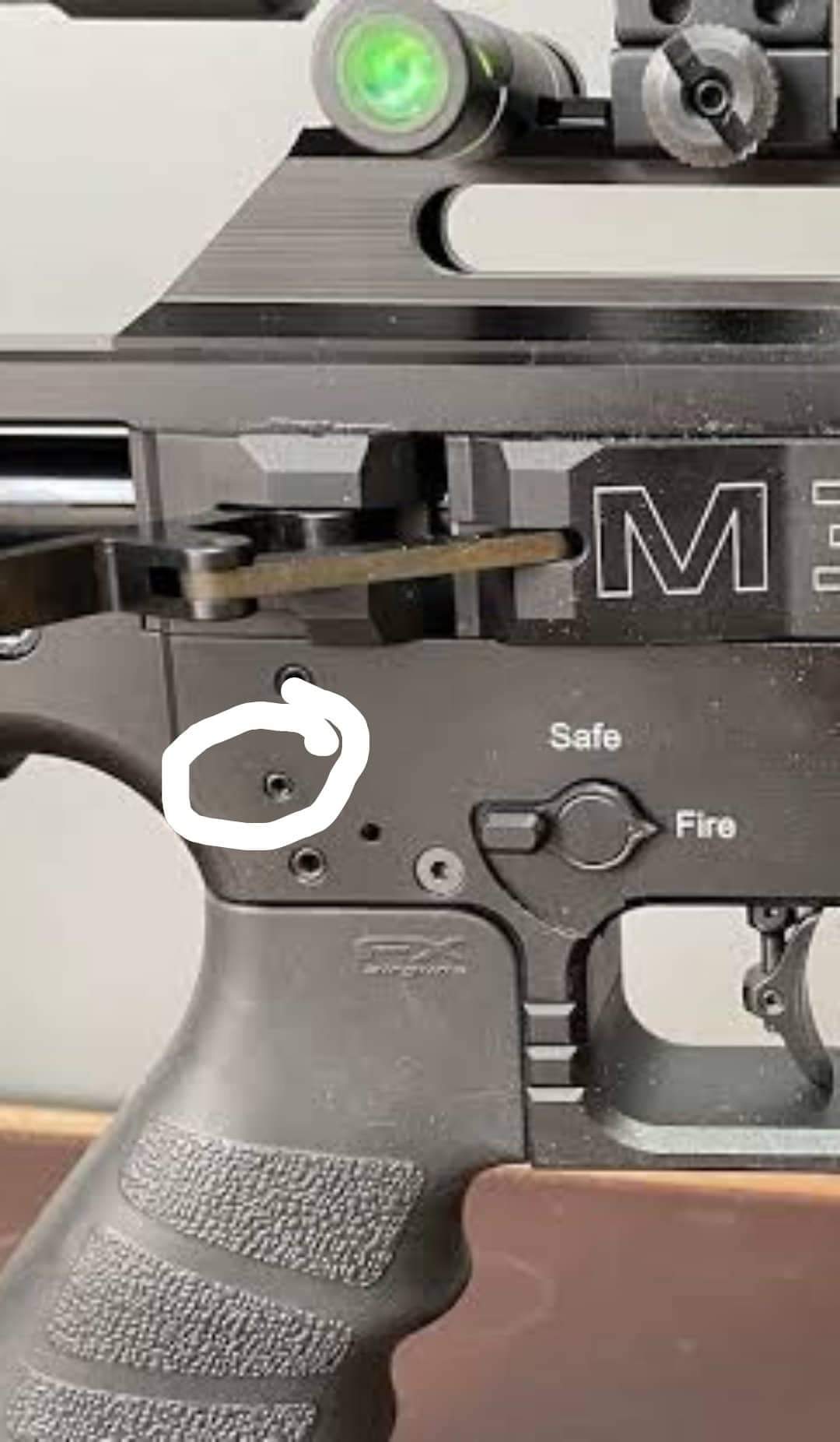

The easiest places to start checking are probably the atmosphere holes for the two regs, the grub screw plugging the supply hole for angled manometer bracket, and the foster fitting (check valve not working). Atmosphere hole on first reg is on the bottle adapter, and for the second reg, its the hole on right side of gun where the angled manometer bracket would go. Grub screw sealing angled manometer bracket supply hole is next to the atmosphere hole. I haven't done it, but you may be able to put some tape over those spots and see if it gets pushed off.
*Note about that grub screw sealing - Factory method I believe is to attempt seal without anything else and if that fails, put a small piece of cut oring in the bottom of the hole and reinstall the grub screw. On my M3 I had something crazy happen where the oring chunk got sucked into passageway downstream of second reg and cause slow plenum refresh.

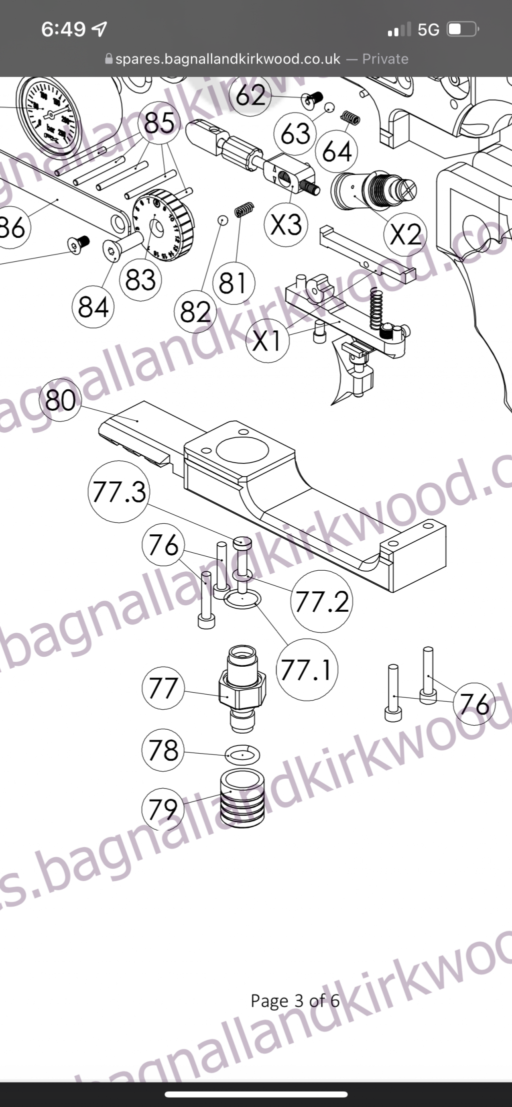

Here are a few places where you may find a leak on your Impact. O-rings are the Achilles Heel of all pcp airguns - so my advise is for you to go the the parts drawing for your rifle - (https://fxairguns.com/wp-content/uploads/2021/04/F10370-Impact-M3-1.pdf) and make a list of all o-ring sizes and order some of each from Oringsandmore. You can call FXUSA and ask them to email you a complete list of the o-ring sizes for your rifle, and if you like you can also purchase an o-ring kit from them with all the sizes for your rifle. This way whenever an o-ring does fail you can fix it yourself. Don't know how to take your rifle apart and put it back together? These videos from Airbuks will teach you how to do that. Good luck finding your leak...

No there is nothing under that screw...there is no place for an o-ring like there is under an air gauge. So if you have an air leak from there you just need to de-gas your gun, coat the threads of that little screw with a generous amount of Blue Medium Strength Loctite, then screw it all the way in until its tight and let it sit over night without any air in the rifle to push out the Loctite, then air up your rifle the next day and check to make sure you cured the leak by applying a drop of soapy water on it...if there are no bubbles you are good to go...if there are bubbles repeat the above steps.

srkhan, I'm guessing you completely overlooked the text above the video links?
"...there is nothing under that screw...there is no place for an o-ring like there is under an air gauge. So if you have an air leak from there you just need to de-gas your gun, coat the threads of that little screw with a generous amount of Blue Medium Strength Loctite, then screw it all the way in until its tight and let it sit over night without any air in the rifle to push out the Loctite, then air up your rifle the next day and check to make sure you cured the leak by applying a drop of soapy water on it...if there are no bubbles you are good to go...if there are bubbles repeat the above steps."
