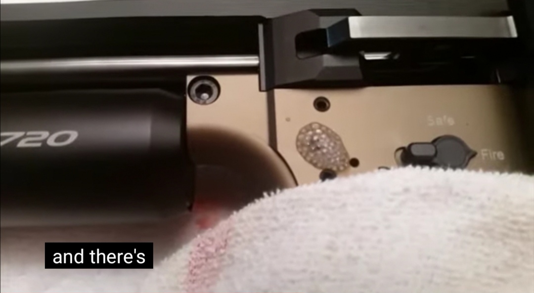

hello all how to fix the leaks of the manometer bracket thanks

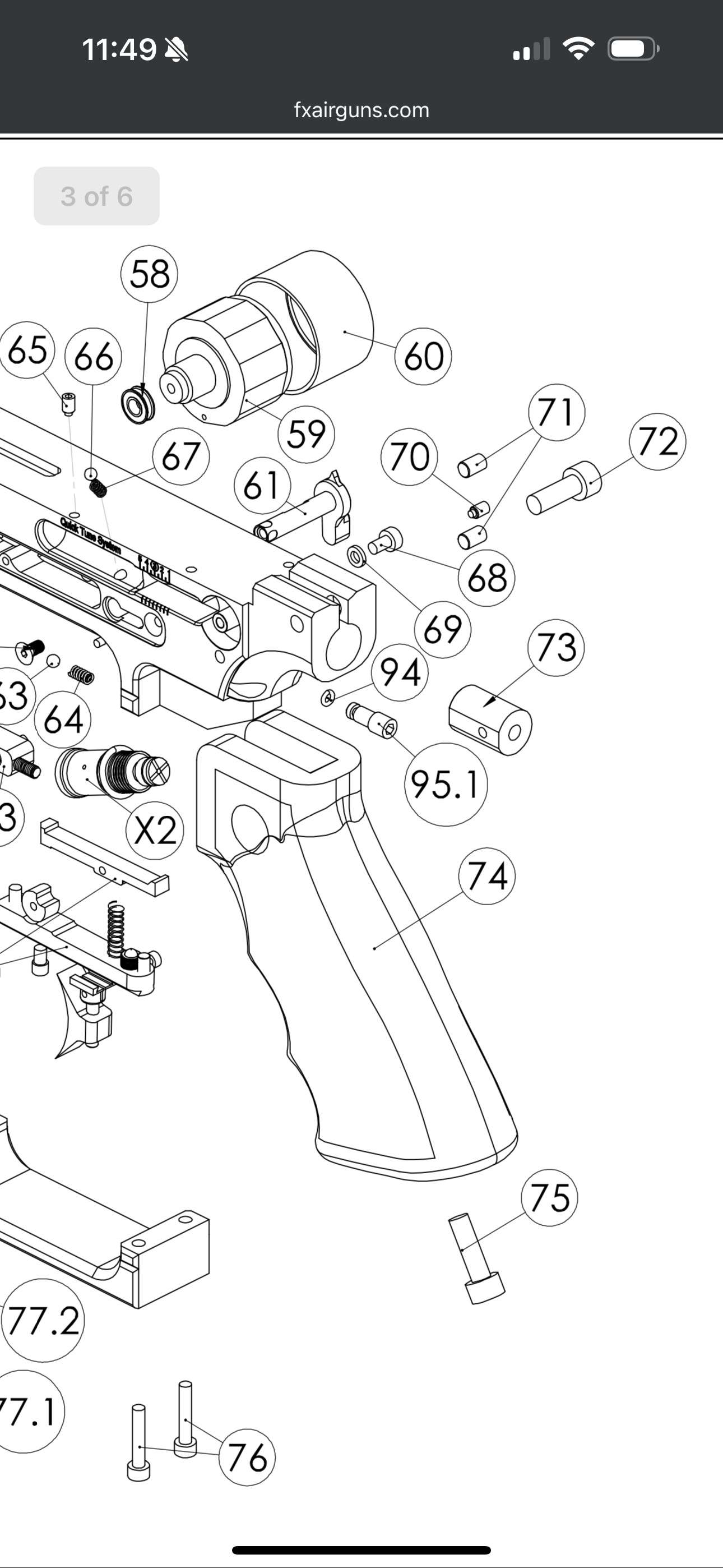

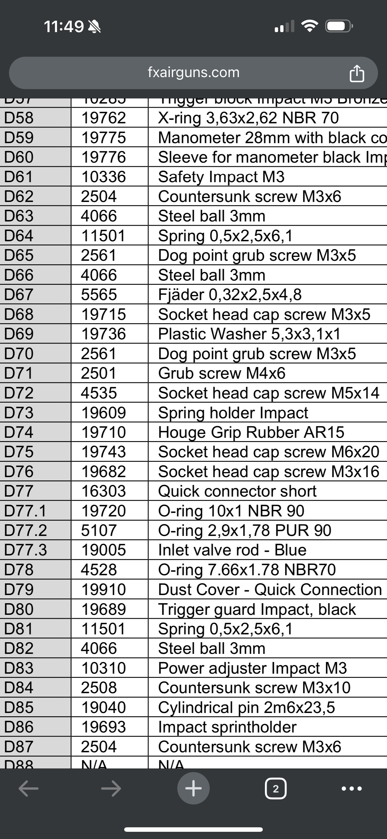

AirGunAction Member Aug 18, 2022 141 151 Mars May 15, 2024 Add bookmark #2 May 15, 2024 Add bookmark #2 Did you remove the manometer bracket cause I cannot see one in your pucture. What I can see is that the grub screw where the manometer bracket fits is leaking. Mine did the same, I degassed the gun, removed the grub screw, cleaned it and the thread in the hole and tightened it a bit more. Leak was gone. If you look at the schematic on the FX Airguns website you will see that those screws do not have any o-ring, etc for sealing. Items D70 and D71. Last edited: May 15, 2024 Reactions: James38 and Impact701 Upvote 0

JaceSpace1369 Member Aug 8, 2021 5,806 8,102 Florida, United States May 15, 2024 Add bookmark #4 May 15, 2024 Add bookmark #4 That looks like the regulator hole, not sure if the m3 and m2 are different but. If tightening the grub screw as suggested doesn't fix ut then you need to replace the o ring on the regulator housing. Reactions: James38 Upvote 0

James38 Member Oct 6, 2020 10 2 Hong Kong, China May 15, 2024 Add bookmark #5 May 15, 2024 Add bookmark #5 Hello all guys the leak is gone i made a POM ball add a grub screw then tighten the grub screw the issue was fixed thanks again Reactions: JaceSpace1369 and AirGunAction Upvote 0
