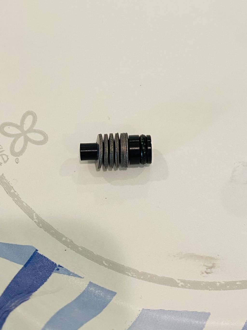

My M3 has the same problem.

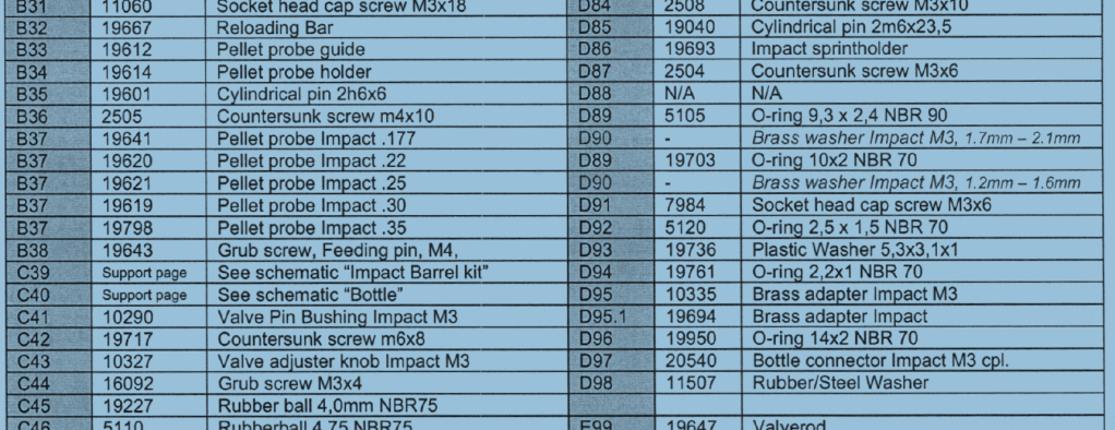

I contacted FX USA and they said culprit is the o-ring on the reg part #19731.
I just received them but have not changed it yet.
I hope this fixes the problem!

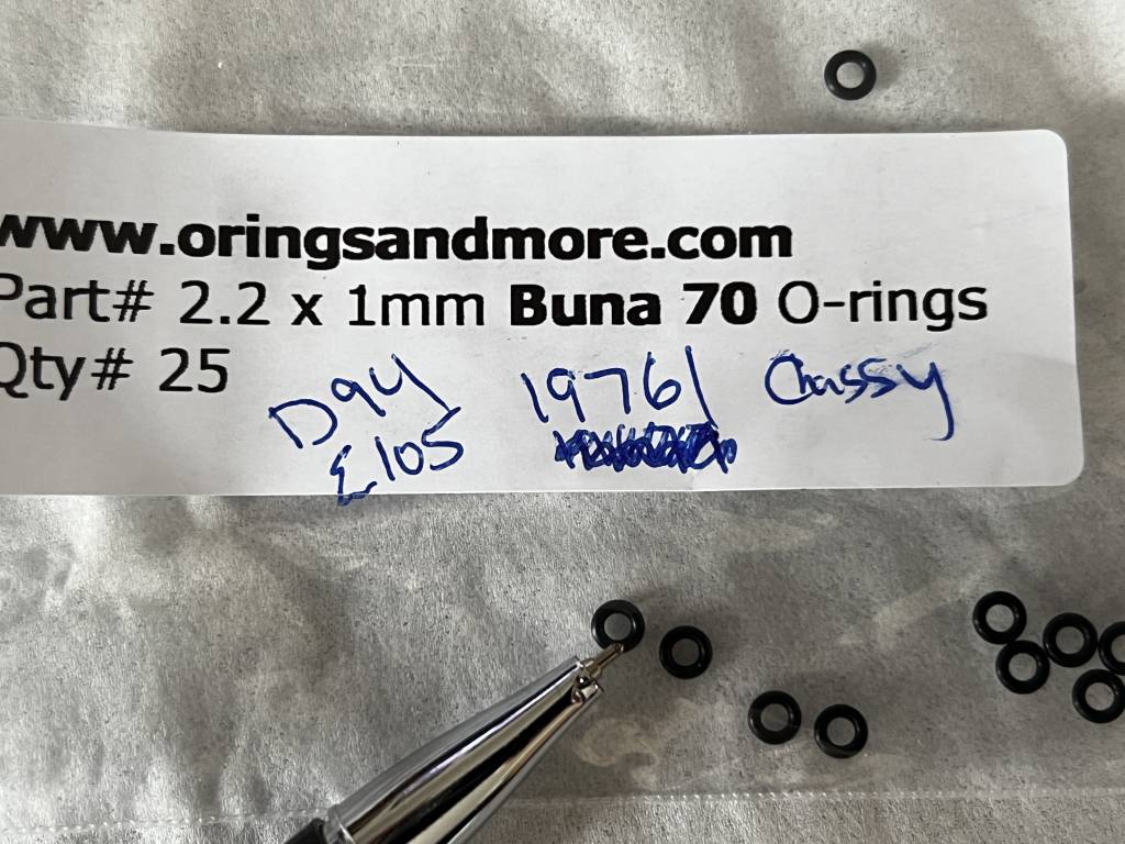

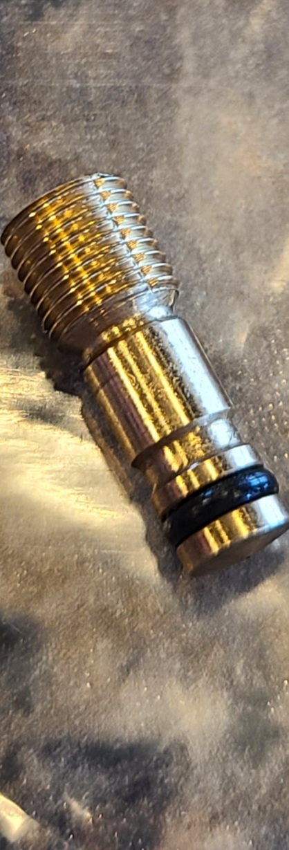

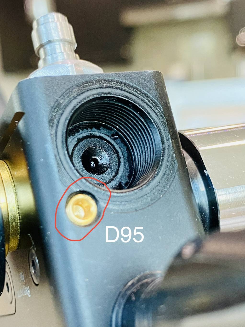

The M3 1st regulator piston is the same one as M3 2nd regulator or MKII regulator, the o-ring size is 4*1.5 NBR70(part #19109). Replace it If you have leak from the small hole on bottle connector.
The M3 1st regulator adjust screw o-ring is 2*1.5 NBR90(part #19731). Replace it if overnight you 1st reg pressure increase/creep to almost same as bottle.
