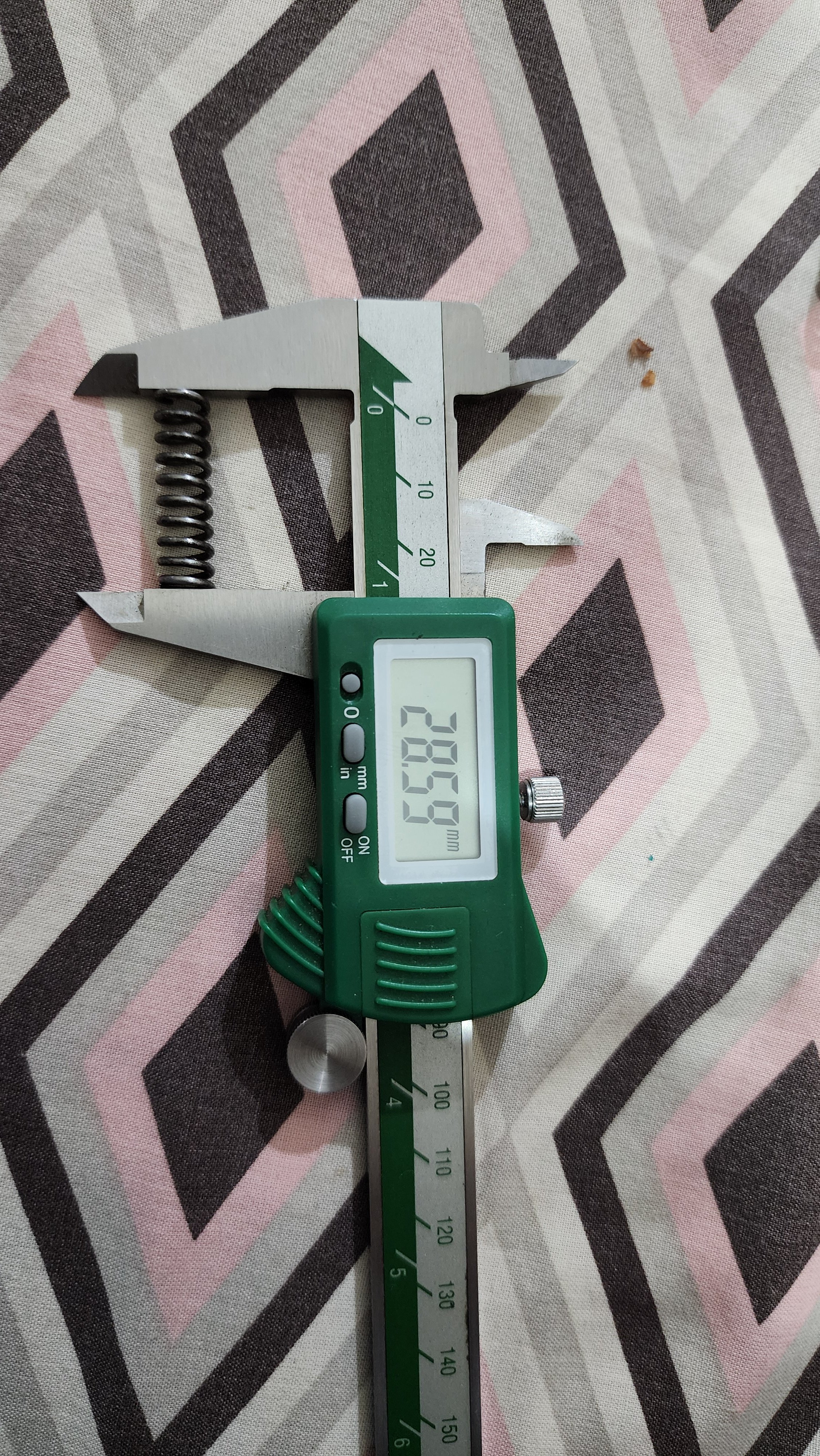

In Impact we can limit the lift of the valve by adjusting the valve adjuster. The valve adjuster doesn't affect MUCH on dewel time.
As per my experiments the reduction of dewel time is often very important for shot cycle, efficiency and consistency.
The standard valve spring is made of wire of around 1mm thickness and is not hard enough to limit the dewel time. However, the lift of valve can be controlled even with the valve springs of thinner wires.
I had very short time as I am not feeling well, I just tried following springs as valve return springs while the regulator was at 125 bars.
Following is OEM spring.
Following are two harder springs.
Shot cycle and efficiency of the gun has been improved.
I couldn't test more.

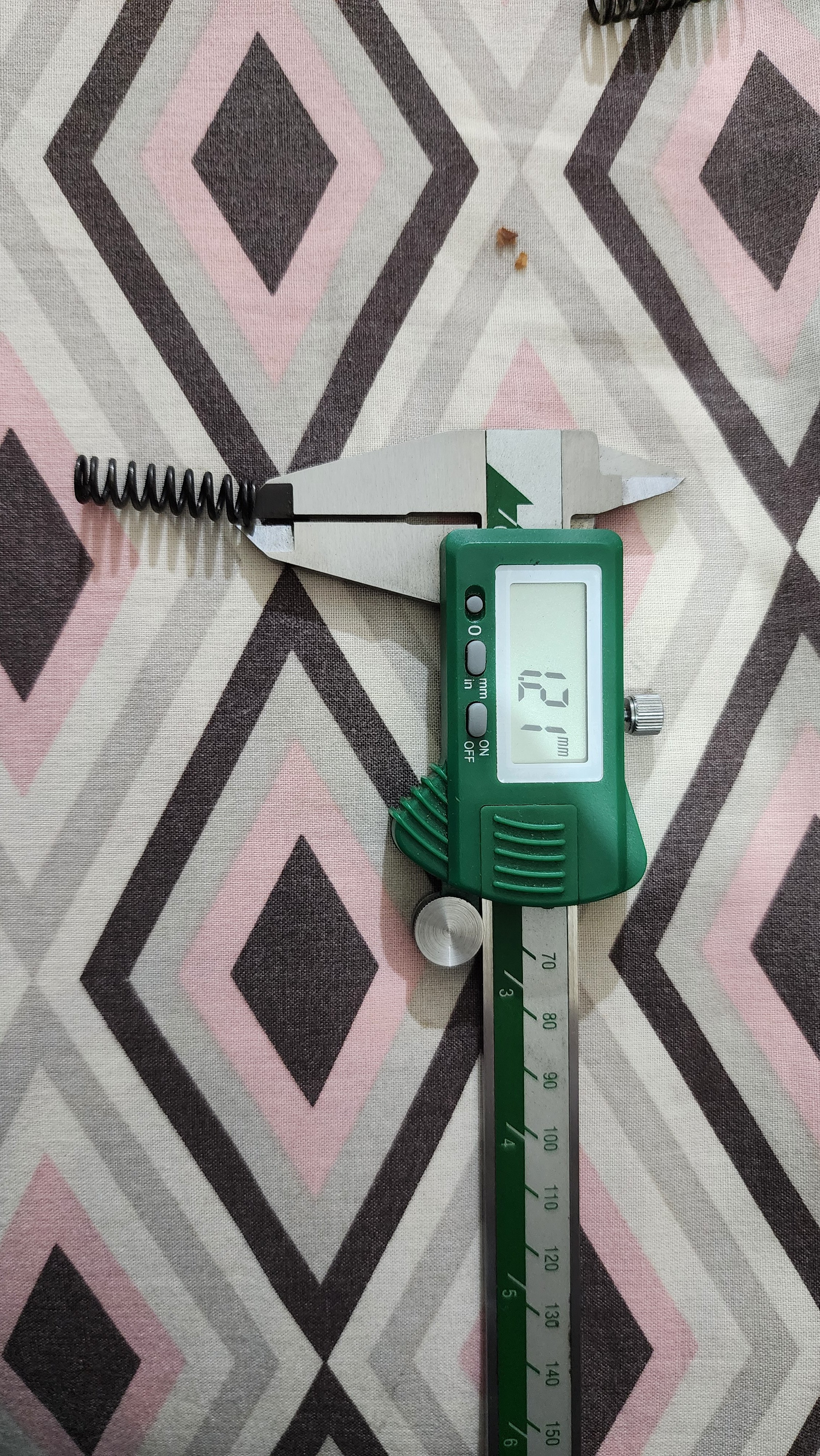

View attachment 515532View attachment 515531

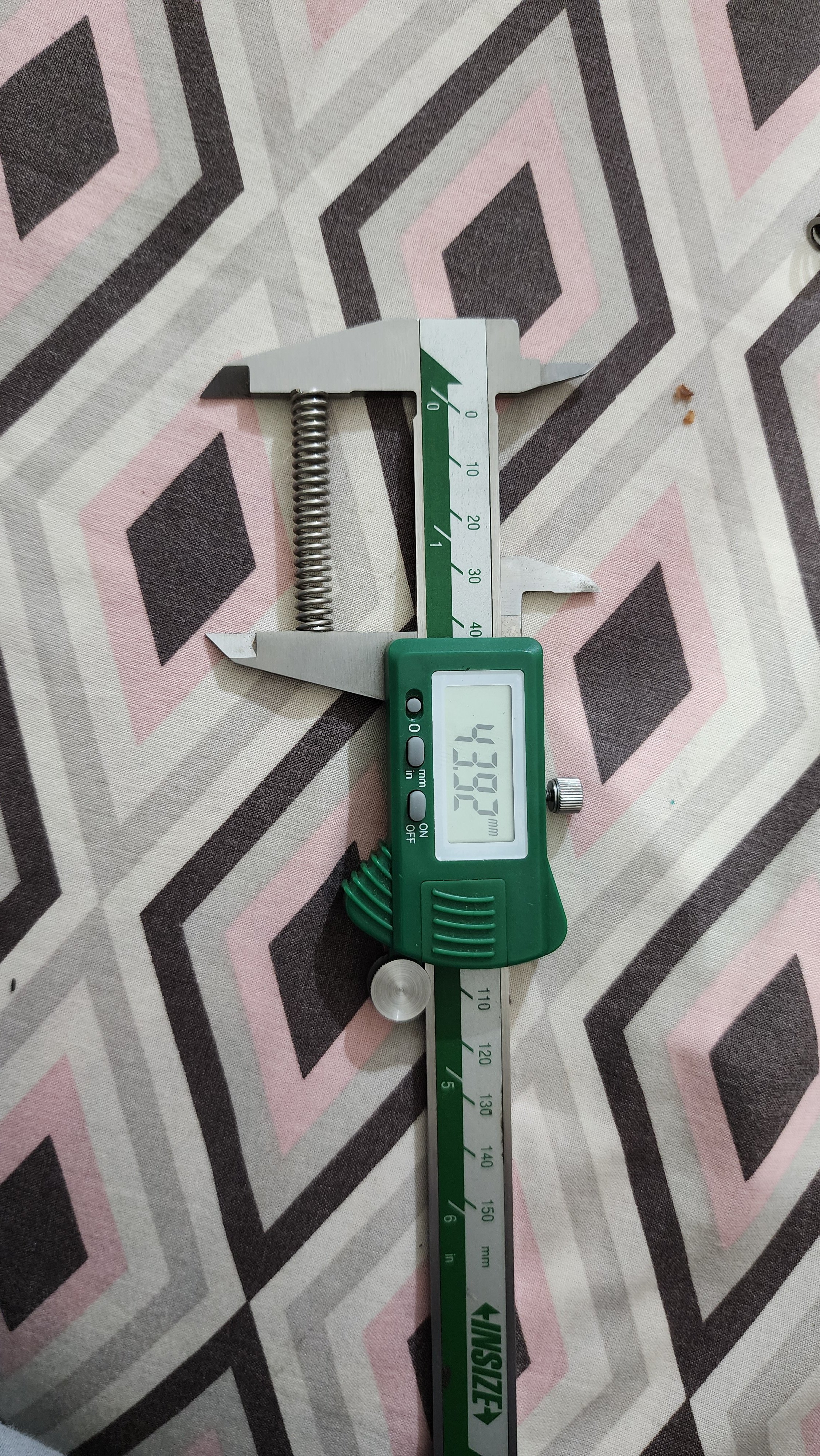

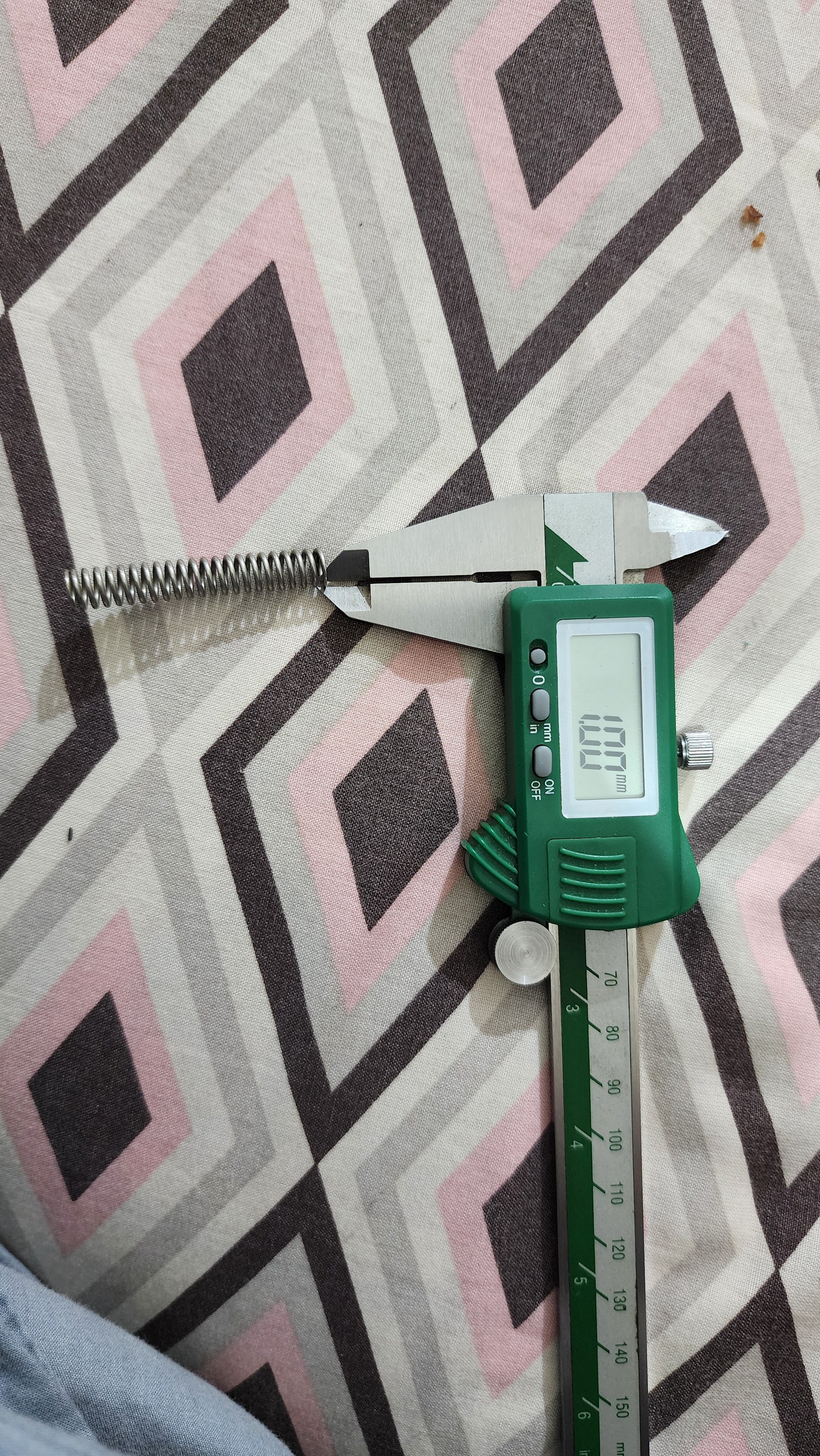

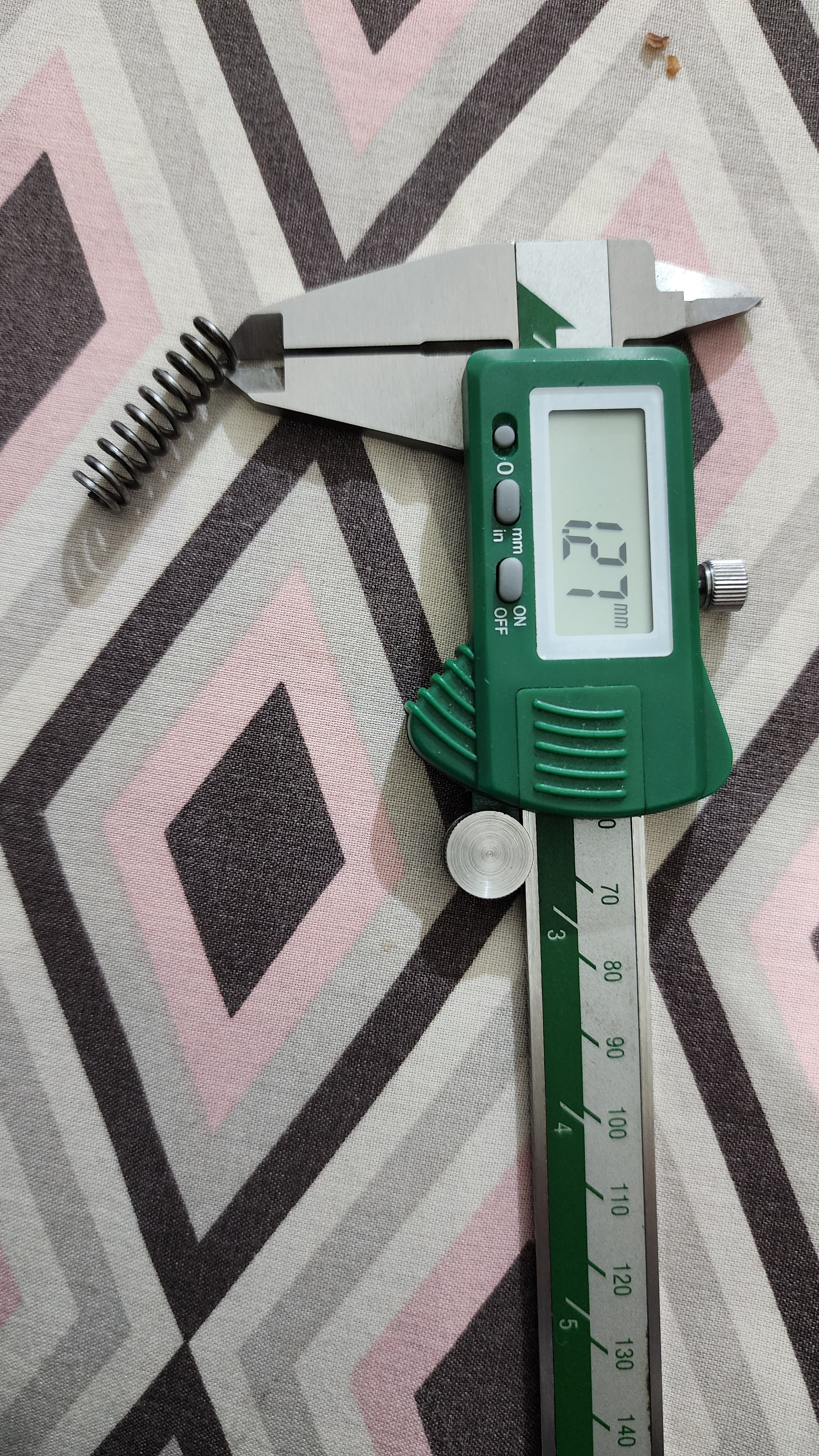

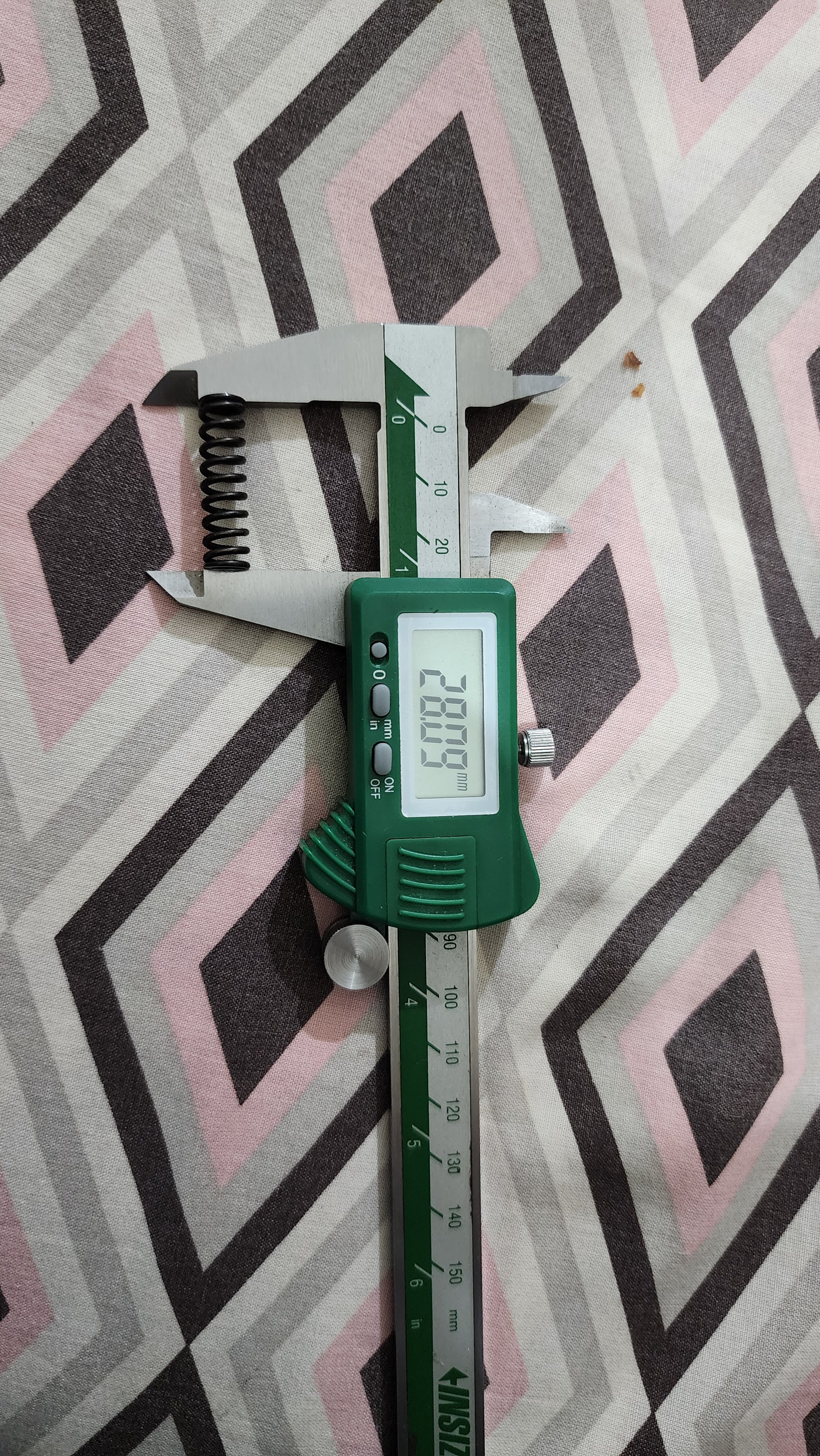

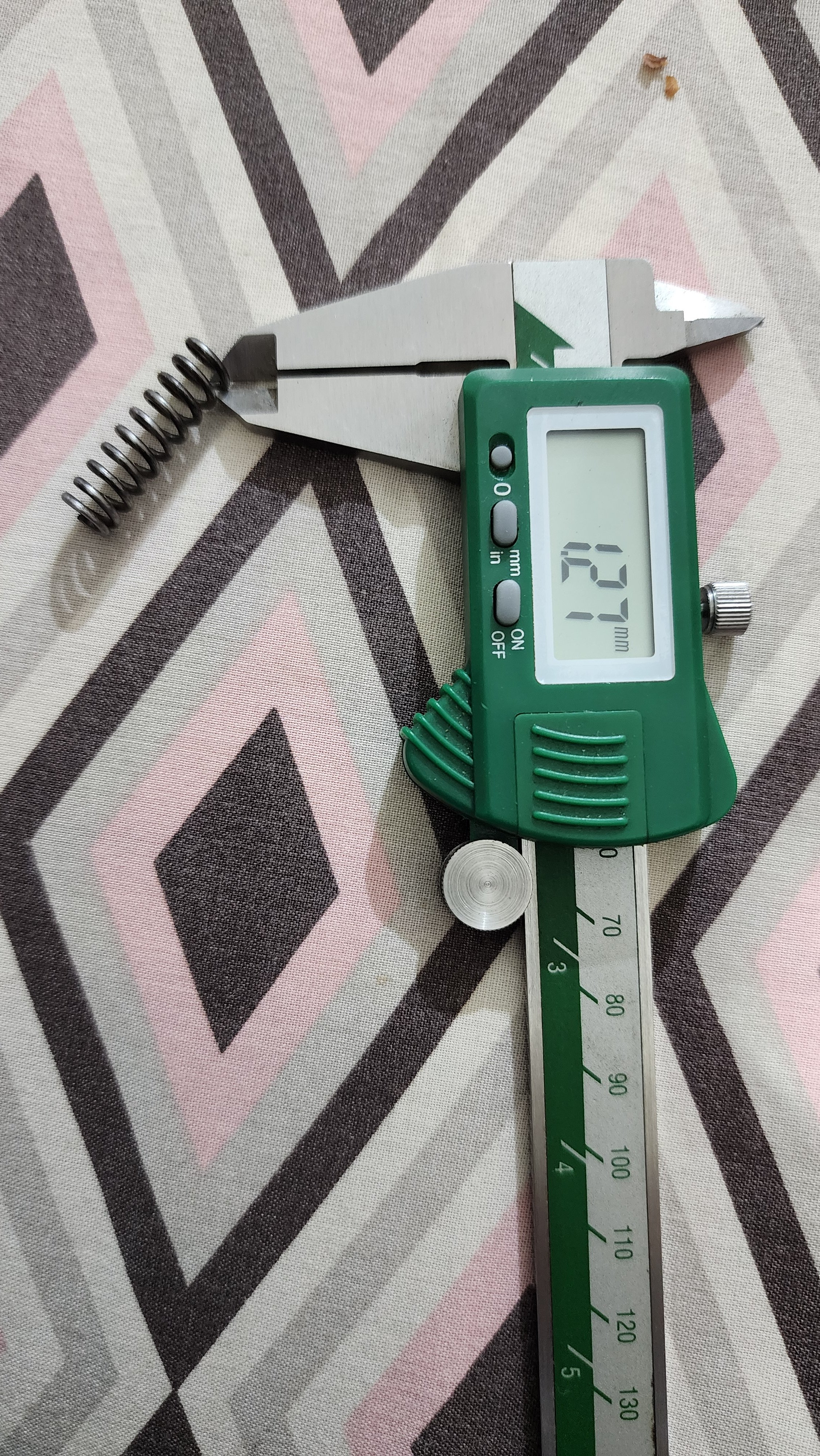

View attachment 515533View attachment 515534View attachment 515537View attachment 515535View attachment 515536

I can't physically measure the dewel time but I understand from my past experience that when a harder valve return spring is applied, valve takes less time to shut down.
The force of hard valve spring is very low as compared to the regulator pressure force but once the valve is opened, the hard valve spring plays it's role in shutting the valve quickly as during dewel time the force of regulated air on valve is greatly decreased.
The sound of the gun tells the story.
