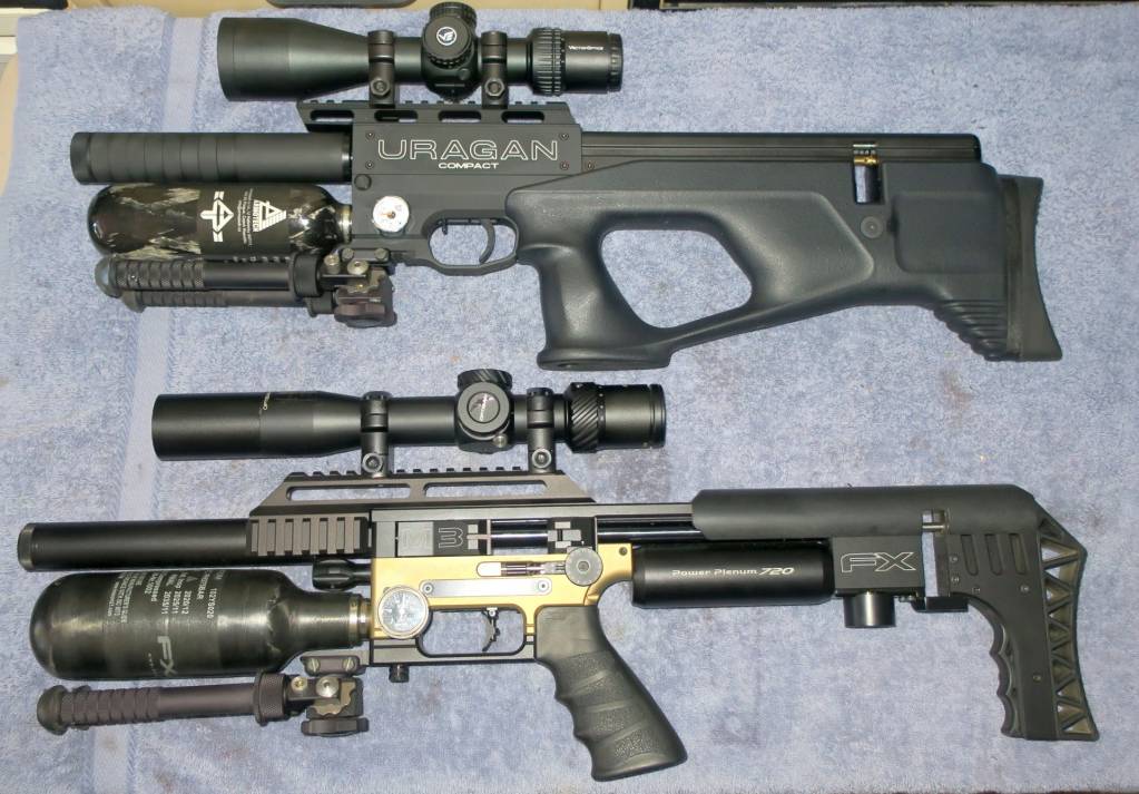

My Impact M3 Compact is my #1 ground squirrel gun. The only close competition so far is my Uragan Compact, which comes in at a very close, but still #2 position. Both are in .22 cal and both are tuned to shoot Hades pellets very accurately.
Lots of talk on the forum about POI shifts with Impacts. Maybe I'm just lucky but both guns mentioned above can sit in a rack or a case for a month at time, then be pulled out and take a squirrel at 45 yards on the very first shot fired. Or maybe the shorter barrel on the M3 Compact model is just more solid, and isn't as susceptible to POI changes as the longer barrels on the std & sniper models?
Both are easily tunable for my needs - maybe change from shooting Hades to 18.13's every once in a while. Both have excellent triggers and repeatable accuracy. And that's target bullseye accuracy and not just hunting accuracy. Both handle very well for walk & stalk. Uragan magazine works better for left handed shooters. Impact wins on extent of easy tunable parameters. But don't let excessive tunability concern you. Once you get it shooting where you want you don't have to touch it. And later you may come to appreciate more tunability. Both have excellent shot counts per fill - really more than you will ever need unless it is a really long shooting session. I don't feel the need for a moderator to reduce sound any further on either of them, and like the fact that they therefore can stay short in the hands.
