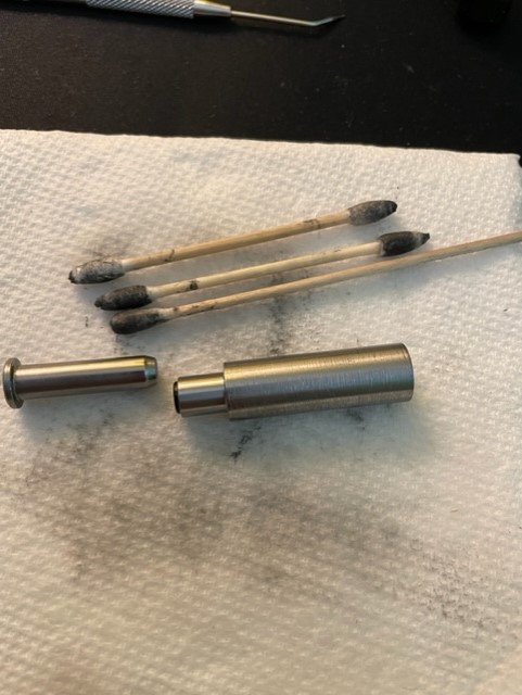

Yep, signs of Impact Syndrome. Owners claim it’s shooting great but are compelled by what they hear or see to tear it down. The only way to build up immunity to this virus is to be bitten enough times and survive. Others have severe reactions and usually sell the platform never to return. Here’s what I do. If I have some ideas or things I’d like to do inside the gun but mine is performing just fine, I wait until there is an issue that forces me to tear into the gun. Then I move forward with the list. The gun will need tuned again anyway. If my gun goes a very long time without an issue, I’m thankful and fight temptation. Good luck. Oh, and polishing everything is not a game changer and you don’t want to get too crazy trying to chrome plate the valve rod back by the PUR oring. Lube needs a little porous surface to adhere to.

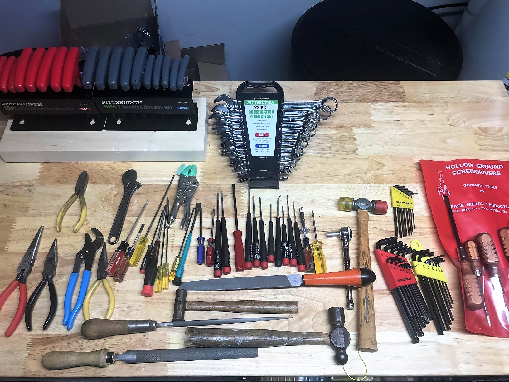

Gotta get out my FX tuning kit.
I would send to FX. If an m3 it should still be under warranty. These little regs seem an utter nightmare to reseal from what I’ve read and actually get them to completely seal.

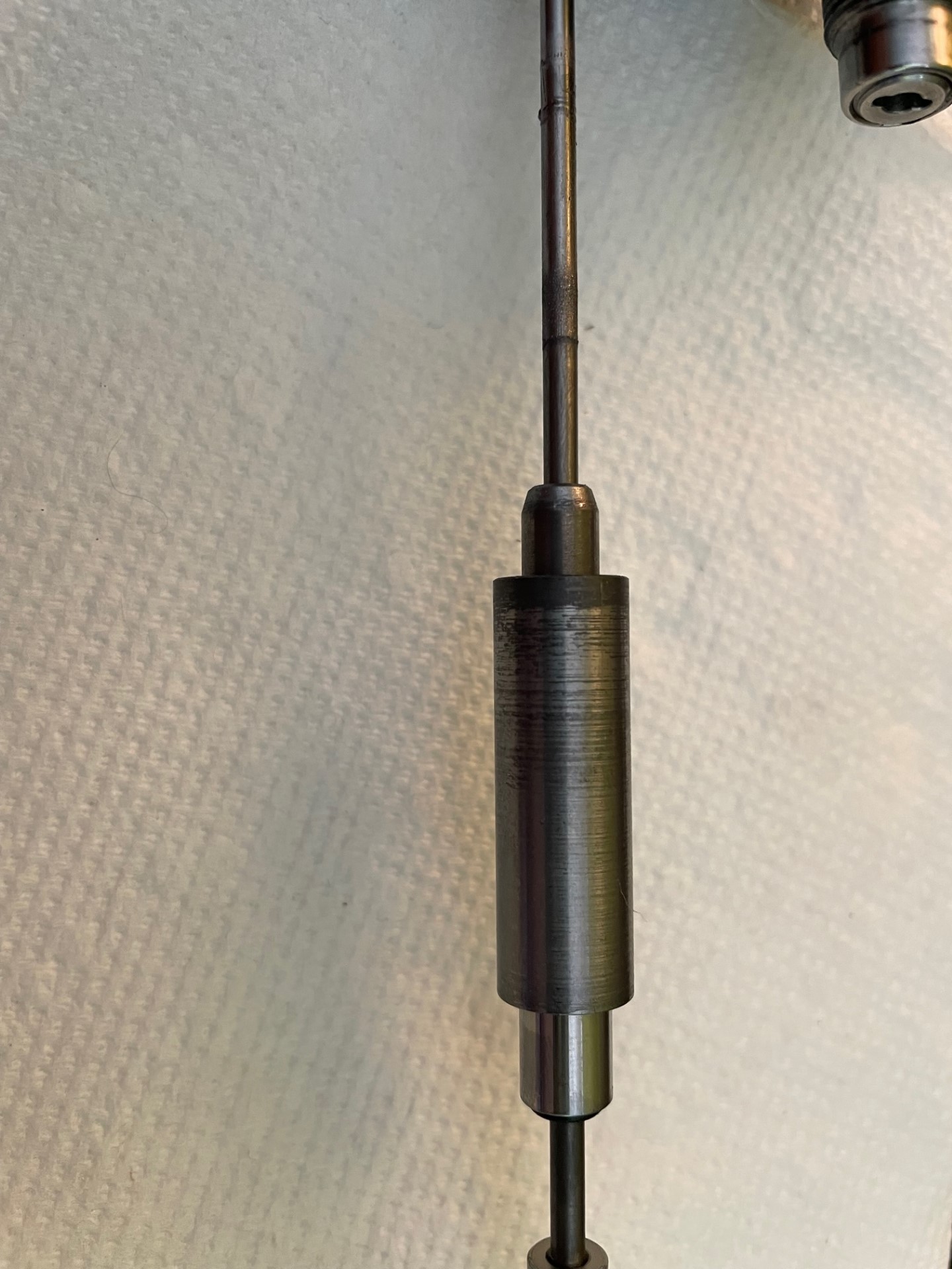

#1 Let's see, you'll get to replace the hammer, will be badly scored, the block because it'll break, photo available upon request, NO I didn't do it a previous owner did. Then you get to pay FX for the parts
