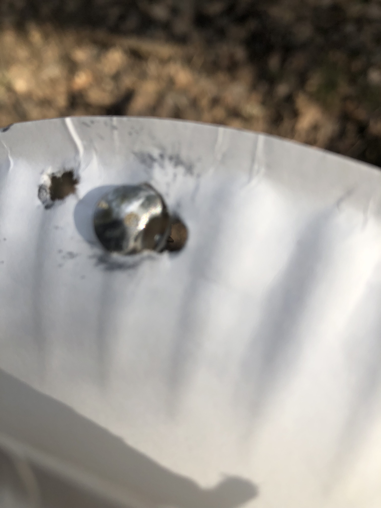

115 yrds
Reactions: RM.510bigbore
Very nice! I commend you on your results and marksmanship, but I don’t think it substantiates the claim that fire lapping is superior. It does have some advantages and disadvantages relative to other methods, and every situation is different in terms of the barrel’s initial state, the user’s tools and skills, time and effort invested, risks, etc.
