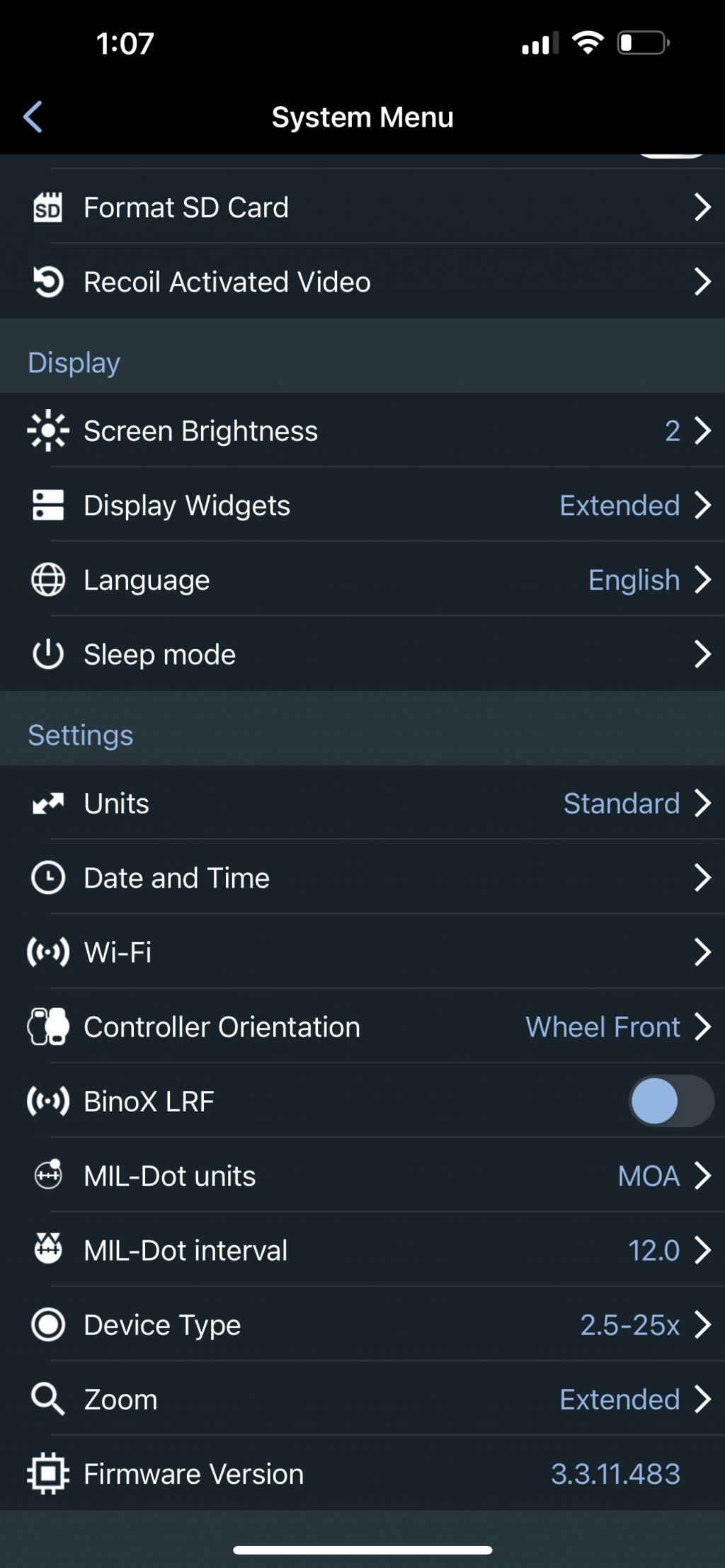

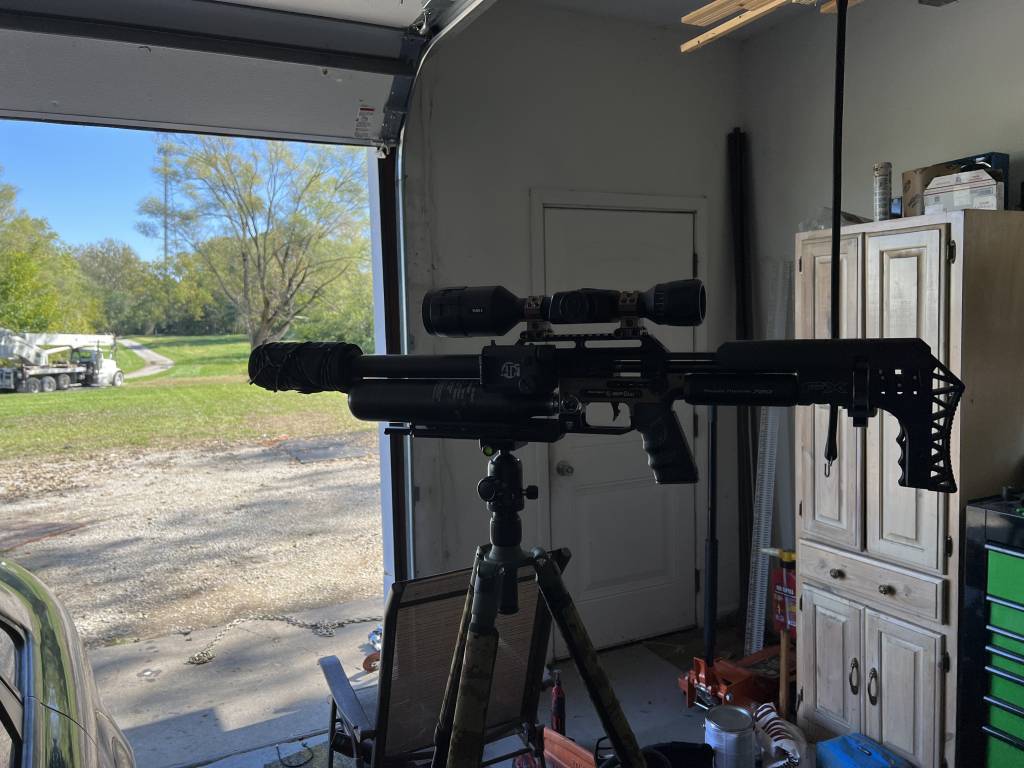

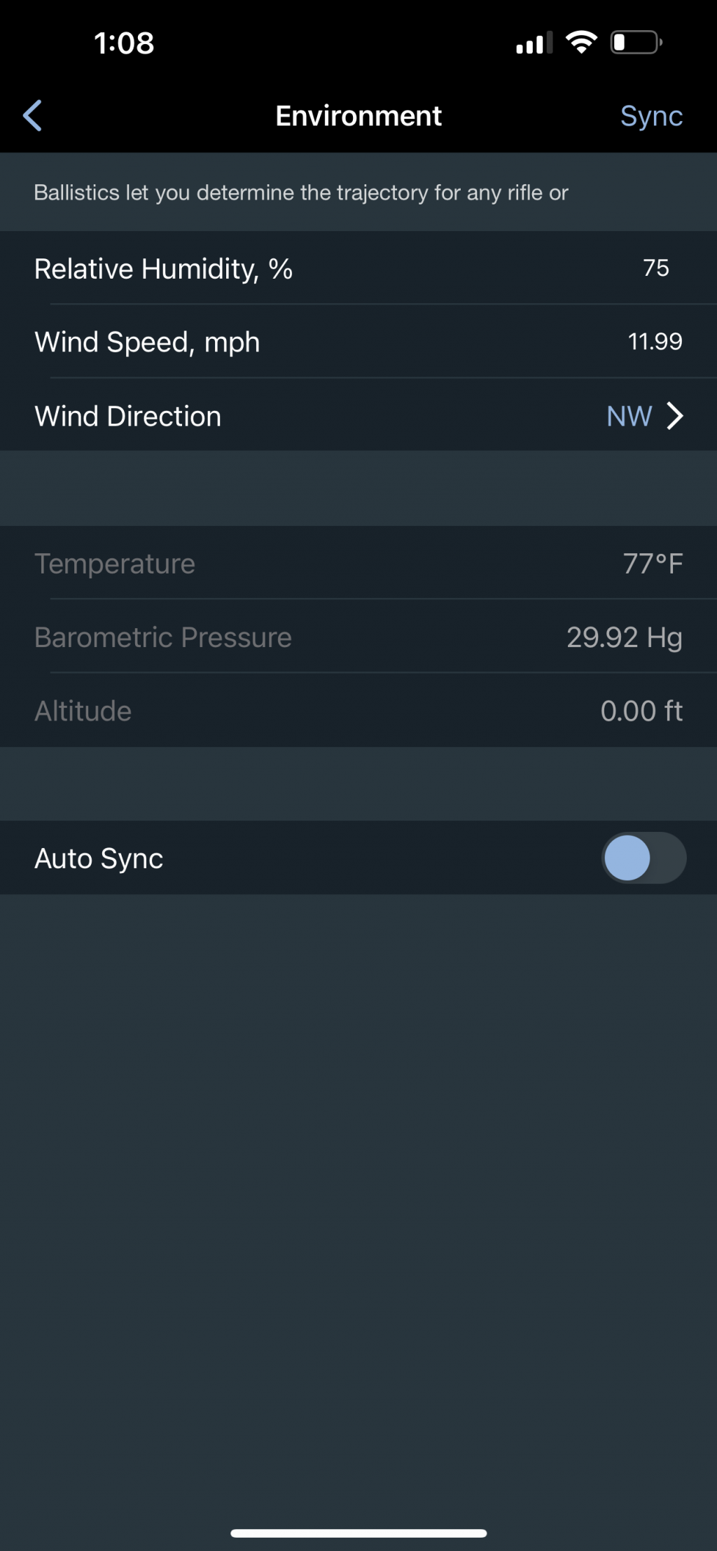

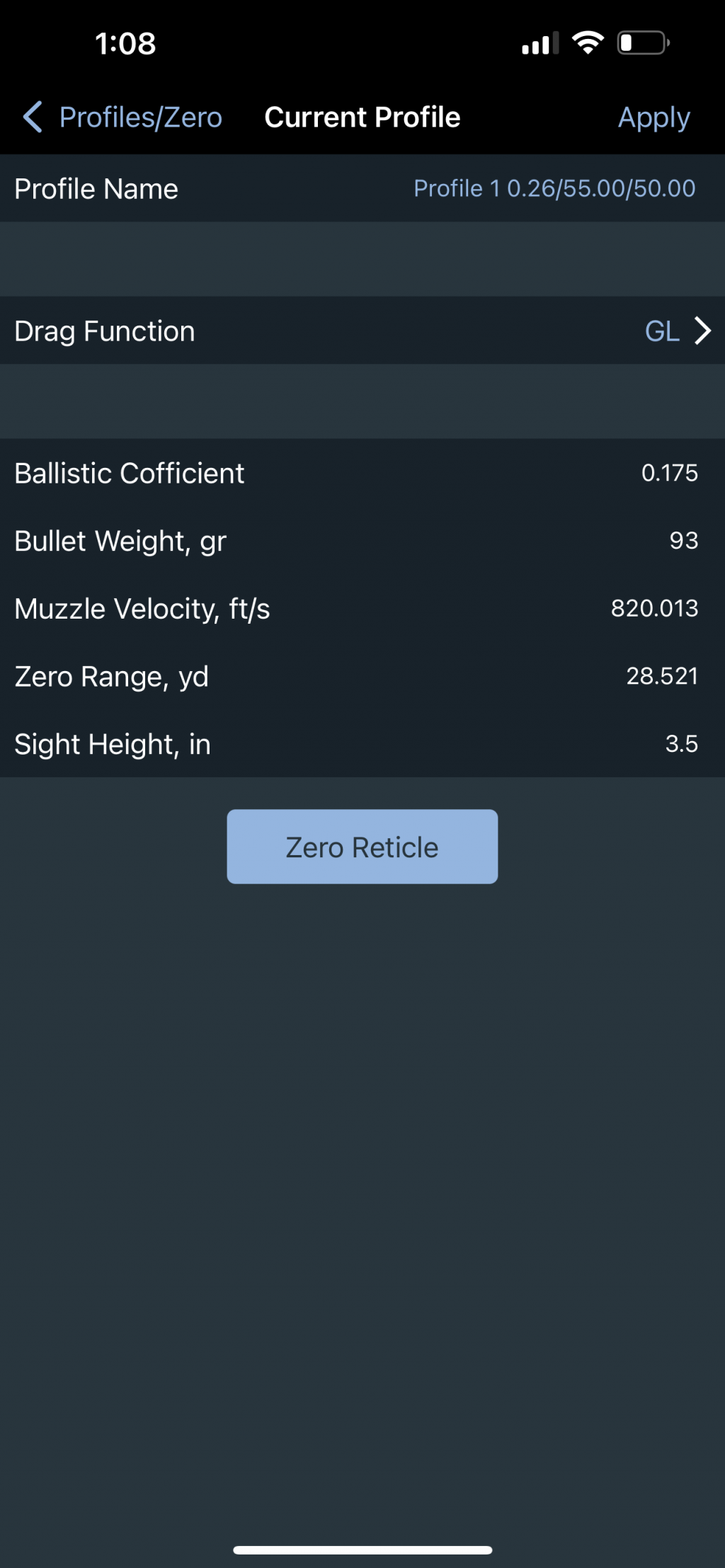

7green I had an mk2 shooting .93s at 970-980fps before it broke and I threw it in a box robbed parts etc. my m3 is shooting .93 nielsens at 820fps consistently with only the Nielsen probe I modified the probe as it had some flaws…now I say 820 consistently on my m3 that is with my barrel cut about 6-7” short! Where did you get the tungsten weights and what sizes did you use I may order some swap them in with a spring from the slug power kit they sell and see where I land @7Green if you have a Facebook look me up Tyler Lott Indiana it may be easier to chat on messenger sometime and then post our data here!
Nielsen .93s
823fps
125 yard gong 4”
55 yard gong 4”
12mph wind from north west
shooting east
Thor 4 640 thermal
1:00pm daylight
hand warmer taped to backside of gong at 125 yards

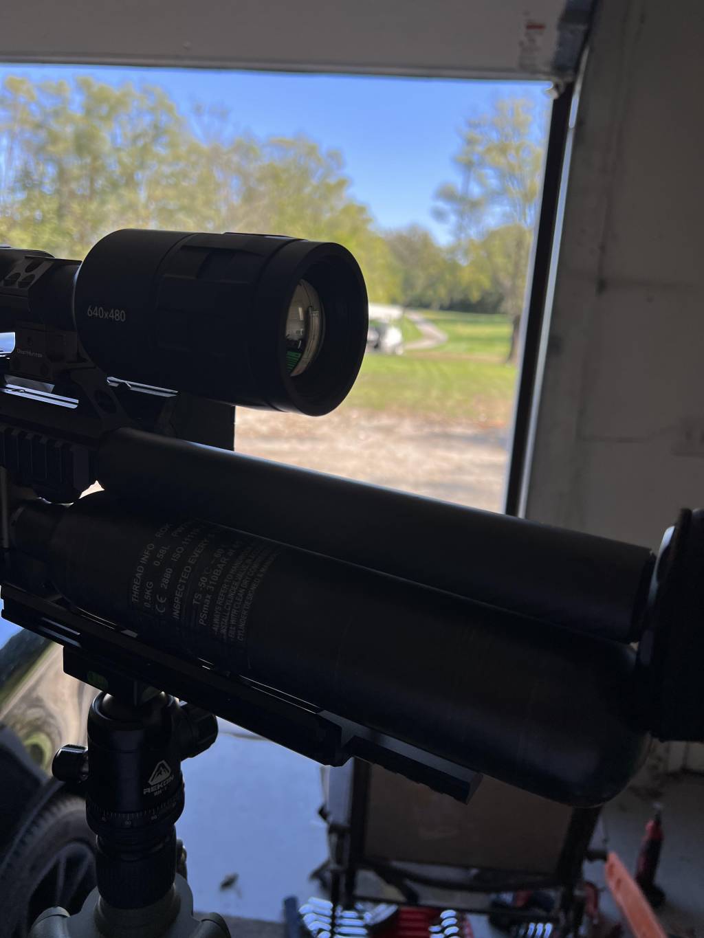

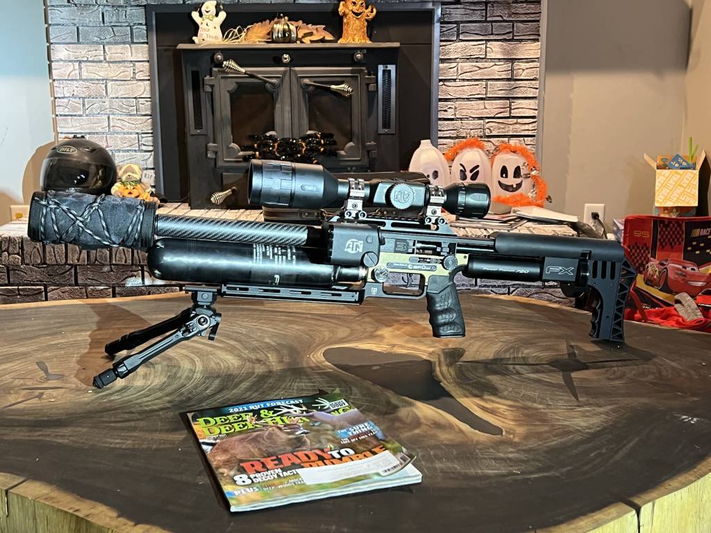

I cut down the factory barrel by approximately 7” my Donny fl ronin barely fully threads tight with mm to spare before hitting the end of the bottle as you can see.

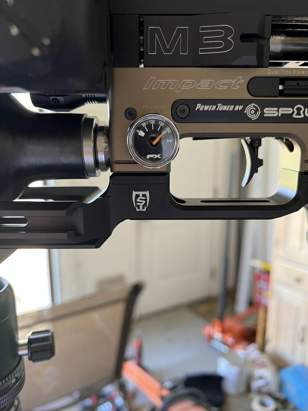

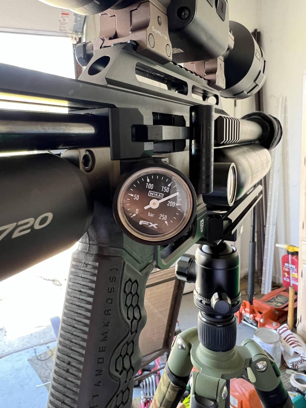

I swapped in a human reg 2 I couldn’t get the huma extra high pressure reg to work tonight so I swapped the disks to high pressure (12 discs) and set about 175 bar I have upgraded hammer spring 1 spacer and brass hammer weight I also added delrin c3 spacer I am consistently getting 850-858fps with Nielsen .93s and accuracy has improved.
my question is what good is the first reg what’s its purpose? I may just remove it all together I’ve noticed the reg 2 tends to take a few seconds to fully reset and reach bar after each shot…this led me to the question is the 1st reg slowing down the 2nd? My first reg is set over 200 bar?
Can you post the hammer spring specs you installed and where you located it?
I have my 2nd reg at 157 bar, but the factory spring doesn't have enough umph to open it at higher pressure. I want to open it around 190 bar.
The main issue I see with removing the 1st reg, is you would have potentially 300 bar at the 2nd reg, should it ever fail. The max output I believe was 200 bar on the Huma reg. It would be worth checking with FX or Huma, as to what it can handle on the input side, not too mention the rest of the guns specs. For instance, can the power plenum handle 300 bar if the reg failed?
