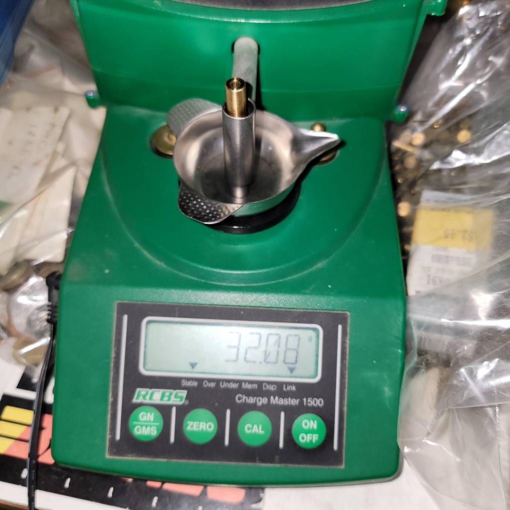

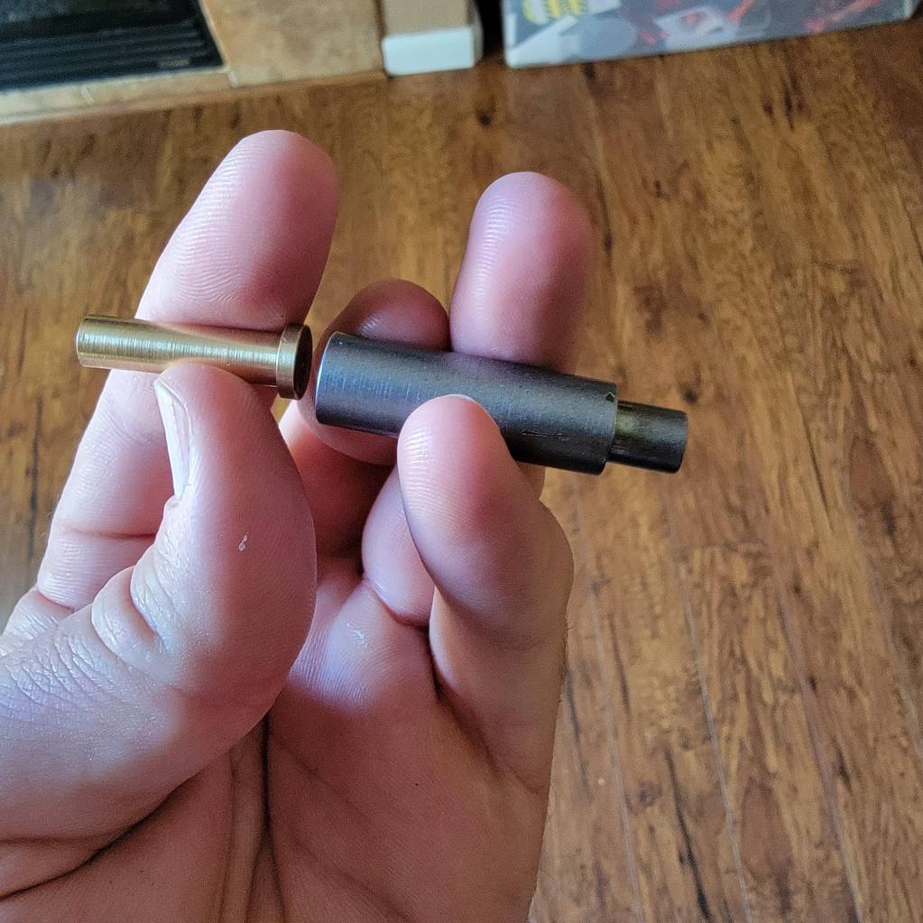

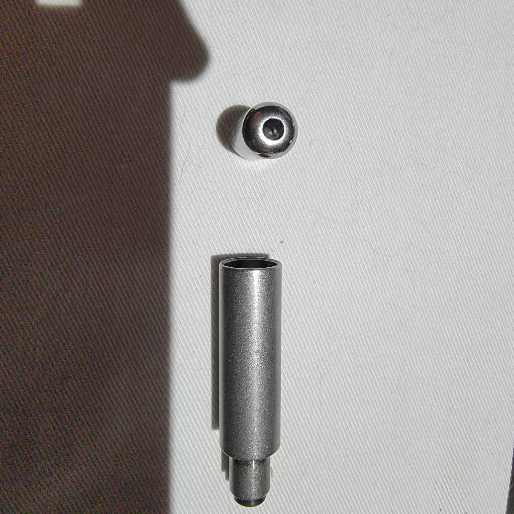

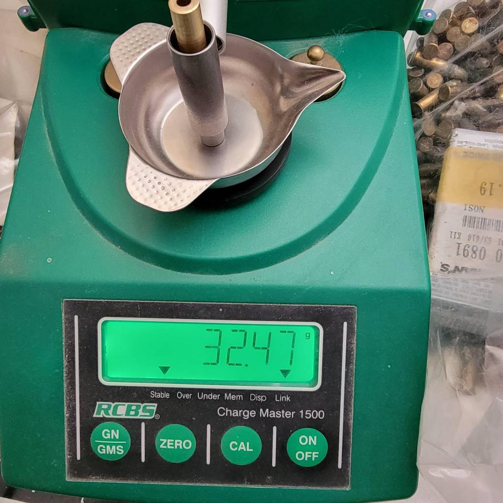

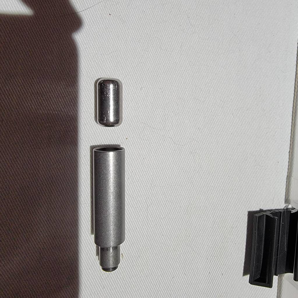

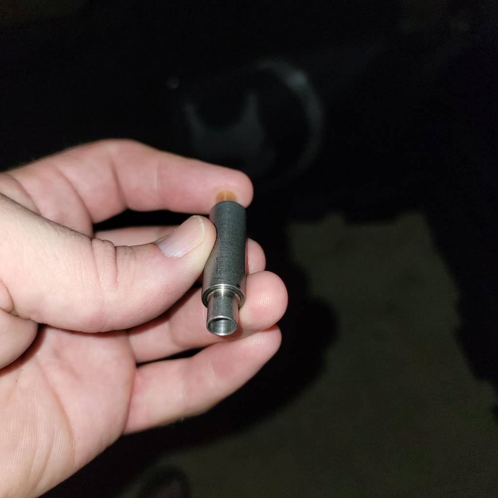

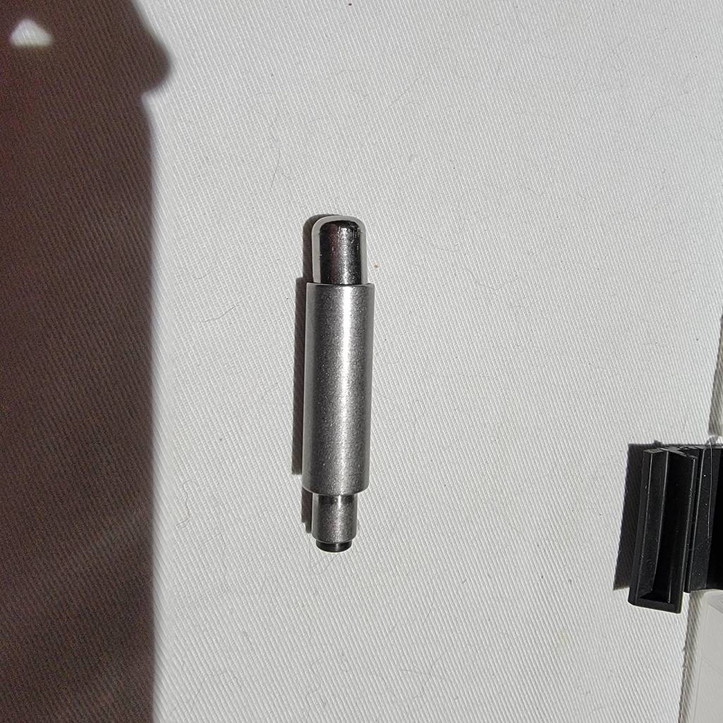

The 3/4 oz Tungsten barrel weight itself weighs 19.17 grams after being drilled out. I drilled out a 1/2 oz barrel weight too and it weighs 12.11 grams. The hammer drilled out weighs 12.3 grams. My goal is the 33 to 35 gram range with full adjustability of the Micro dial. Using my Micrometer, I think I may have to use a combination of the 1/2 oz Tungsten weight and a brass hammer to get near there. Trial and error lol.
If I were to order a hammer from FX that doesn't have the delrin insert, one could make one around 33.5 to 34 grains. You could hit close to 35 grains if the washers are used too.

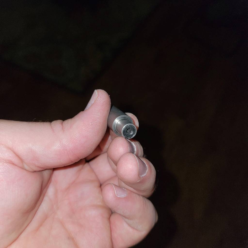

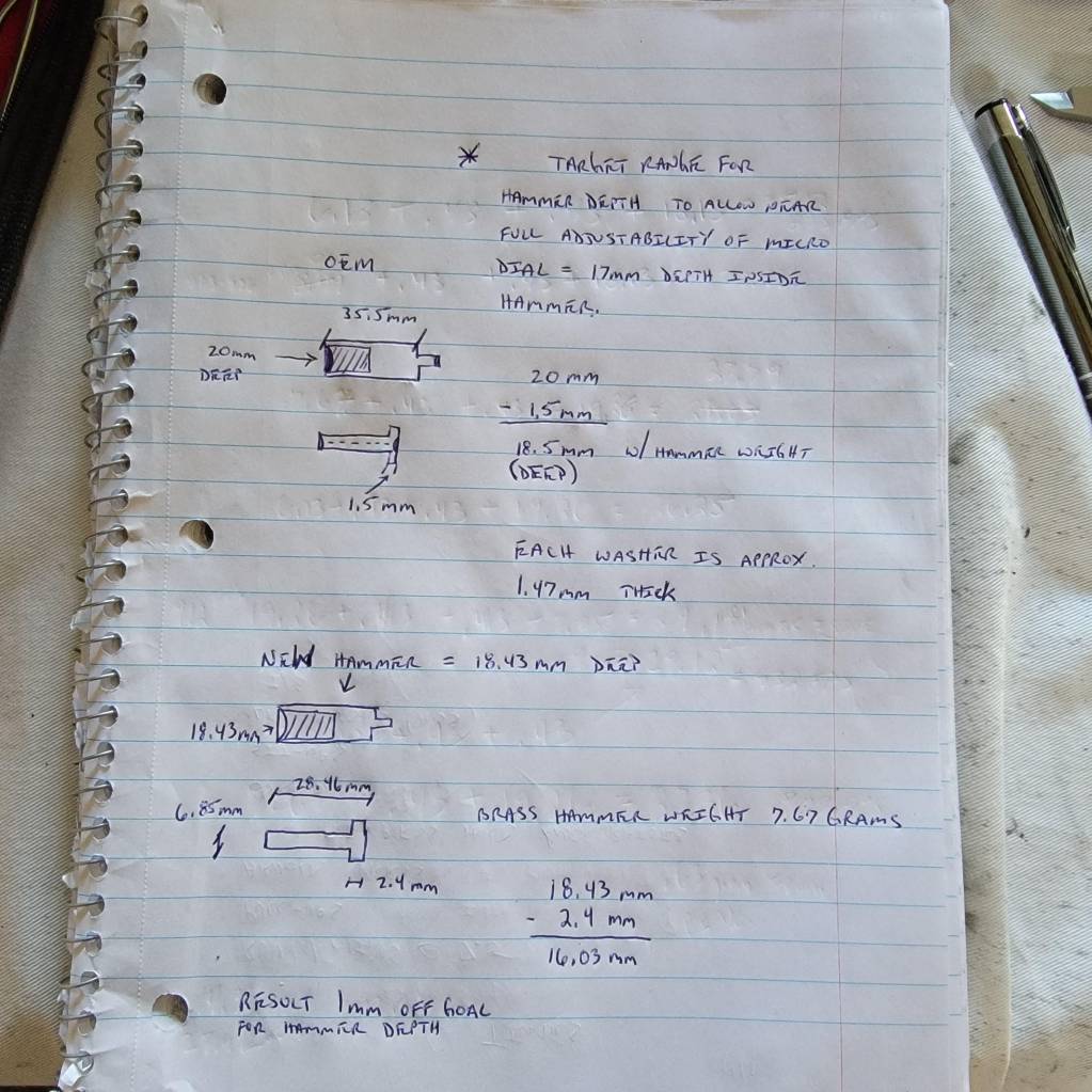

Just so everyone knows, I drilled out the hammer first with a 1/4" drill bit until there was approx. 2mm left of material. I then used a 3/8" drill bit until I got to where I stopped with the 1/4" bit, leaving around 2mm of material left still. My micrometer was used to measure this.
The original void in the hammer was approx. 20mm deep. The length of material on the wide section was around 35.5mm long. My goal was around 17mm of depth left in the hammer since the oem hammer weight and 1 of the washers would put you near max on the micro dial. I ended up 1mm off my target depth. See drawing below.

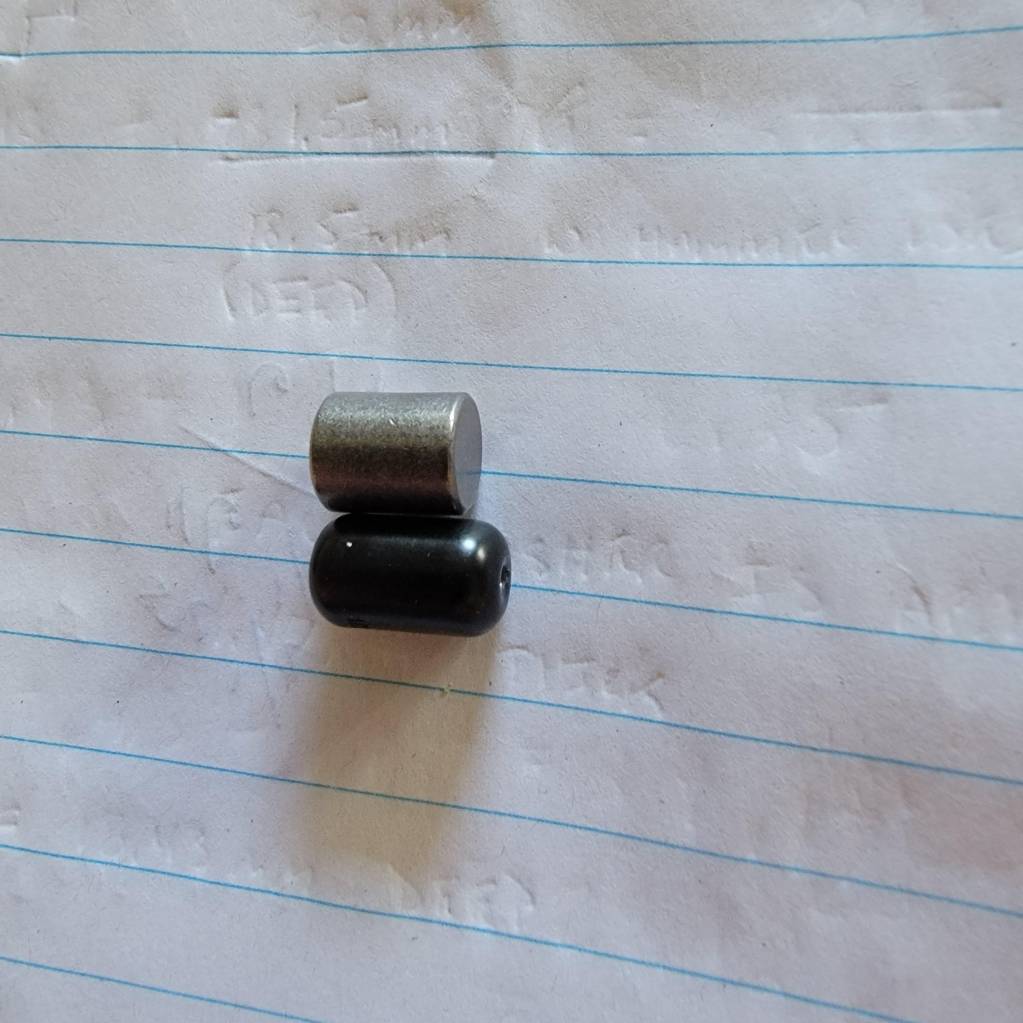

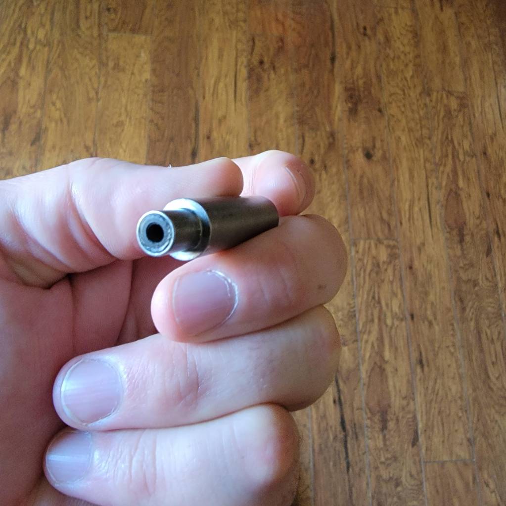

I also think if I could get a hole in one of the original Tungsten weights I ordered it would be better. Tighter fit and shorter length, saving more of the original hammer material. This would also save some additional weight. Below is a photo for the comparison. Top is 11.27mm long and bottom is 14.88mm long. 9.49mm wide is the top and 8.86mm wide is the bottom. Both weigh approx. 1/2 oz.

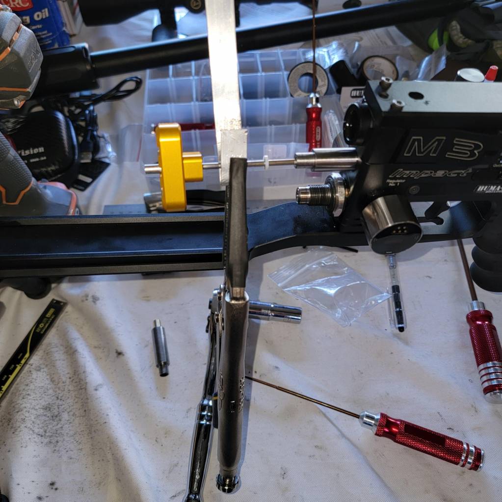

Yep. I just have to figure out when I want to take her apart again lol.

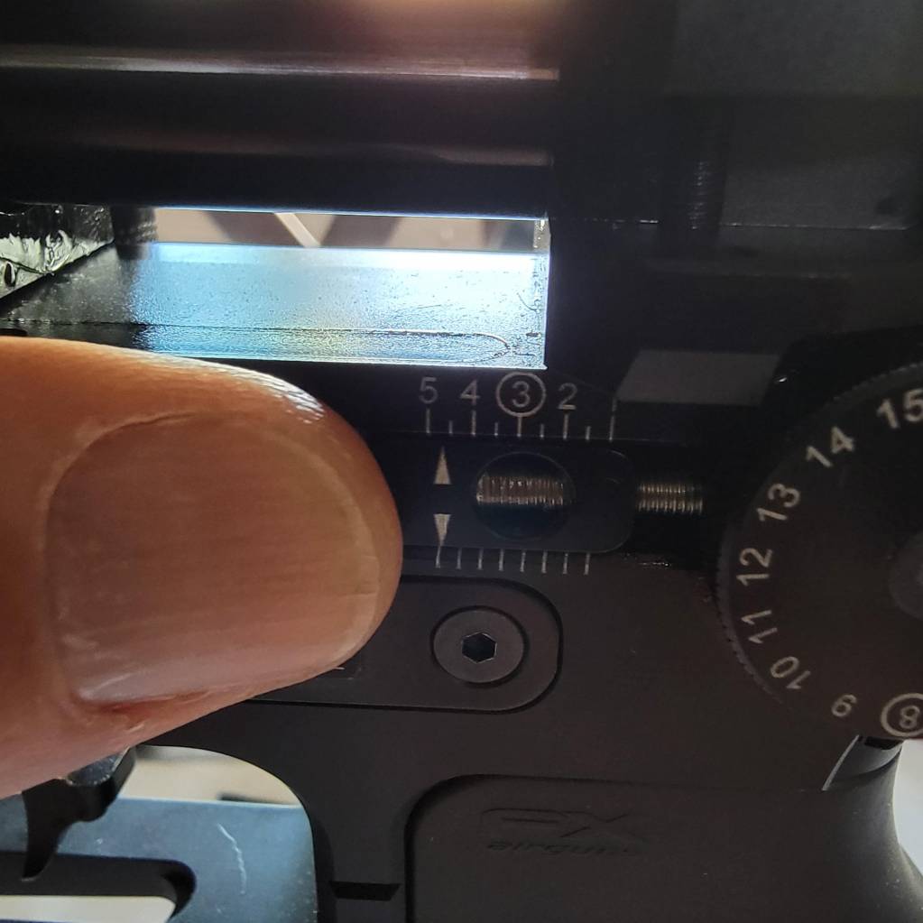

On a side note, with the original factory hammer, hammer weight, and 2 washers installed; the max micro adjustment range was around 4.6 on the dial. With one washer removed, it would be near the 5 mark on the dial. This was how I came up with my target depth range.
Personally I don't think there should be numbers 1-5 on the gun because depending on what internals are installed, it will dictate how much adjustment you have on the micro dial. All of it is dictated by full compression of the hammer spring.
My thought is to get full adjustability of the dial for a better range of velocity adjustments. Plus, I would prefer to get the max velocity out of the gun while on the max Macro and Micro settings. A true 1-16 Macro and 1-5 Micro would be perfect.
Lastly, I don't know at what weight the hammer assembly achieves its max energy. 29.12 grams opened up the valve at 165 bar with velocities in the 930 fps range (81 JSB's) and near the 860 fps range (93 NSA'S). My Huma reg is rated at 200 bar. If I could open it at say 185 to 190 bar, will I see a velocity increase? Only testing will answer the question.
