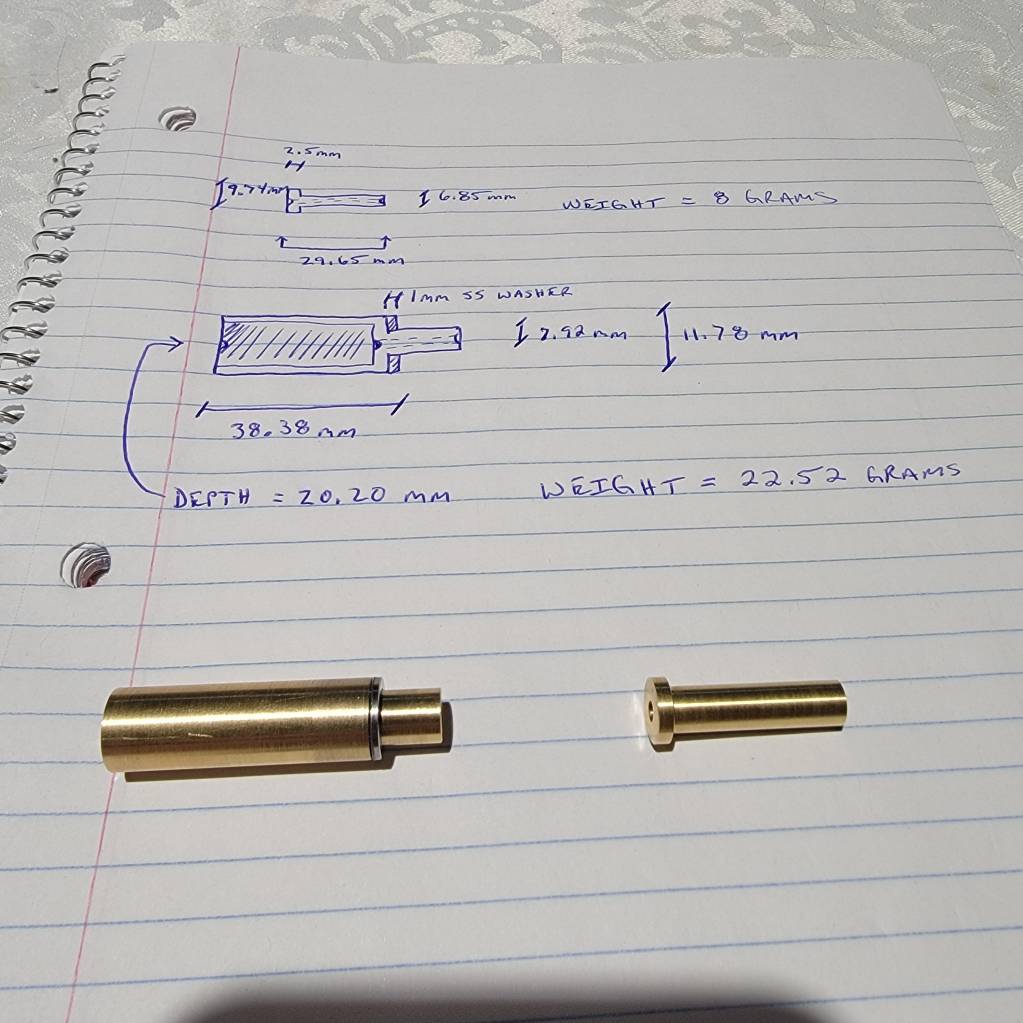

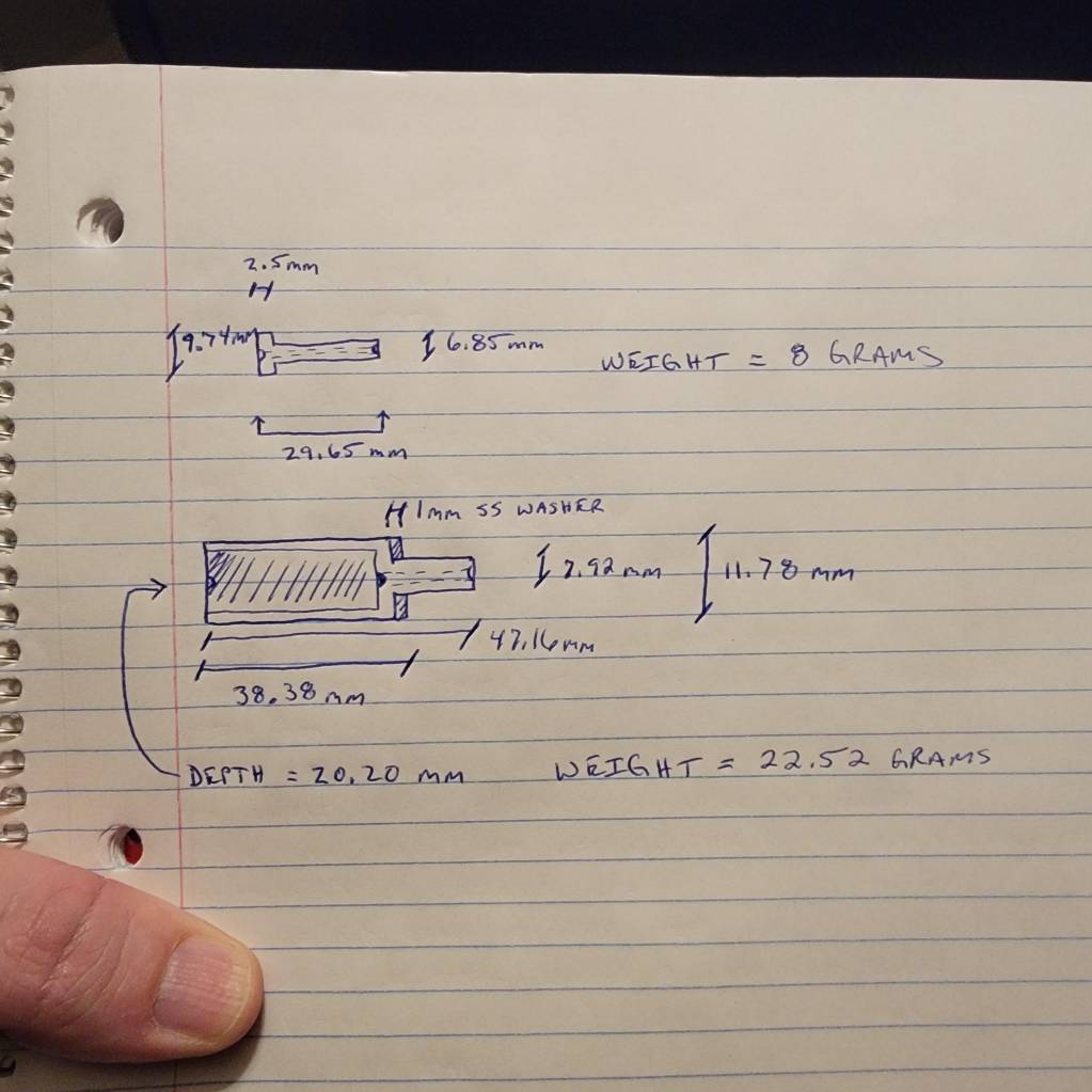

I also have a custom brass hammer assembly to install, which weighs approx. 30.5 grams combined. I will attach a photo soon of the part and measurements.

  • The aforementioned custom brass hammer weighing approx. 30.5 grams combined

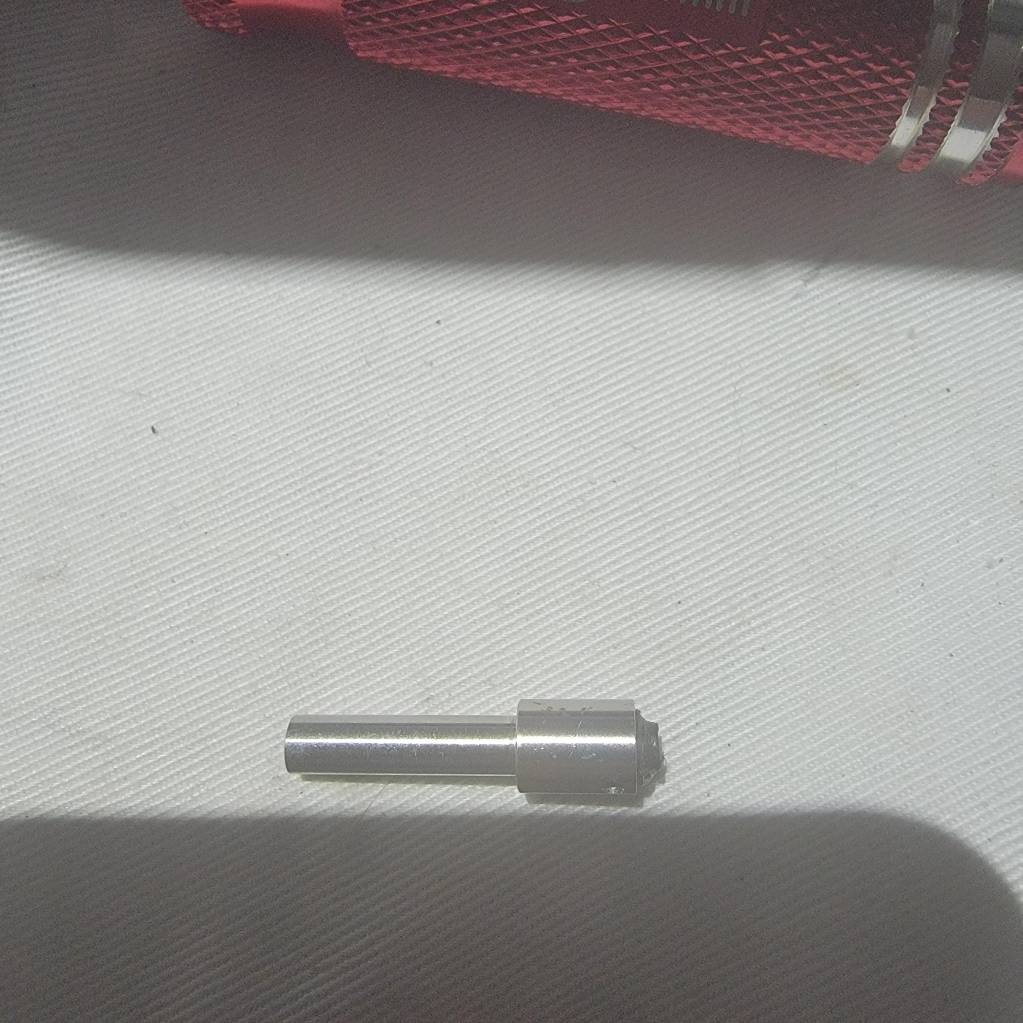

Well I managed to smash the delrin insert into obliteration...lol. With what is left of its contents, it weighs about a quarter of a gram less than the original.
It was because you had a wrong hammer installed. There is one which works with a PUR oring bumber - the one which you have. The other one has much smaller hole with no chamfer - that's the one you were supposed to use.

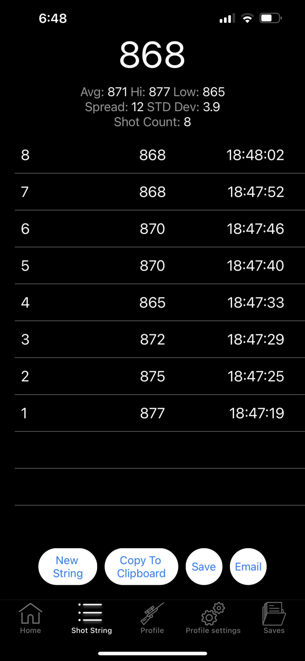

A lot of people don't have the same accuracy I have. I shot a lot of rounds to get there and did a ton of velocity tests. I honestly am not sure if my barrel just eventually broke in or if I hit a velocity node it likes. I am in the 865 fps range for the slugs and I shoot the NSA 93 grain .357's.
