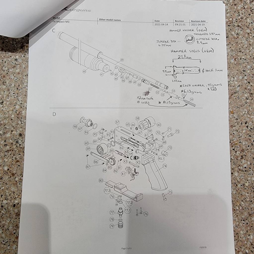

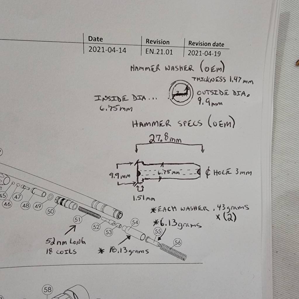

As for the C1, I have it set as far as it will screw on the valve rod, which measures 6.13mm off the frame. I also took the gun apart to make sure the opposite end of the valve rod wasn't un-screwing and it was fine. While apart, I checked for damage on the o-ring and valve sealer piece. Both were good to go and looked great. Afterwards, I relubed the O-rings and put the gun back together. I am getting really quick and good at that part now (lol).
While apart, I weighed the hammer pieces and washers too. Each washer was .43 grams with the main portion at 6.13 (part #C55) grams. Part # C54 was 18.13 grams. All combined I have a total weight of 25.12 grams.
The hammer spring (part # C56) measured 52mm long with 18 coils, if you count the very end ones on each end.

The oem part (# C55) is 27.8 mm long and weighs 6.13 grams bare with no washers. The washers add .43 grams each.
The brass ones I had made are 7.67 grams bare and 9 grams bare with no washers. The 7.67 gram one is 28.44 mm long and the 9 gram one is 29.91 mm long.
The general thought is I can swap hammer weights from a factory 7 grams, using the factory washers and increase the weight to nearly 10 grams if needed. I am trying to get the valve to open above the peak 135 bar my gun is currently limited at, so I can increase the speed of the 93 grain NSA slugs.

Yeah, from what I have read, along with speaking with FX USA service, which is awesome by the way; the C1 should measure off the frame between 5.5 and 6.5 mm. The power wheel should be at 1 when this measurement is taken. I believe it has to do with the hammer spring putting tension on the C1 otherwise.
I plan on calling FX next week to see what their thoughts are. I think I can get more valve travel by removing the piston stop or the rubber balls on the valve adjuster, which may increase velocity. May main concern is will the hammer strike the cocking block pin if I do remove any of those items.

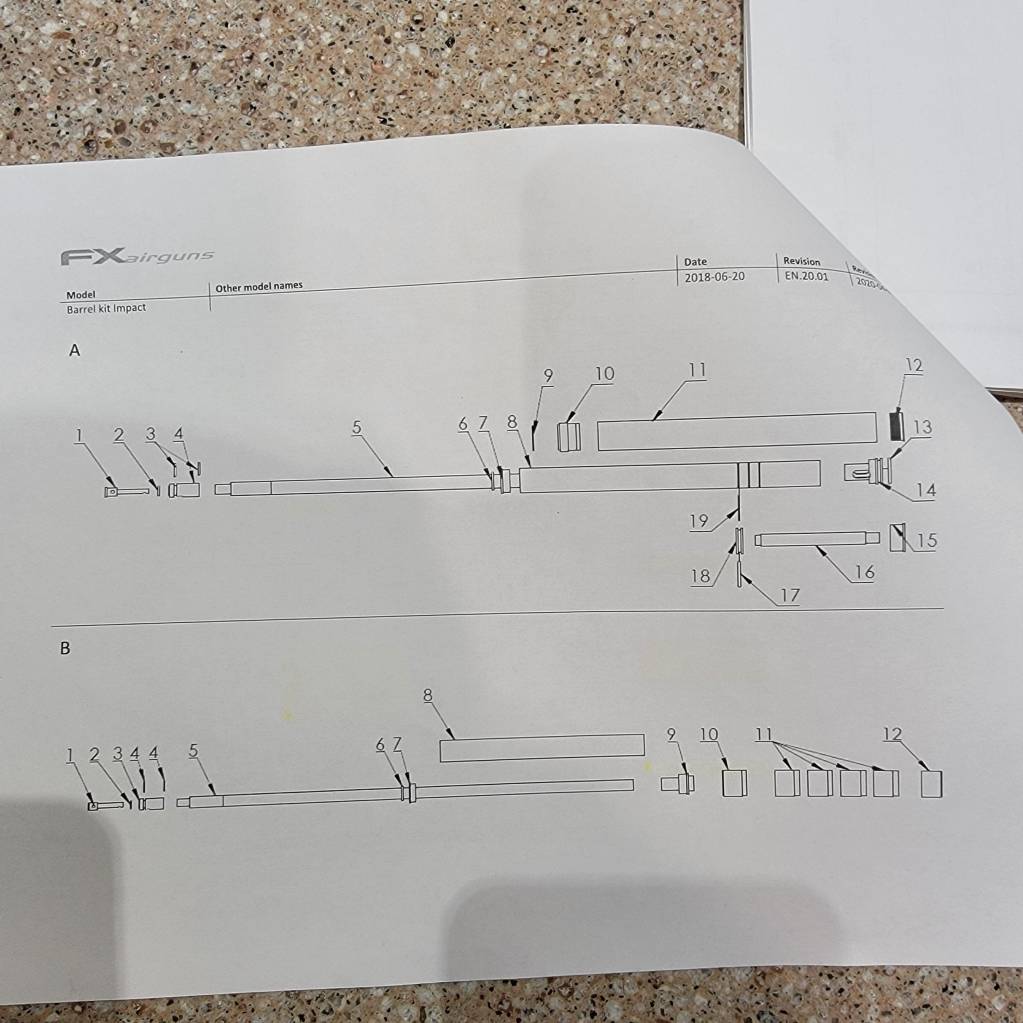

The parts I am refering to removing are C45, C46, and C47. The issue I am concerned about has to do with C54 striking B19/B20 which is attached to B17 (the cocking block)

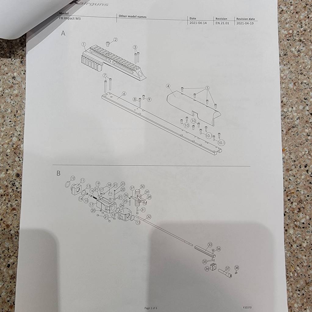

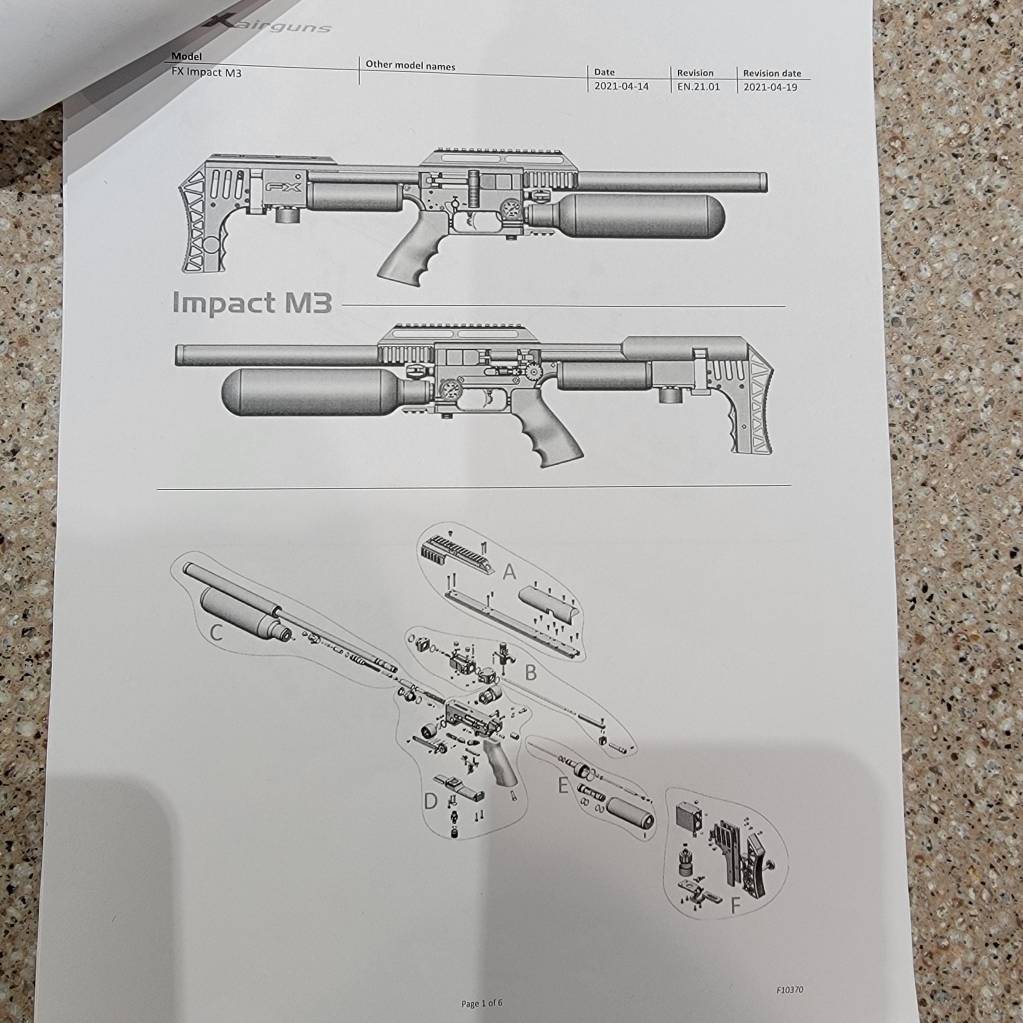

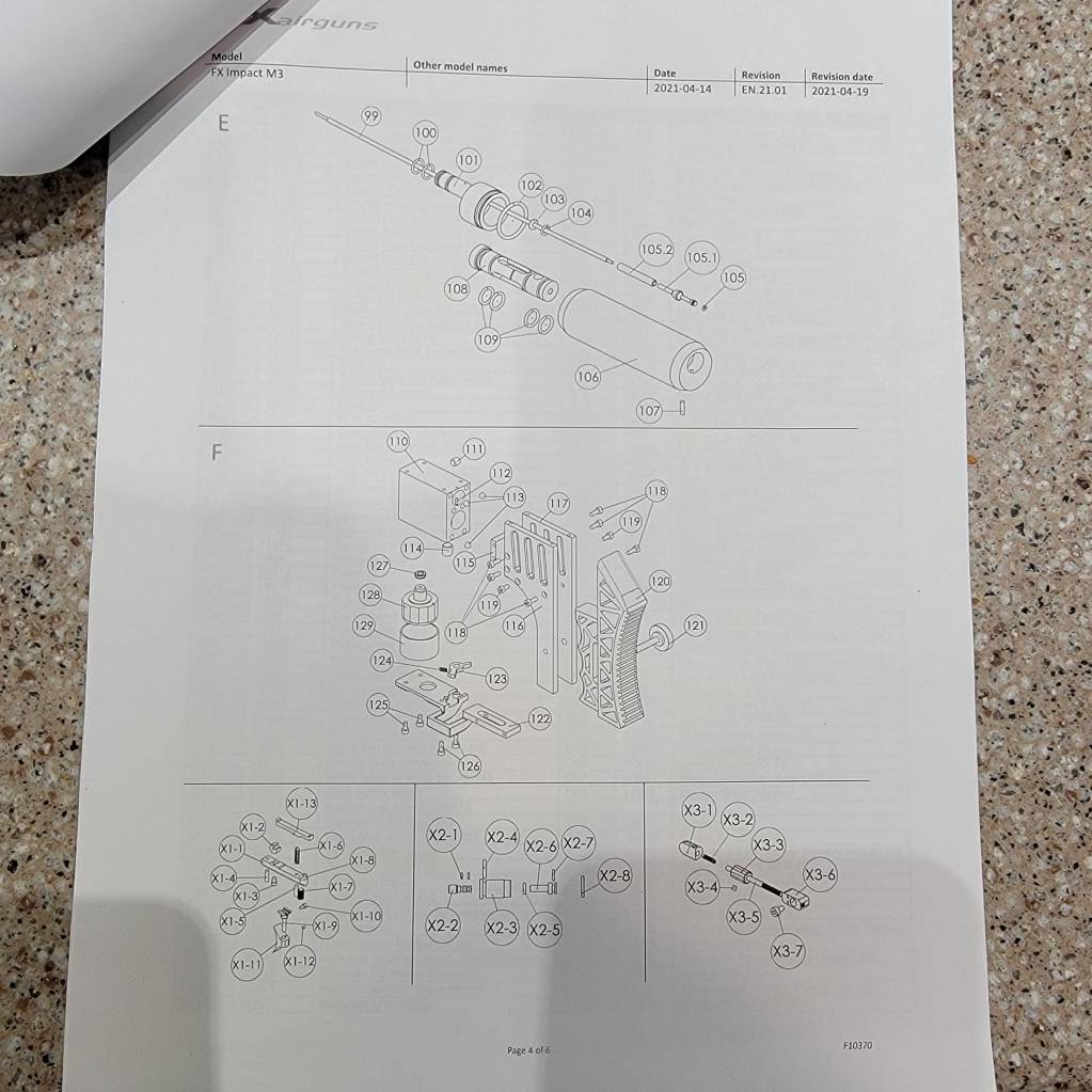

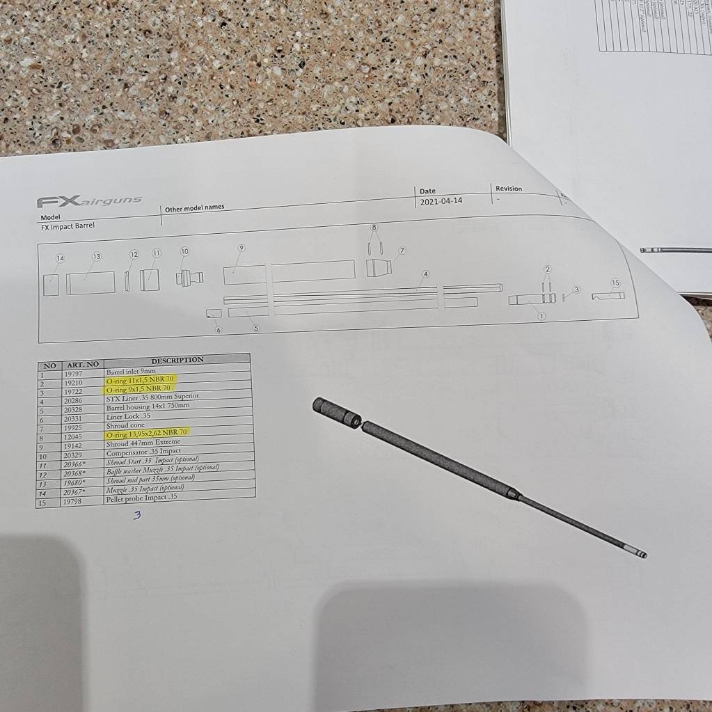

I will try and attach some photos of the parts diagram for the M3.

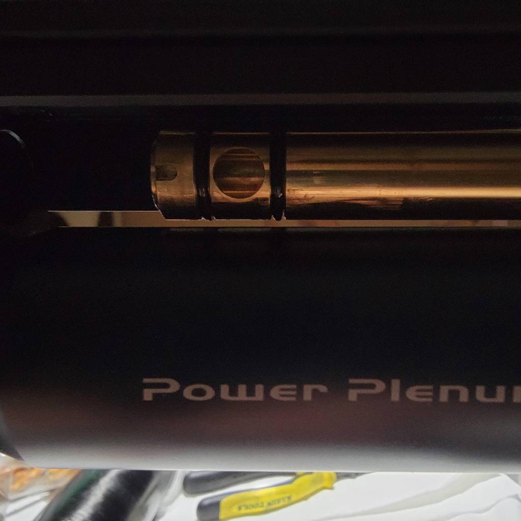

No M3 here, but was just curious about your transfer port as to whether you had a dual port to give the best airflow. Also, the HS adjustment for tightening up the HS tension. There seems to be no limit up until the PW won't turn anymore on my MKII. No issues with reg set up to the max of ~ 170 bar.

The photo's should also make it easier for other to follow on this post. At least for those who are like us and new to the FX Impact. The schematics are available for print on FX's website too.
I am working on a parts list for all of the o-rings associated with the gun too. I have already created a bin of most of the M3 sized bolts, in case I lose/drop one.
I plan on waiting to see if FX or Huma come out with a .35 cal tranfer port before I mess with it. If I had a spare, I may be more apt to oblong one with a dremel to widen the gap and smooth out the air flow.

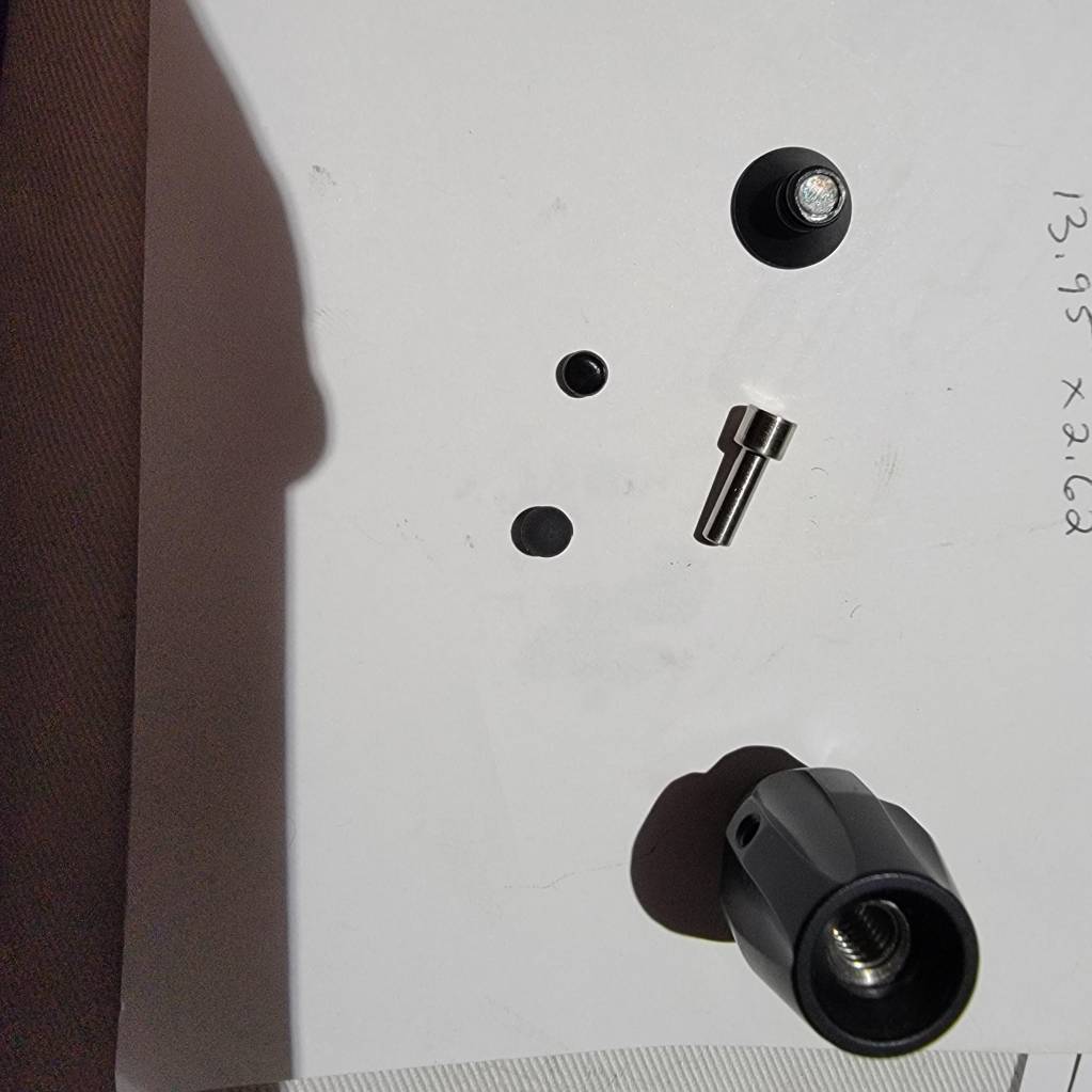

Both are smaller than they were new, but the smaller 4mm one has been flattened pretty well. I have been debating on removing the piston stop and balls, then placing the 4.5mm ball in the valve return spring. I just worry about the ball being forced into the small hole on the inside of the adjuster knob and ruining it. The small hole is for the metal piston stop you see in the photo.
If I remove the small 4 mm ball, which now measures 2.69mm; I would in theory gain that much more valve travel opening the valve more. My main concern then becomes will C54 (hammer) strike the cocking pin (B19/B20). B19 and B20 are connected to the cocking block (B17).
The heavier hammers may be pointless if what has been limiting the power is the hard stop of the balls and the piston stop.

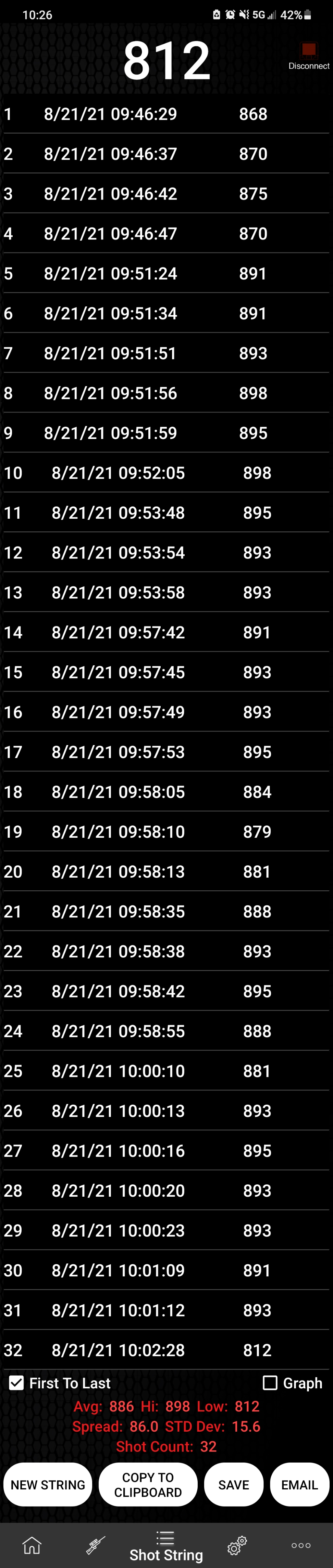

Above is a shot string I did this morning with the 4mm ball removed. The first reg was set at 190 ish bar through the entire string. Everthing else hammer wise was maxed out.
Shots 1-4 with the 2nd reg at 155 bar, which was where I left it with the last test.
Shots 5-7 are at 140 bar or so.
Shots 8-11 were around 135 bar
Shots 12-17 were around 130 bar.
I then adjusted the valve adjuster to see how far in I could go until it impacted velocity. It was maybe a turn.
Shots 18-21 represent that.
The remaining shots until the last, #32 (NSA 93 grain @ almost 150 bar), I began upping the pressure in approx. 5 bar increments and stopped just under 150 bar. As you can see, there was very little change in velocities. I did this to confirm my data.
With the 4mm ball removed, it appears the extra valve stroke is allowing a little more air to flow at higher pressures. From about 130 to 145 bar, the velocities are nearly the same. Prior to this, I would see the best velocity from 130-135 bar and past 135 the velocity dropped significantly. 145 bar would be in the 870 to 880 range vs. the 890 range now.
My guess to the results is the valve is open longer when less pressure is used and shorter when higher pressures are used. Short burst vs longer burst of air, but a similar volume total because the velocities are similar.
