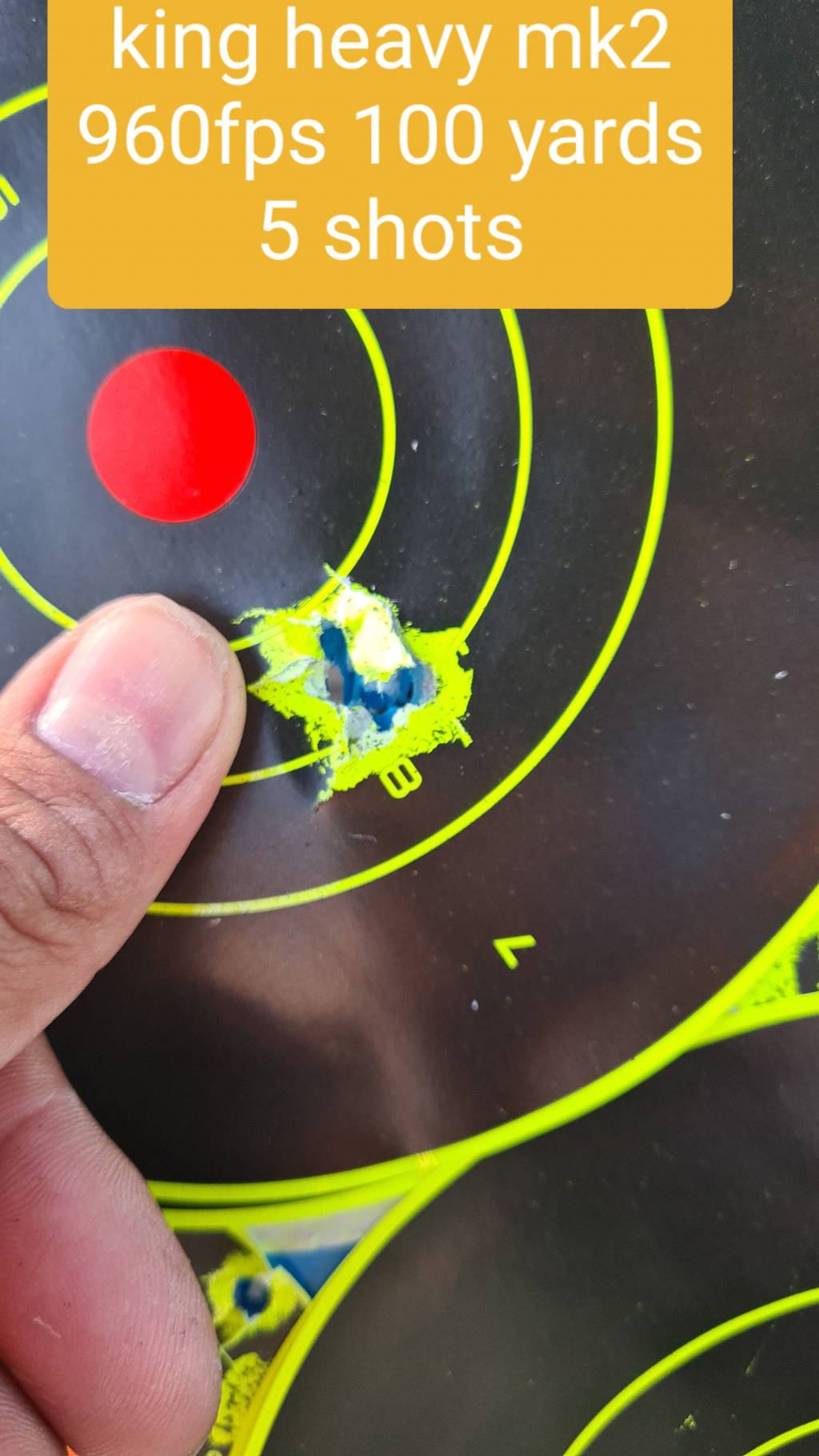

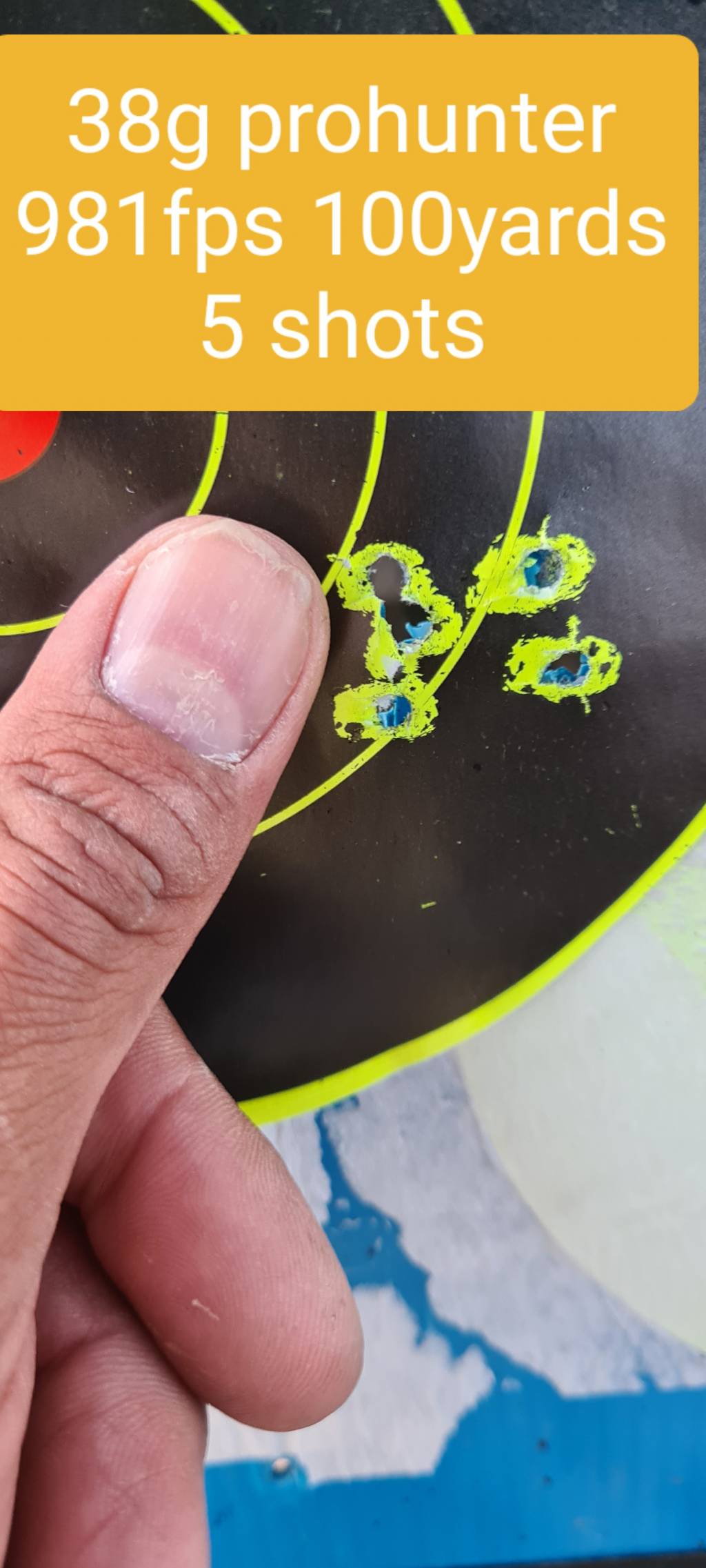

So far its not been a chore for me to use a tune that someone has given me , my favourite to use at the moment is 1ST REG=175BAR 2ND REG=150 BAR ,MACRO 16 MICRO 4.75 AND FRONT VALVE 14MM OFF THE BLOCK. This lets me shoot 38g prohunters at 981fps, wildman slugs at 39g at 970fps and when i turn the macro down to 10 i can shoot 33.95g mk2s at 960fps sub moa at 100 yards ,all have very consistant shot strings.
The only thing i have changed is that use the superior liner and NOT the superior heavy liner AND i have my barrel turned to the slug port.

I did find that i got a few slugs ( not NSA) to group under a inch at 100 yards using this same tune = 1st reg 175bar ,2nd reg 150 bar , macro 16 ,micro 4.75, front valve at 14mm , and for some reason my 700mm superior liner works really well ,so well in fact that i havent bothered using the sup heavy liner yet.
