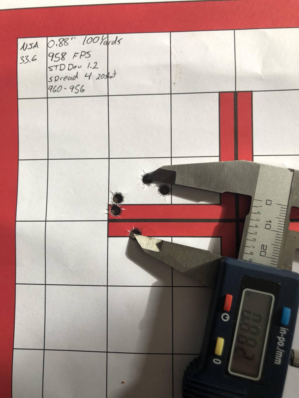

Well I got out today with my new slug liner installed and had some good results. I was getting about a .75” groups at 50 yards shooting the NSA 33.6 grains. But when I moved out to 100 I got a 0.88” CTC 5 shot group, I was pretty happy with those results. I got the STD Deviation down to only 1.2 across 20 shots shooting at an avg of 958 FPS with a high of 960 and low of 956 so spread of 4. Thats the best spread I’ve ever achieved even with pellets so I think I finally found the tune for my gun. The first reg is set at 150 second reg at 120, then my return spring is 12.27mm out power wheel set to 16 and the micro wheel set a hair under 4.5. I wanted to keep playing with the tune but it’s shooting pretty good where it’s at so I don’t wanna mess it up but I still have to test other weights in the new barrel so I just hope I can get it back to this good if I come back to the 33.6g slugs, maybe I’ll get the 36.2s to group better next time I go out. Gonna have to wait for a day off to go see.
