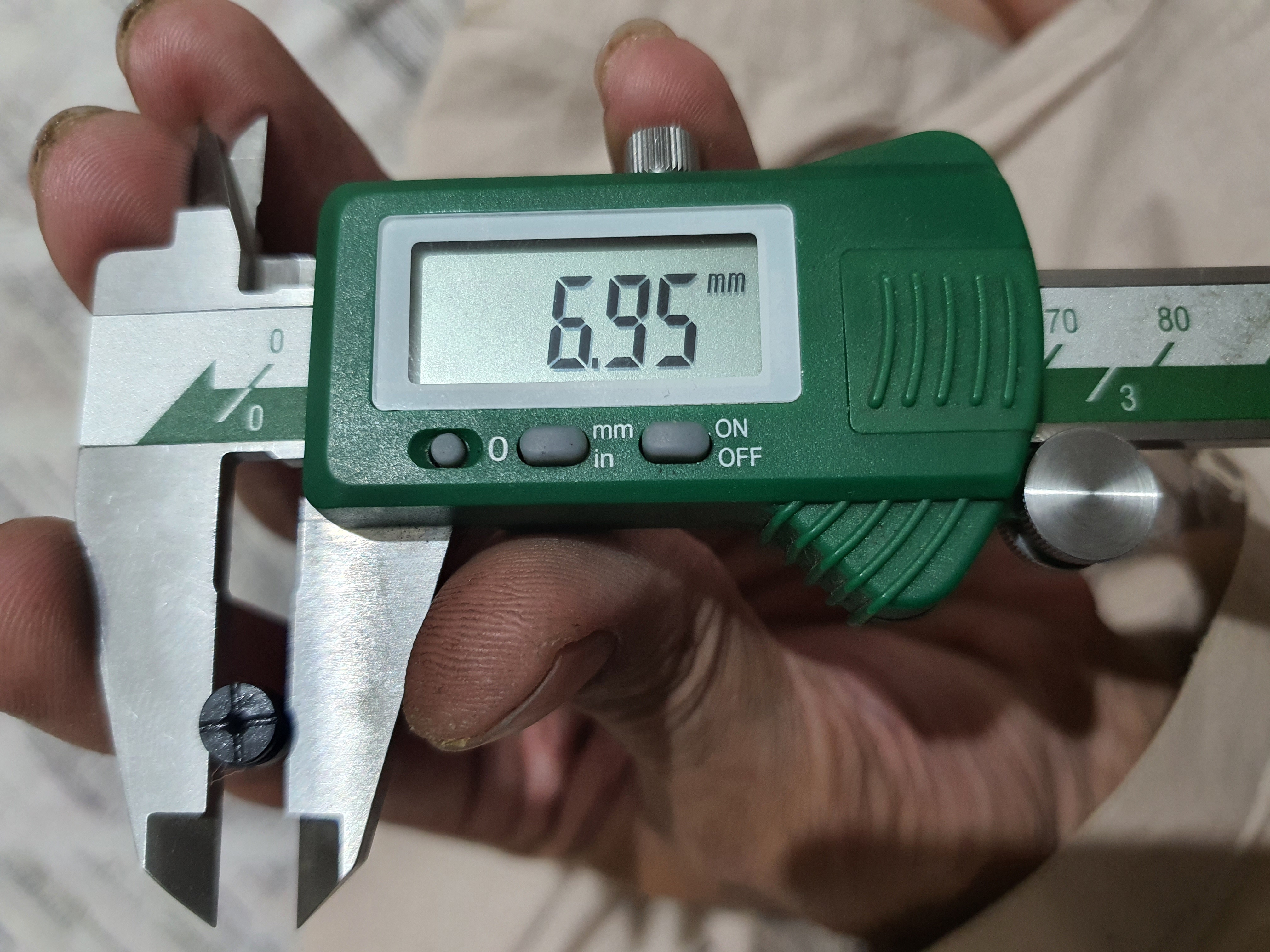

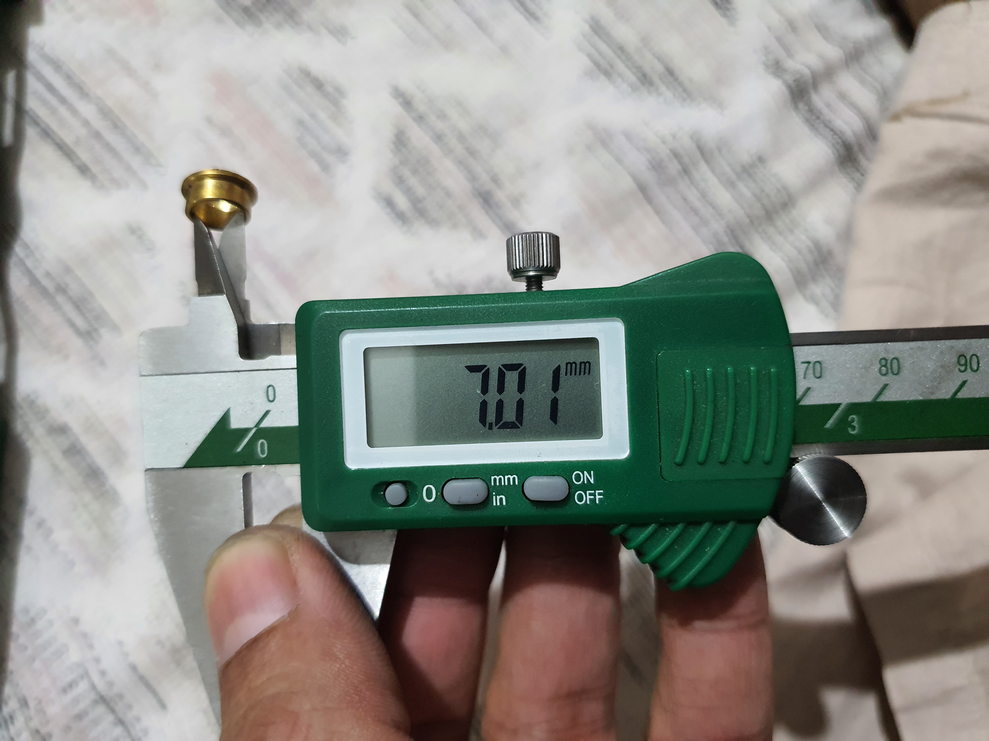

I have been facing some issues related to 1st regulator for some time. Some of my friends who had used their guns for reasonable time and opened the 1st regulator for re sealing shared similar issues.

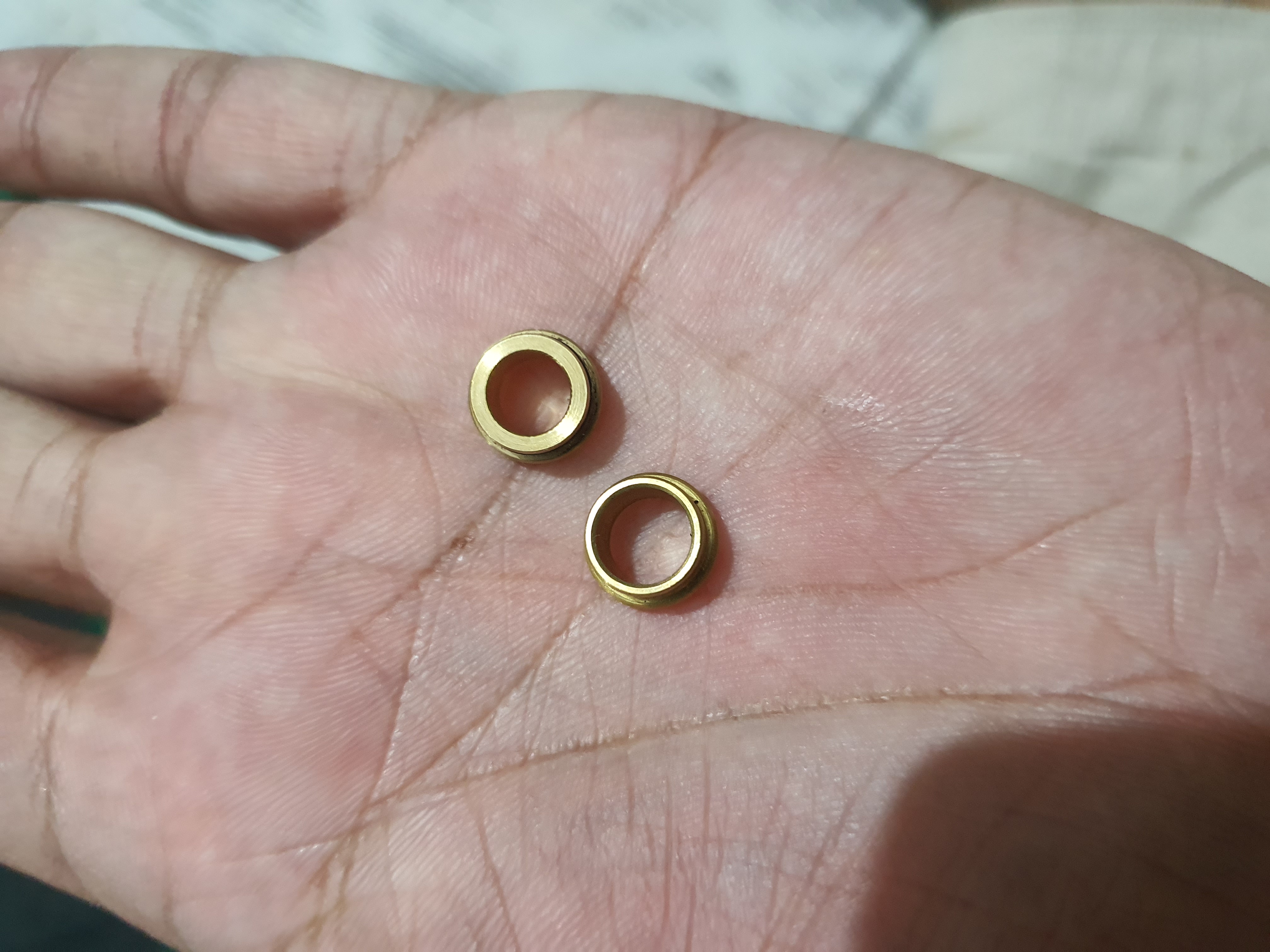

Here are pics of problematic brass part in which piston head enters and on other side there is a groove type thing in which 7.5 x 1.5 mm O rings sits and seals the regulator internals with gun body.
This O ring stops the air that can come from between the outer dia of brass part and inner dia of main stainless Steel body.

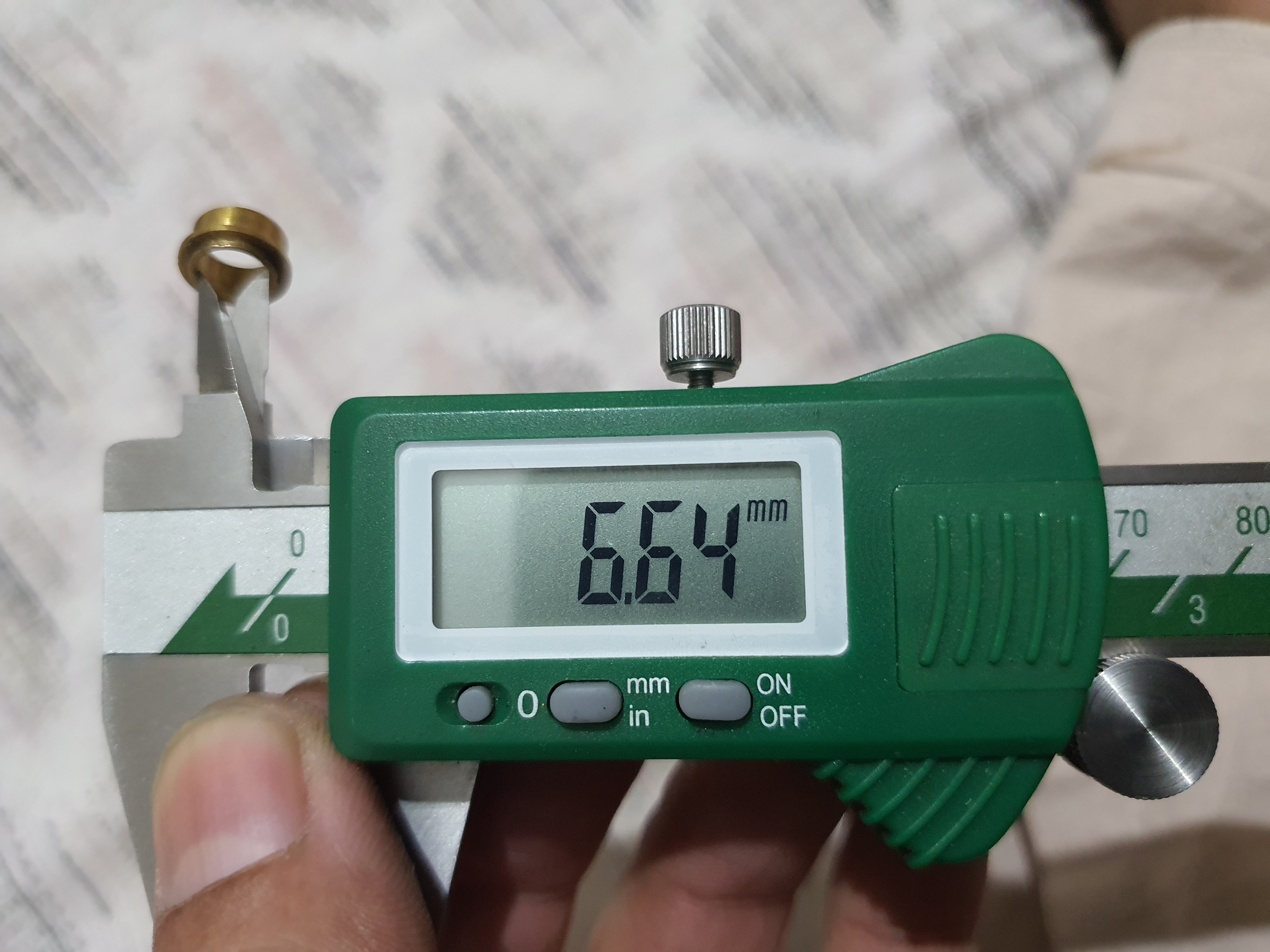

You can see in the pic that may be due to air pressure or excessive use, one end's dia is 6.64mm and other end's dia is 7.01mm.
When the gun was new, these dia were almost same and the piston head could be inserted from either direction. But now due to one end being 6.64mm, the piston head doesn't pass through it and causes working issues and sometimes sealing issues too.

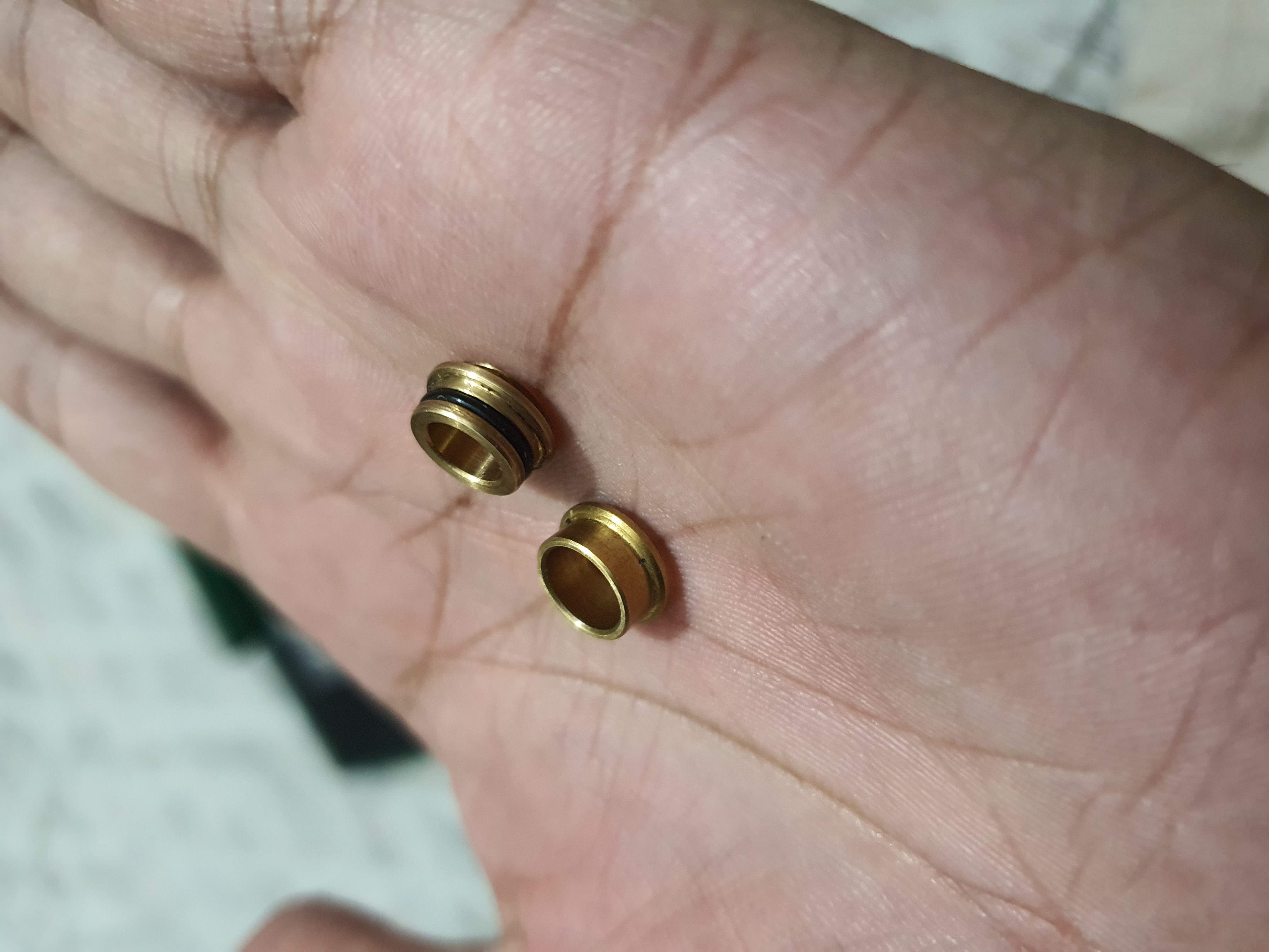

In order to fix this issue I developed a new part with more meat of brass for sturdiness.
To make it thick I have to reduce in the inner dia of this part but it also gave me opportunity to make a groove outside the new part and install a thin O ring to seal this part.
Now the new part seals with the inner dia of main stainless Steel part, bottle connector.

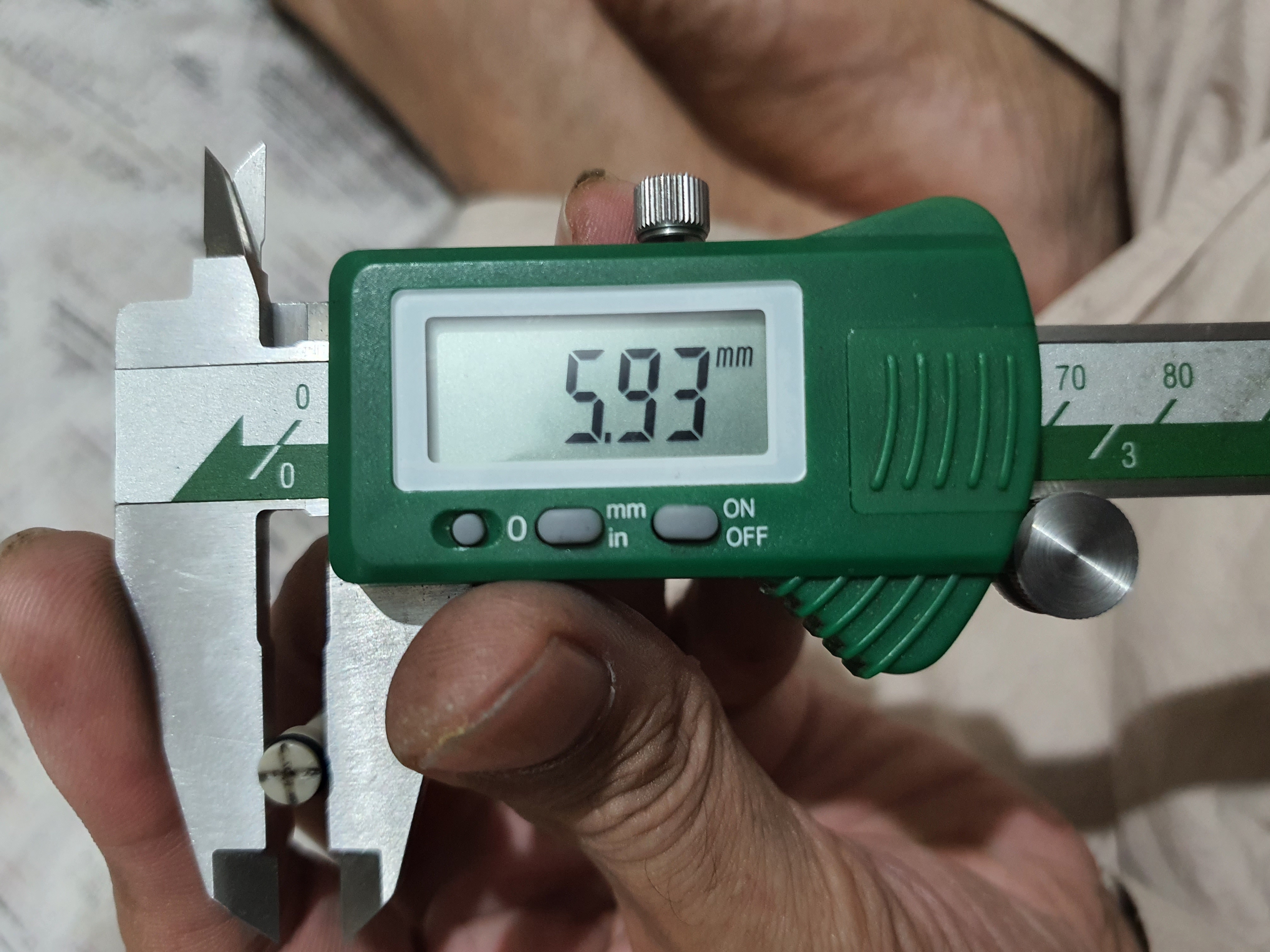

As the internal dia of new brass part is smaller, I made a new piston with the smaller head size that could work with the new part.
Now you can see that the head size of new piston is 5.93mm as compared to original piston head i. e. around 6.95mm.

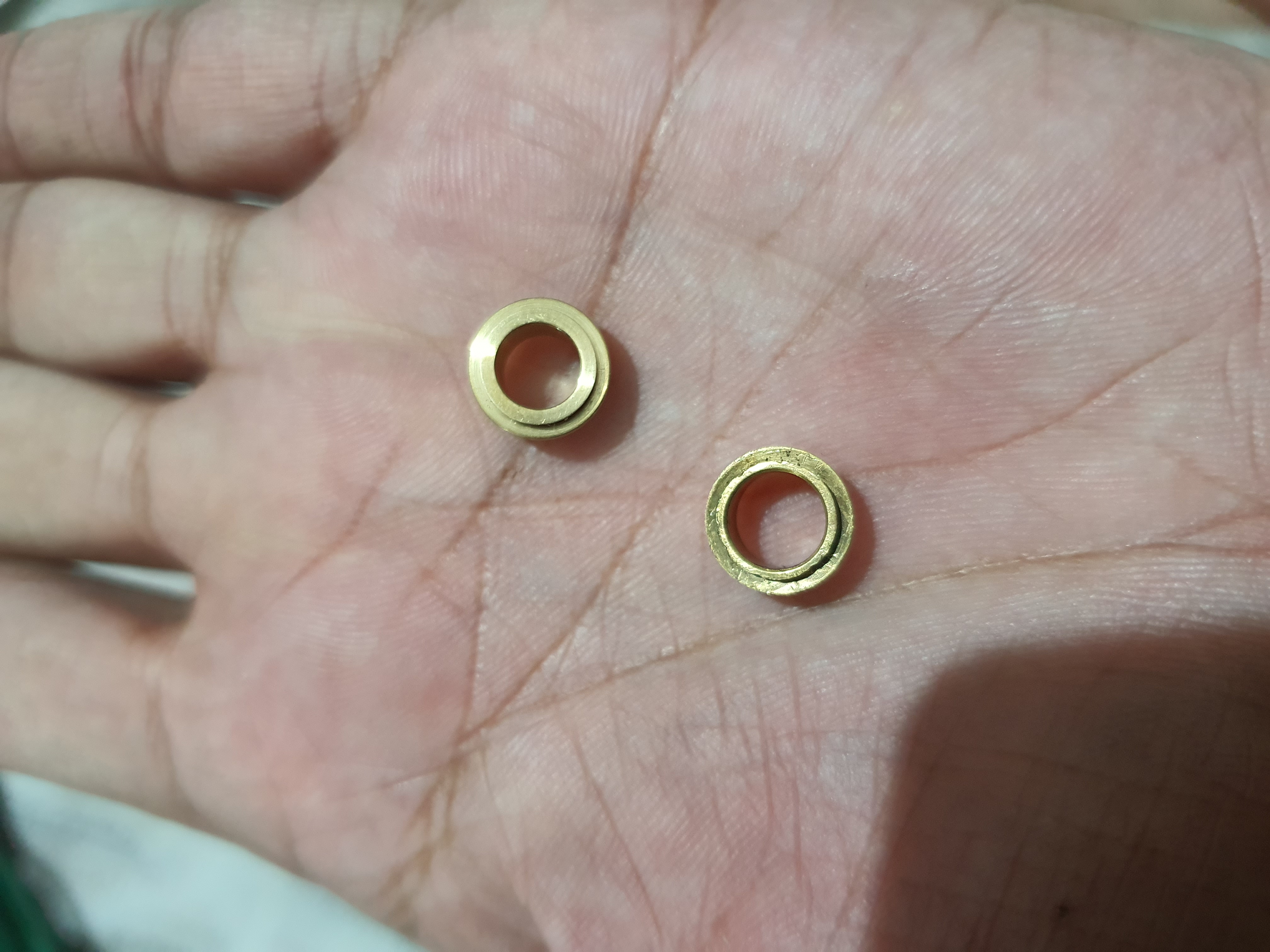

Finally found that FX Impact M3 all regulators following part is conical irrespective its new gun or used.
Now the part that I had made was straight and with an additional O ring for better sealing. A piston with smaller head was to be used as new part was made thicker intentionally. As shown below.
But as discussed above the new part and new piston were sealing perfectly but were not giving a good recovery time.
After more and more research, I finally found that FX was intentionally made this part conical from inside.
This tapered surface helps regulator piston to move back quickly as when the regulator is moving back, it is travelling towards the bigger internal dia.
So finally I also used the same logic and created a tapered internal surface by 0.5mm from one side to the other side.
Made a new piston matching that tapered surface and installed new O rings.
Hurrah, the recovery has come back to the point where its good for me.
The tapered surface resolved the recovery time issue.

Smaller piston head is not creating any noticeable delay in recovery. Previously I was thinking that smaller piston head is creating the problem.

My customised piston was still with a bit smaller head than OEM.
Today I did a bit more machining and made the brass piston sleeve to accommodate OEM head size piston. The sleeve is conical internally between 0.3 to 0.4 mm from one end to other end.
The modification with 1mm Cross section O ring is still there for better sealing.
The bigger piston head helps in even better recovery and the 1st reg goes down by 15 bars only after each shot.
