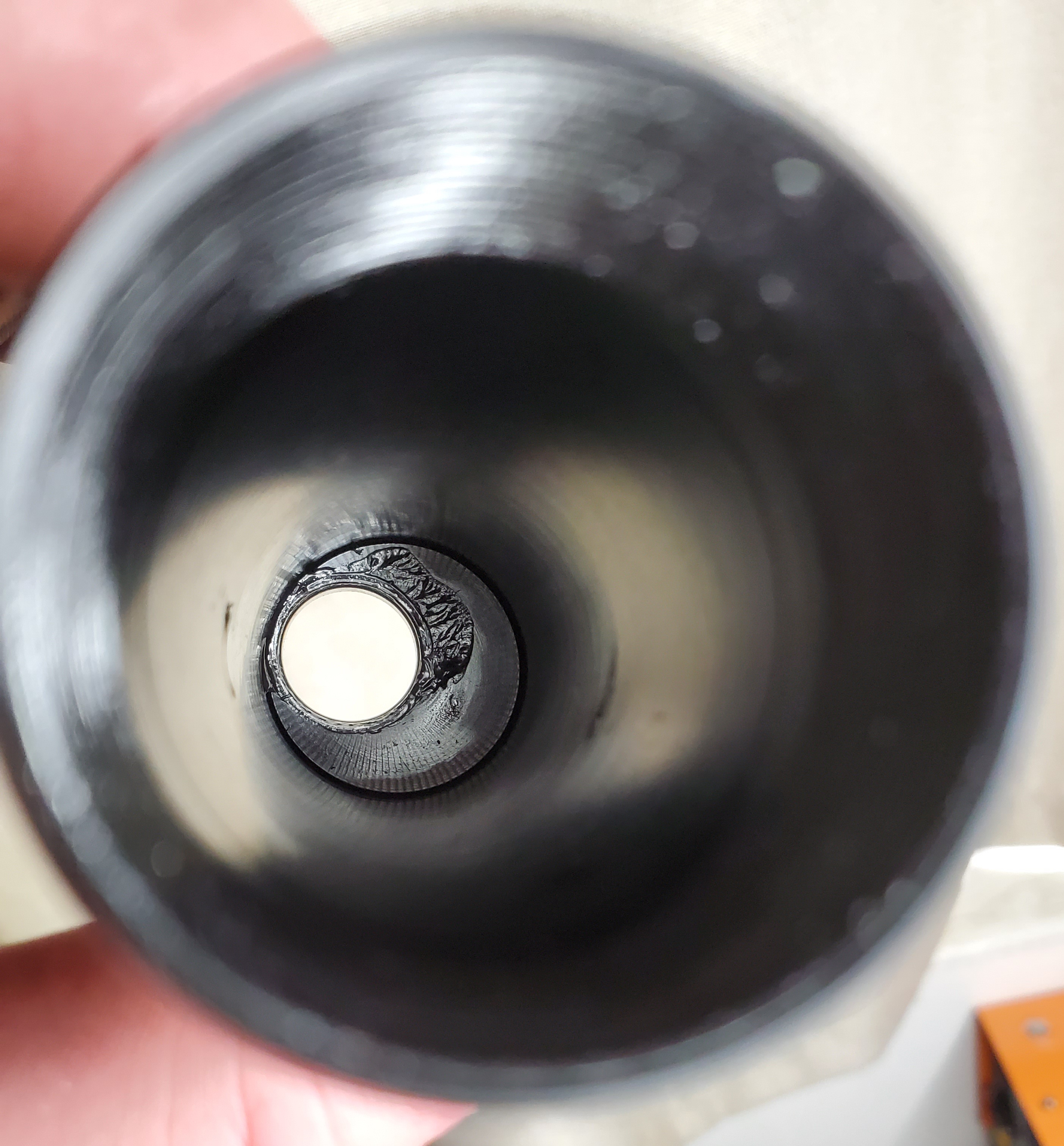

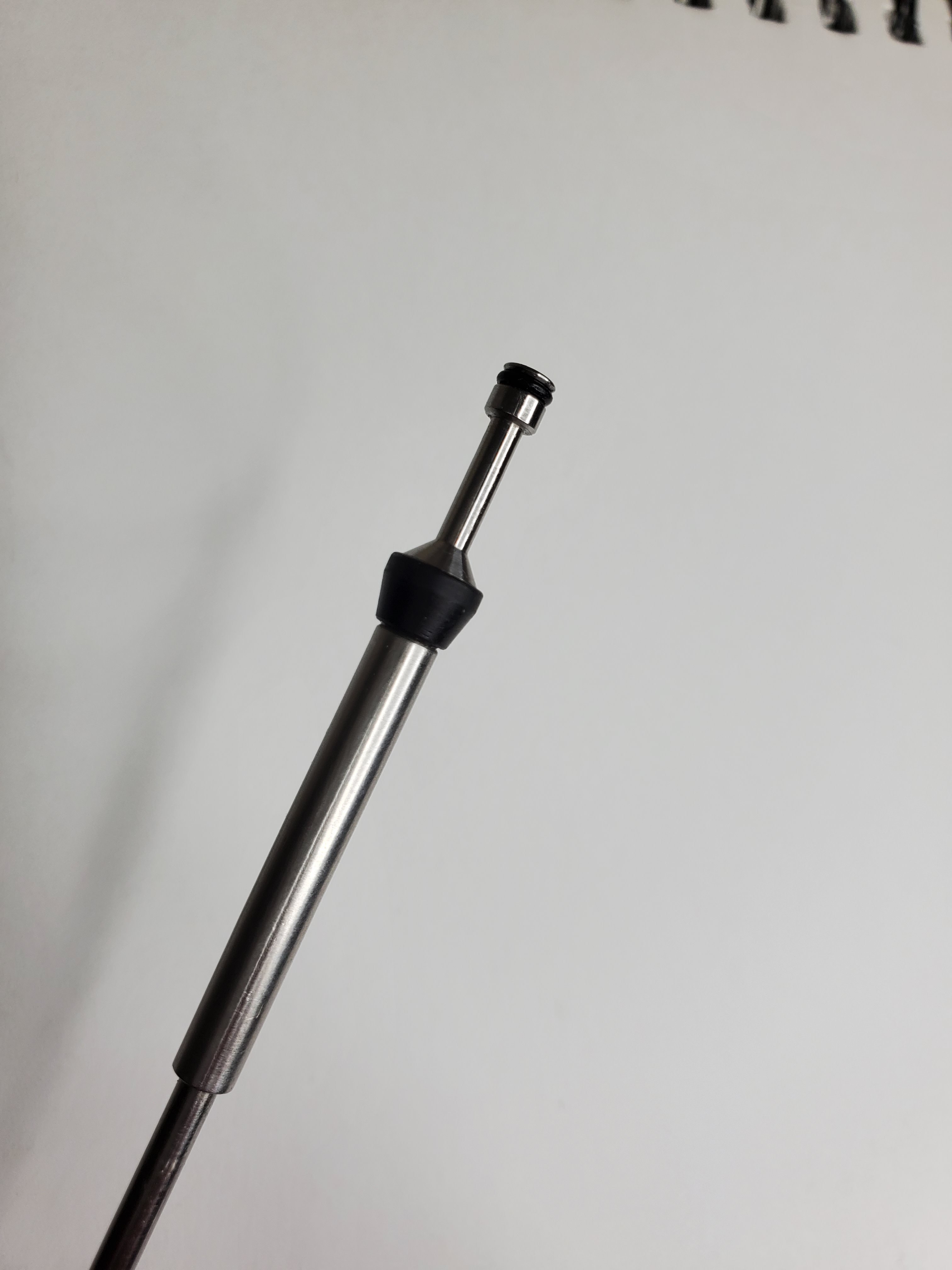

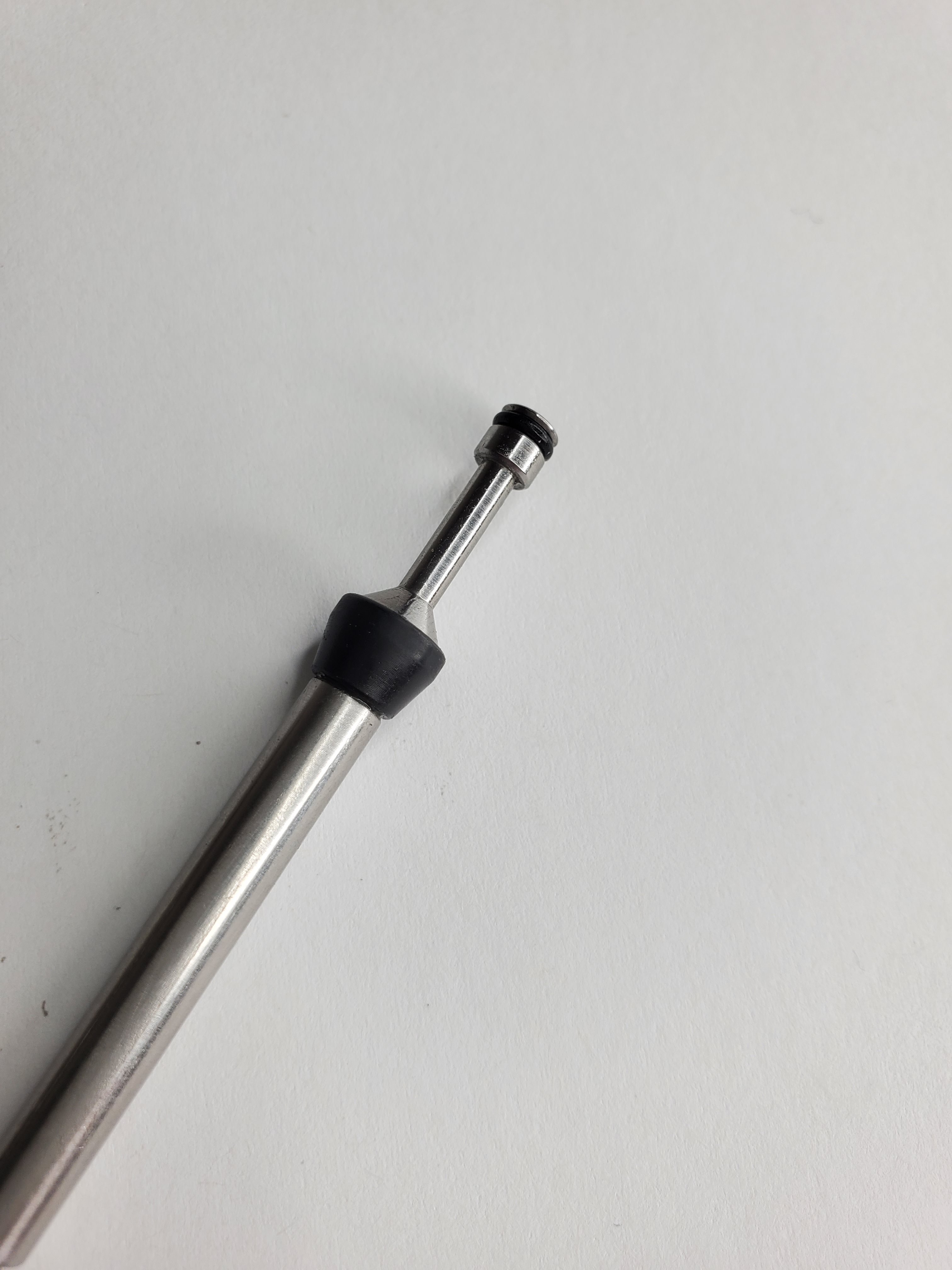

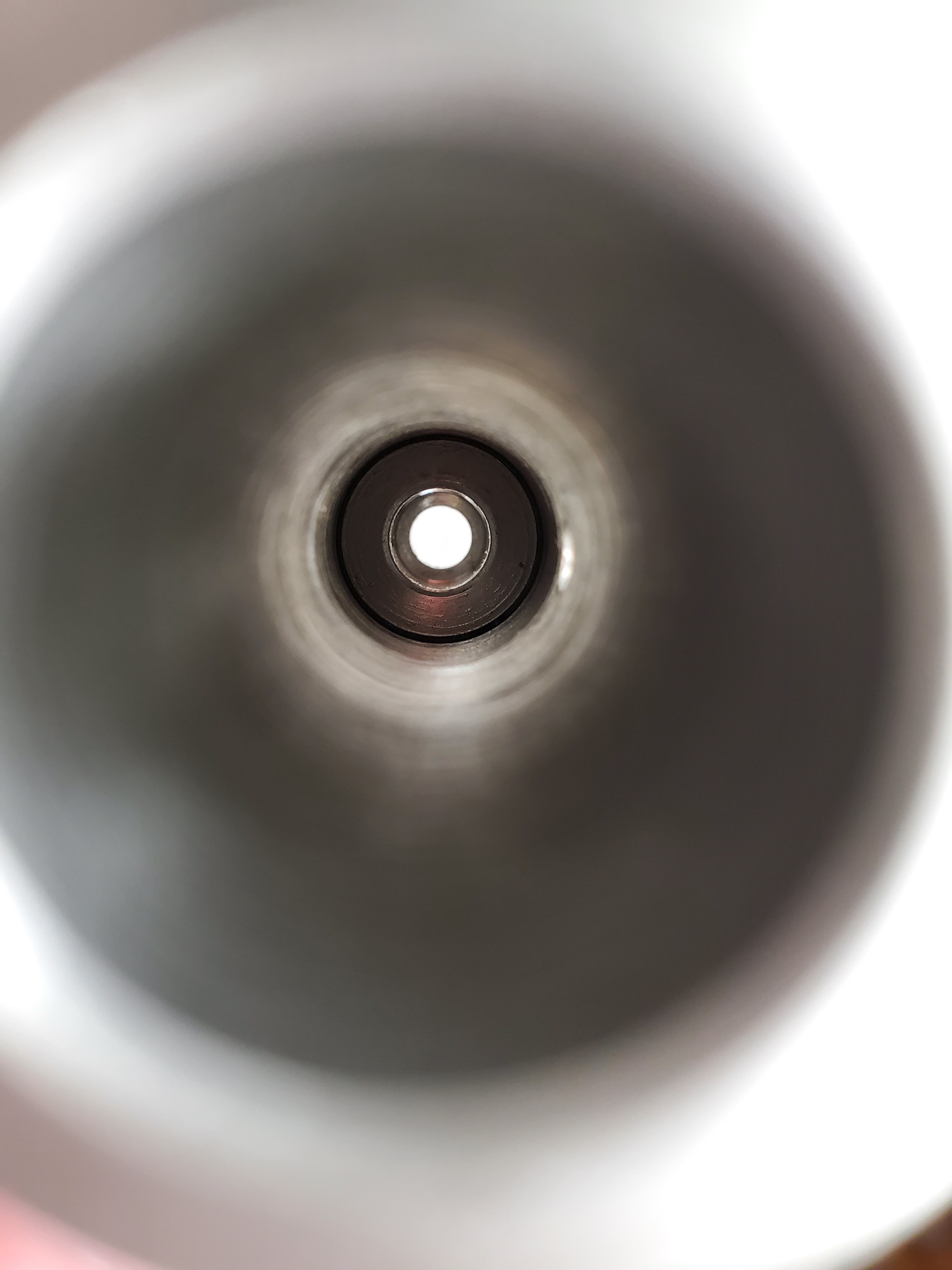

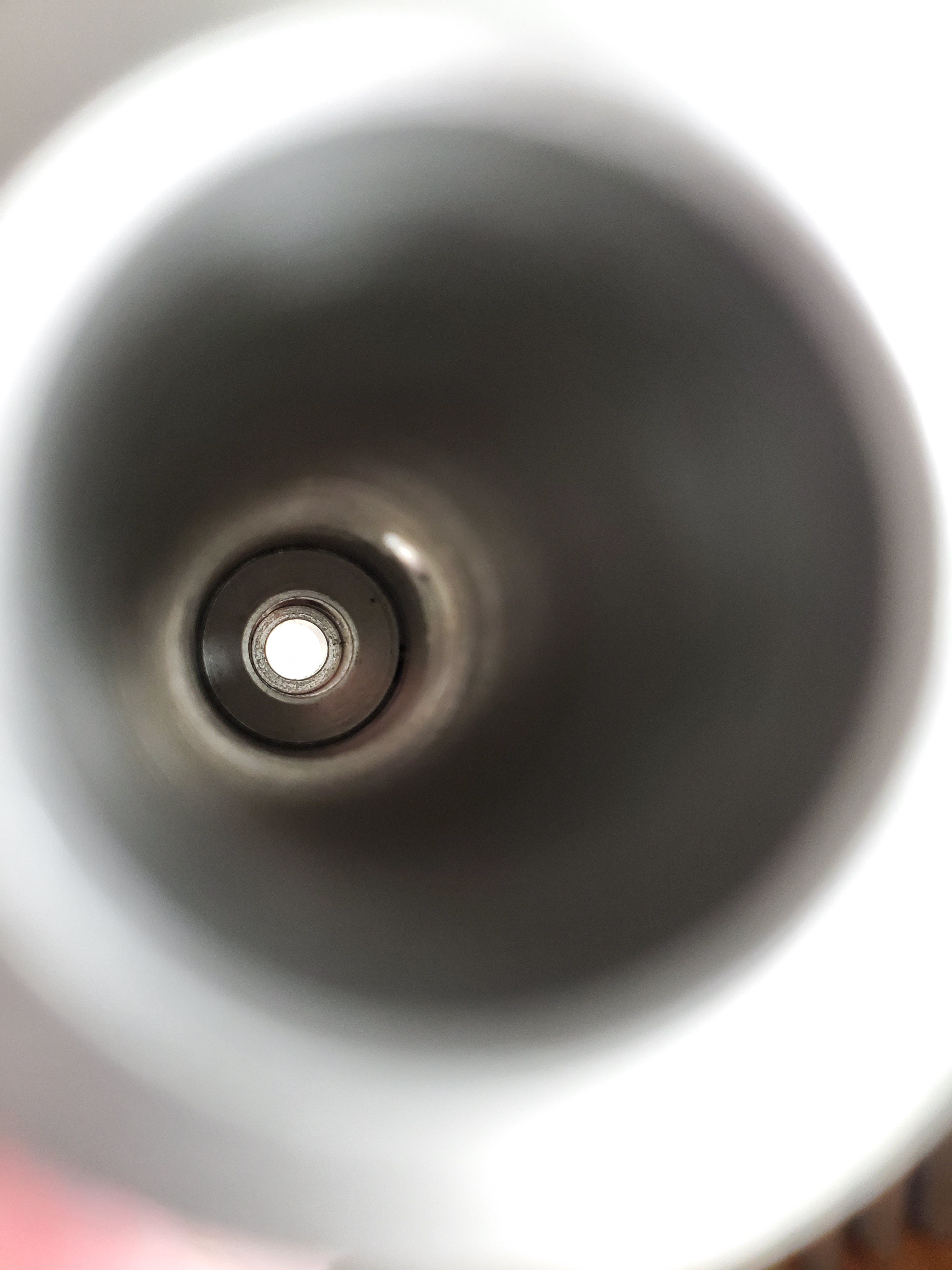

Show me the interior of your valve housing - there should be a cone on which the valve poppet seals.
Here is the valve housing, plenum (both from Power Block) and the valve stem. See anything wrong?
