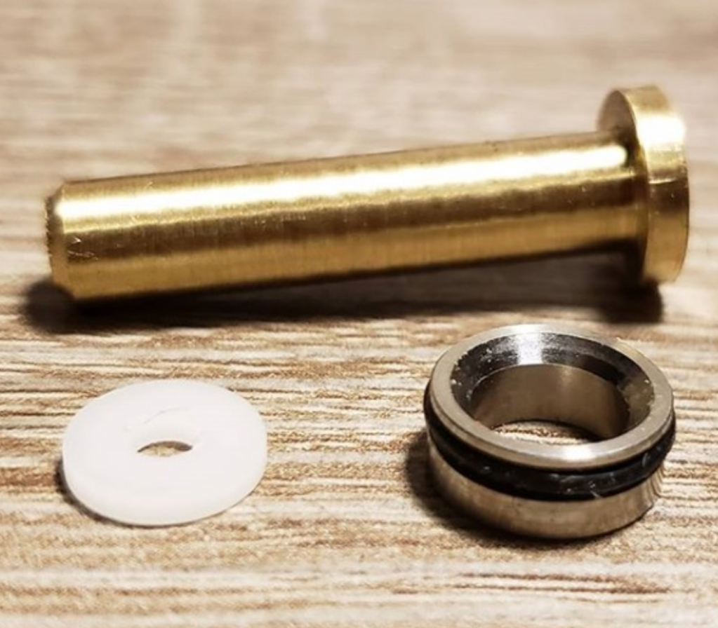

Finally made my first couple of acetyl C3 replacement bumpers. It was not a fun process, I probably burned through 7" of the 3' rod trying to mill the center perfectly! I had eventually came up with a repeatable process for getting it centered 💪
That looks too thick, 1.5 - 2mm anything in between is fine. Over that can lead to a few problems, guess you will find out ;)
And remember, is a bumper so you have tolerance (if is not perfectly centered), that been said, is very easy to make that hole just with a drill, just do not try to make the hole 3.5mm at once, do a smaller one 1.5, and then 2mm and the 3.5
