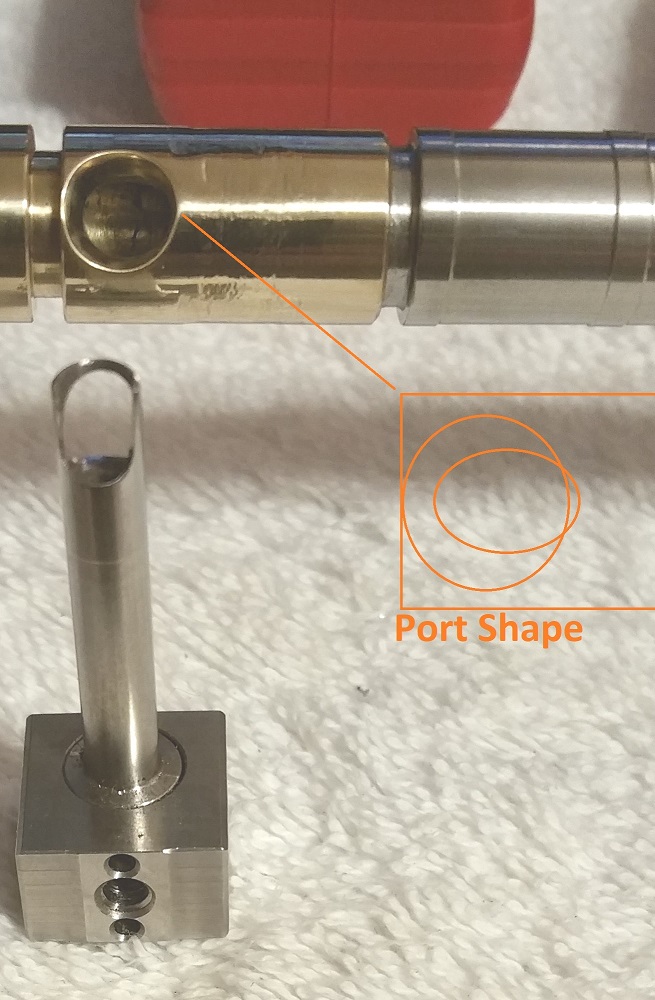

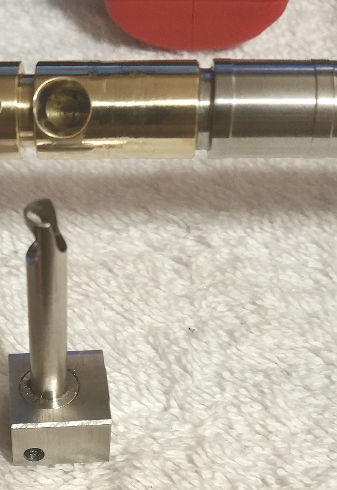

Also can you post a pic of your brass port mod?

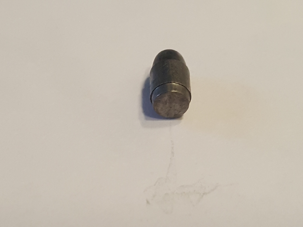

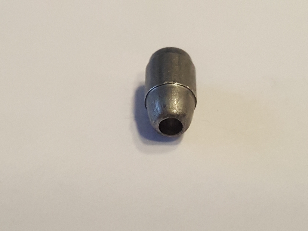

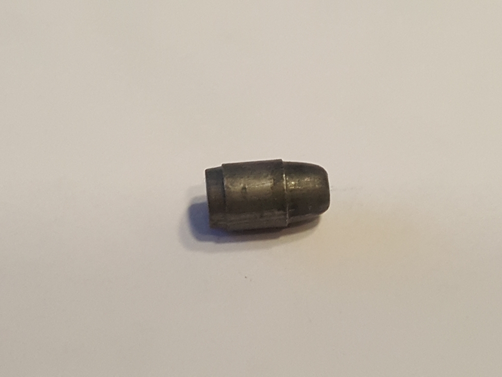

These are the slugs I have:
Pellets and slugs are totally different, IME they have about 5gn difference, meaning that a 34gn pellets speed will be about the same than a 29gn slug speed (not exactly, just to have an idea). Something about the Flat Base and size probably.
So removing the O on the probe will give more fps? You mentioned removing also the top of the probe. Is that needed? So then the probe would be something like this? ( )
yup, top of the probe is the same than the O (I am referring to the same, depend on the POV) any shape that remove the O will do it ( ) will, or the Heavy shape or the one I show on youtube. Many roads leads to the same place! ;)
