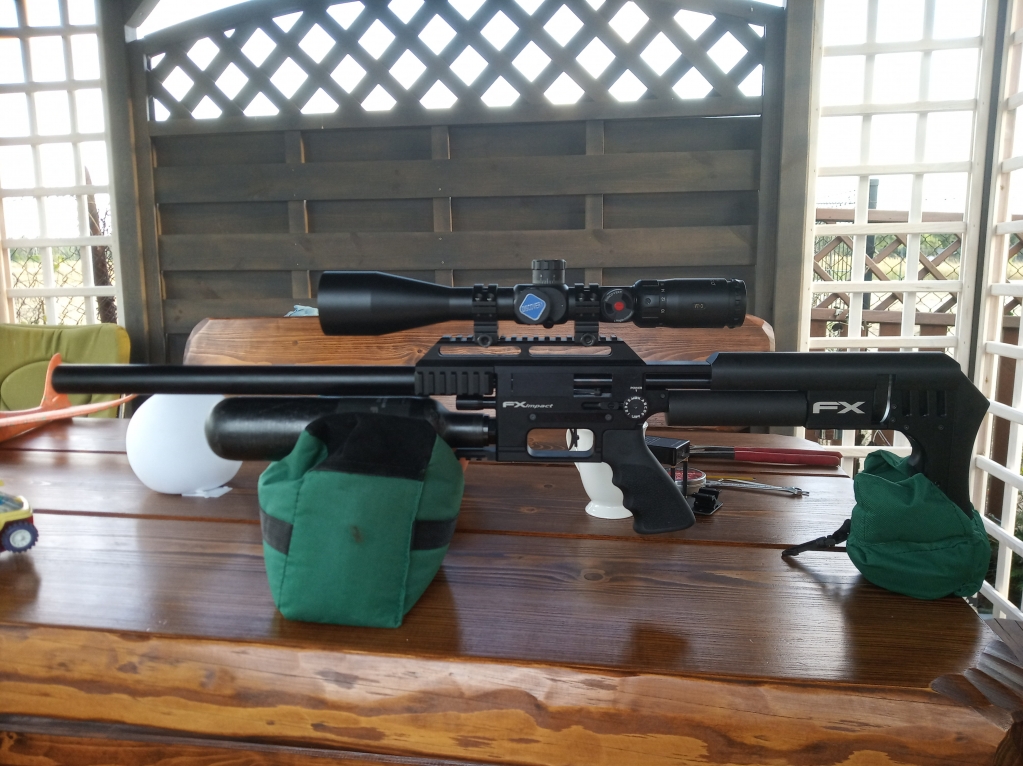

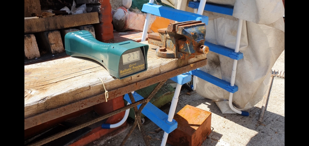

Today have done some testing with mp mould 47.2 grain slug in .25 with my friend Impact. FAC power on thise slug was 225ms and after mods ( TP, Pellet probe, 6 gram HW, external plenum )... soeed went to 277-278ms ( around 910fps) at 155bar. More to test on targets.
Also, I got Huma gen 3 reg for my Impact, but something was wrong with it. Culdnt get more power than 110bar...
So, I took washers from FX reg 11 ocs and add 1 more from Huma in total 12.
Reg setings ware from 140 to 200bar ... impresed

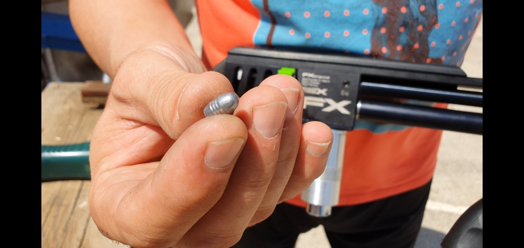

Did you lube the bullets with silicone ?

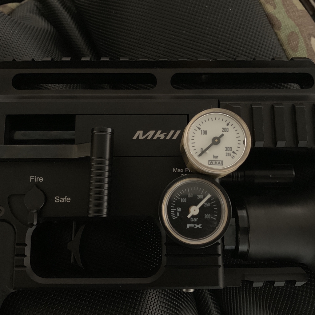

Got my 25 cal MKII a couple of days early. The 700mm .22 kit and slug liner came yesterday and I went to work right away on the TP and probe.
This thing is an absolute beast! I didn't even have to max out the hammer tension screw to get it shooting 30gr VKs at 950fps, not sure how accurate the manometers are on this, but I stopped at 142bar to get that velocity 🤘
