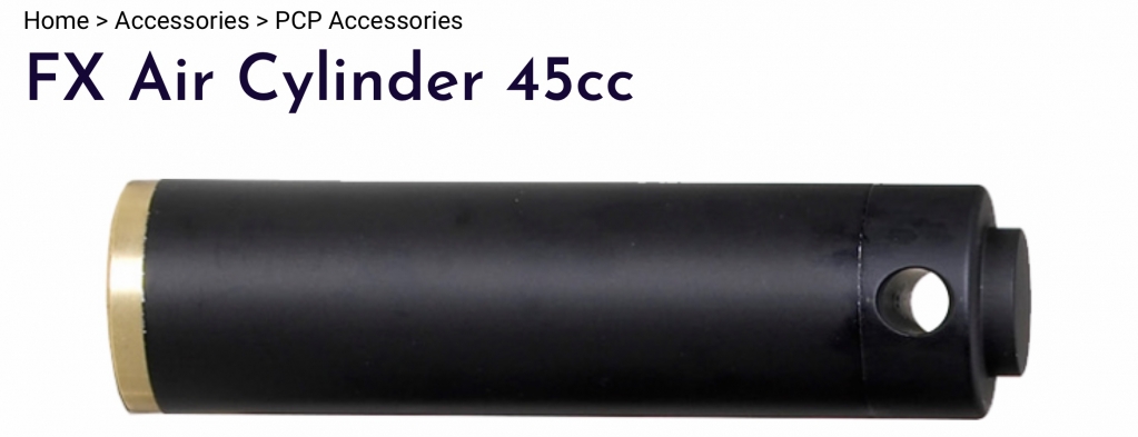

Here is the same piece as a complete air tube.
I like this ready made extension, and anodized to match the Impact's as well! This cylinder assembly is rated for 220 bar. Because the regulated pressure of this area of the Impact is usually under 170 bar it should be good to go.
Haha, yeah your going to have to shoot it sideways like the gangstas do. So much for bench shooting or you could also just plastic tie it to the factory air bottle, duh.

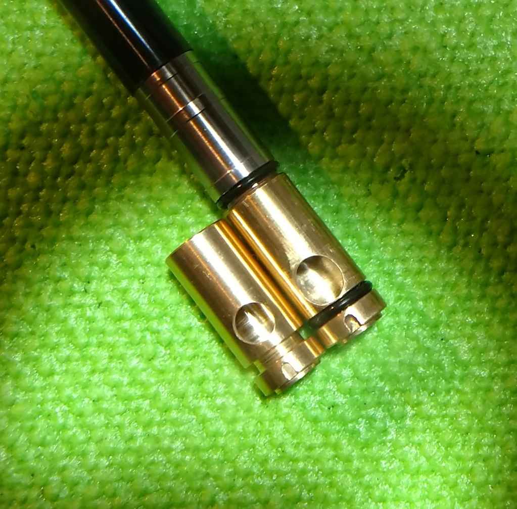

Here's the difference between a new probe and my gaping hole! I was going to change the thing out after testing my new mods, but decided to leave it in for now. People, don't go as wide on the hole, because the short slugs were dipping into the port with a half moon probe. (It works fine with the standard full circle probe pushing all around the skirt.)
