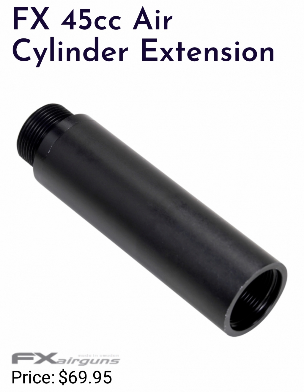

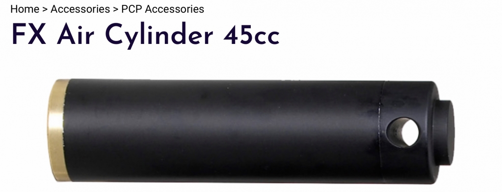

I made my own external plenum, hamer , valve seat, c3 ... and I made for some number of people to, but doing this has to have some rules and safety first.
It has to be measure test, presure test fiting test, leak test ...
I wanted Michal plenum, seams in that time good thing to have. I was thinking it will maybe have some issue but I ignore my skilful sence and get it.
Michal pay back the money ... no issue with that.
Since I had external and internal plenums ... I do know for sure that external plenum is somehow better to use ... cant explain but have much beter feeling with it cnowing its safe and properly made.
Gain from Michals plenum was not biger than I had with external 45cc ...

Arba naudodami išorinį plenerą, turite didesnį sriegio angą galiniame bloke?
jūs naudojate originalų siūlą? Does your external plein-air have the same thread as wika?
