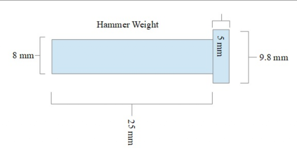

Here's a picture of said hammer weight if you have a friend who could machine one for you. The print of the hammer weight does not show the inside through hole that needs to be drilled between 3.5mm and 4mm. It seems that the 8mm dimension should 7.4mm, and the 5mm dimension was a bit thicker than need be for hammer spring preload. The outside diameter can be checked against the diameter of the spring and plastic spring guide that will be removed upon installation of the new brass weight.

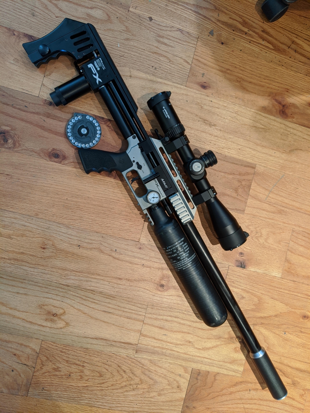

I have a theory, and I base this on evidence of my FX Impact MK2 .25, Cal 700 mm, using NSA 36.2 gr. slugs. When I got the MK in July I tuned it in for the Jumbo MK II JSB pellets, and it didn't take long before I was shooting with great accuracy... right around 915 FPS. Then came the slug liner, and from the get-go I had trouble tuning it in. But I will make a long story as short as I can. While FX had increased the capacity to move air, they did nothing for the hammer spring... it's the same hammer spring used on the old FX, the smaller calibers, etc... and that used to be fine. But, the slug liner creates more resistance, the slug has more surface area in contact, the slug does not squish, and the slug is heavier... all in all the amount or air to move this slug has dramatically increased as expected. What I found is there is a DP across the valve; one side is the regulator pressure, the other side is atmospheric. To open that valve, the hammer has to have enough velocity to overcome that DP on the valve. What I have found is to increase the regulator pressure you must also increase the hammer spring pressure; they go hand in hand. I can tell you with my impact, I am currently getting about 915 FPS with the hammer spring at .585 inches. The maximum I can go is .560 inches. So I don't have much room, nor do I want to sit on the tightest setting either. The current regulator pressure is 148 BAR. I walked that hammer spring from sloppy lose to .585, so I know that I only increased in speed... meaning that the valve did not open too much. Now I will tell you part II. Last week while trying to tune it in, I got some erratic behavior. I suspected too much hammer spring. At the end of the day I was at 165 BAR, with the hammer spring maxed out and only getting 400 FPS; I will re-type..not a typo... 4000 FPS. It was pitiful. The key came when I looked at the reservoir pressure. After 28 shots I only used 25 BAR. In other words, the valve was not opening very far, or for very long. The 165 Bar was too much pressure for the spring to overcome. It seems to me that the design of the MK2 failed in the strength of the hammer spring. Shooting slugs, or getting a slug liner should come with a beefier hammer spring.
Slugs do "squish" or they wouldn't pass through the choke. They're pure lead and soft.
4 grams of added hammer weight works well.
My setup..
.30 700mm slug liner
Elongated brass port and half pellet probe
6.35mm valve + 4 gram hammer weight, OEM spring
95cc total plenum space at 150 bar
50gr jsb 1072 fps, 66gr NSA 948 fps
These numbers were just testing. I haven't been to the range yet for tuning.

So what I'm getting is that I need to machine a small additional hammer weight (around 4 gr give or take). I actually asked a similar question in a forum overseas. Their answer is to replace the C3 bumper with a Delrin substitute... which will also have to be manufactured. I ordered a 8mm Delrin rod, and various sized drill bits in and around 3.13-3.5 mm based on feedback (no real clear answer on the hammer slide rod diameter). Their beef was the original o-ring is absorbing to much energy of the hammer spring. And to a point I get both jobs are probably necessary. And of course there are people who insist that a beefier spring is the answer. I've read that adding mass will increase the dwell time, but has no effect on the valve cracking. And a beefier spring will crack the valve better, but does nothing for the dwell time. I'm an engineer, unfortunately an electrical, and that does zip here, but I do understand the principles in play. However, we are dealing with many variables, many of which are completely unknown.. such as the friction, accuracies, etc... so I think it will boil down to a little experimentation of added mass, a more robust and better transfer of energy bumper, and possibly a beefier spring.

I'm thinking that I need to get in the gun and change out the C3 bumper, and put in a heavier spring, and maybe some mass as well; the mass however is dicey. I see trouble on keeping it snug. If it comes loose from the hammer, I see trouble.

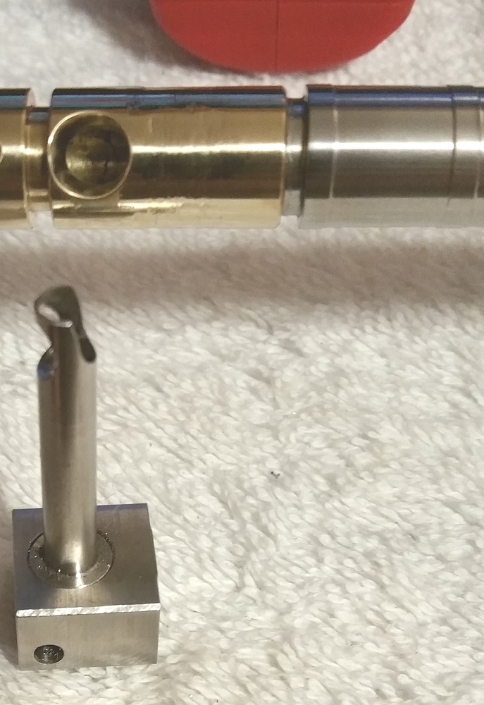

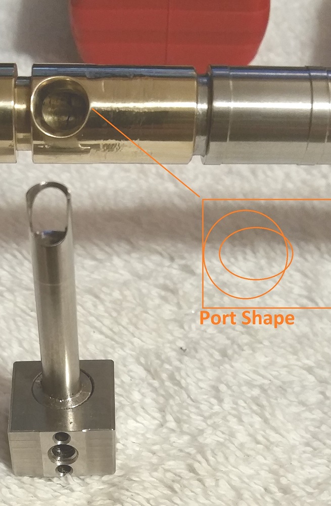

A brass hammer weight replaces the plastic spring guide inside the hammer and is captured between the spring and hammer. It can never come loose. You can make it yourself by drilling a piece of brass rod to 3.5mm (5/32" will work) then chuck it in a drill and cut the OD with a file to fit inside the spring leaving a flange on one end like a nail head equal to the spring OD. Around 4 grams works well. If you have a 5.5mm valve seat you can drill it to 6mm (15/64"). Do a little port work on your brass inlet and probe. Do not make the brass port any wider, just elongate it and flare the entrance enough to cover the 7mm port that feeds it. Pellet and slug feeding remains the same as OEM.
Heavy Impact.... OK.. now I see the bigger picture. Duhh. Once you see it makes sense. You are replacing the spring guide with a brass spring guide, and because it has a flanged head it gets propelled too.
As far as the port... I don't think I'm brave enough to start drilling into existing material. The FX is literally weeks old, and as you can see I'm not yet up to speed with you AGN guys.

The head on a brass hammer weight acts as a spacer for extra spring preload. The pellet probe and brass port are available from FX USA for about $50 if you ever wanted the gun to be in original condition again. Modifying those two parts are the key to power.

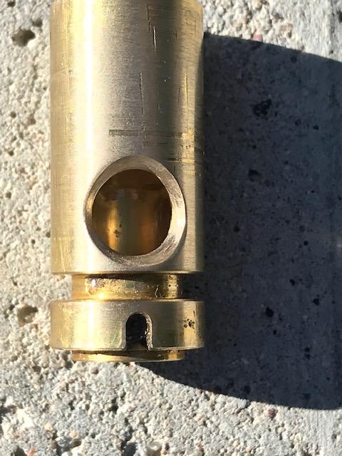

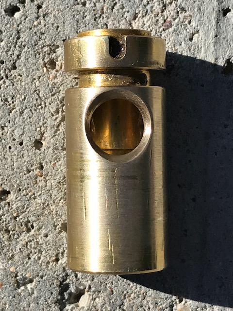

I elongated my 30cal brass port yesterday. I think it turned out pretty good going very slow with a dremel. Really didn't see much of a increase in speed but I think the hole in the 30 is near full bore already. Also modified the probe that I had double ported to a single port with the top half removed (thanks Edosan). Currently with the 6.48mm VS with these two mods at 160bar and the stem limiter at would be at a 5th line its running 1010-1015fps. Back on the 4th line abut 995-1000. It actually shoots really well at that velocity. Hoping to do some coyote hunting in the near future with it.

Heavy Impact... My guess is this is what you had in mind. The cost is reasonable given I really don't have a lathe, and by hand I don't think I could do as well. So I just ordered it . About $40 + shipping/taxes. I found on Ebay By next week, the squirrels had better be focused 💀. Thanks again. By the way I did watch some videos on enlargening the that brass port and pellet probe. Doesn't seem hard as I first thought.
That's a really high price but it will work.

Barrel 700MM
Wheel always on MAX
Regulator is at 160 BAR
HS is at 0.60
VS is at .355 on the flange (There is a small flange in front of the FX body, it is more accurate to measure from there)
Average FPS = 928 FPS
I shoot at 30 yards (my range) and I'm grouping about .25" The pellets were better (scary good) in the pellet liner, but I'm committed to the slug MO.

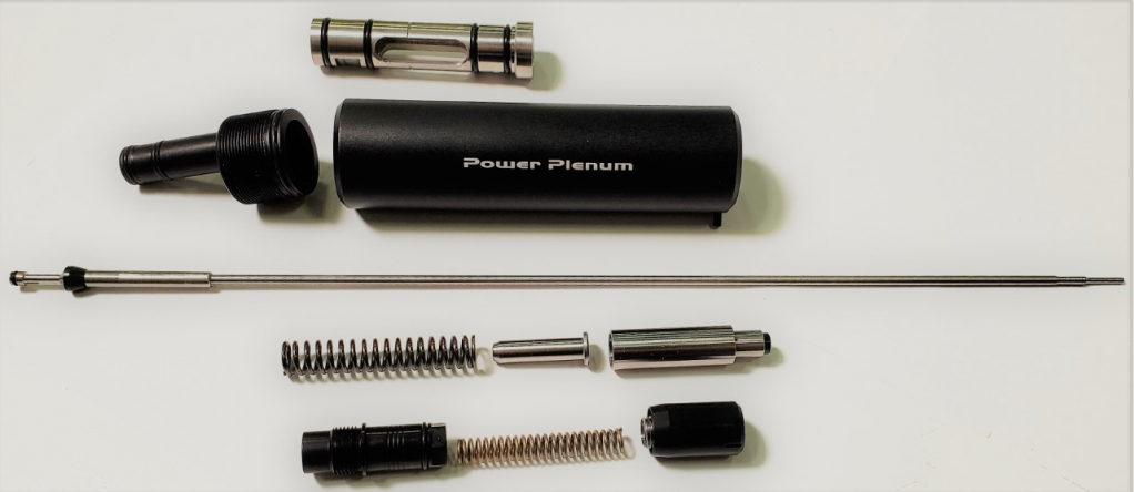

I'm going to go for the power plenum anyway. Kinda got screwed on the 'upgrade'. My gun was upgraded and after all the back and forth finished on 10/17. The cutoff for $100 upgrades is 10/30. :(
