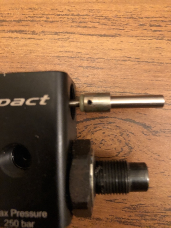

I finally found some time to mess around with seeing if I could fix this gun again. The leak that appeared after disassembling the gun came from the brass adapter shown in the photo below. I just had to unscrew that and sure enough the o-ring was cracked and looked quite smushed.
