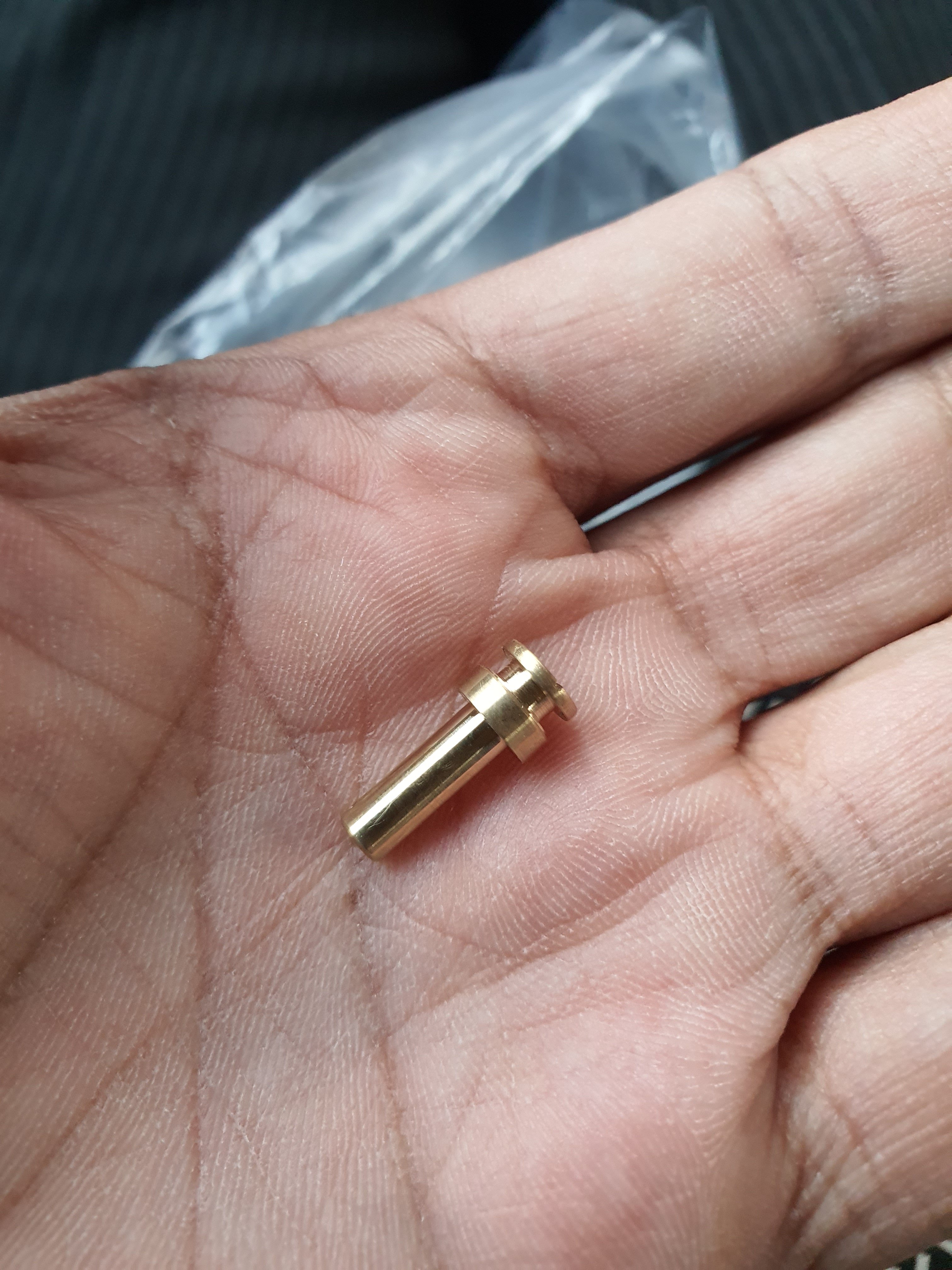

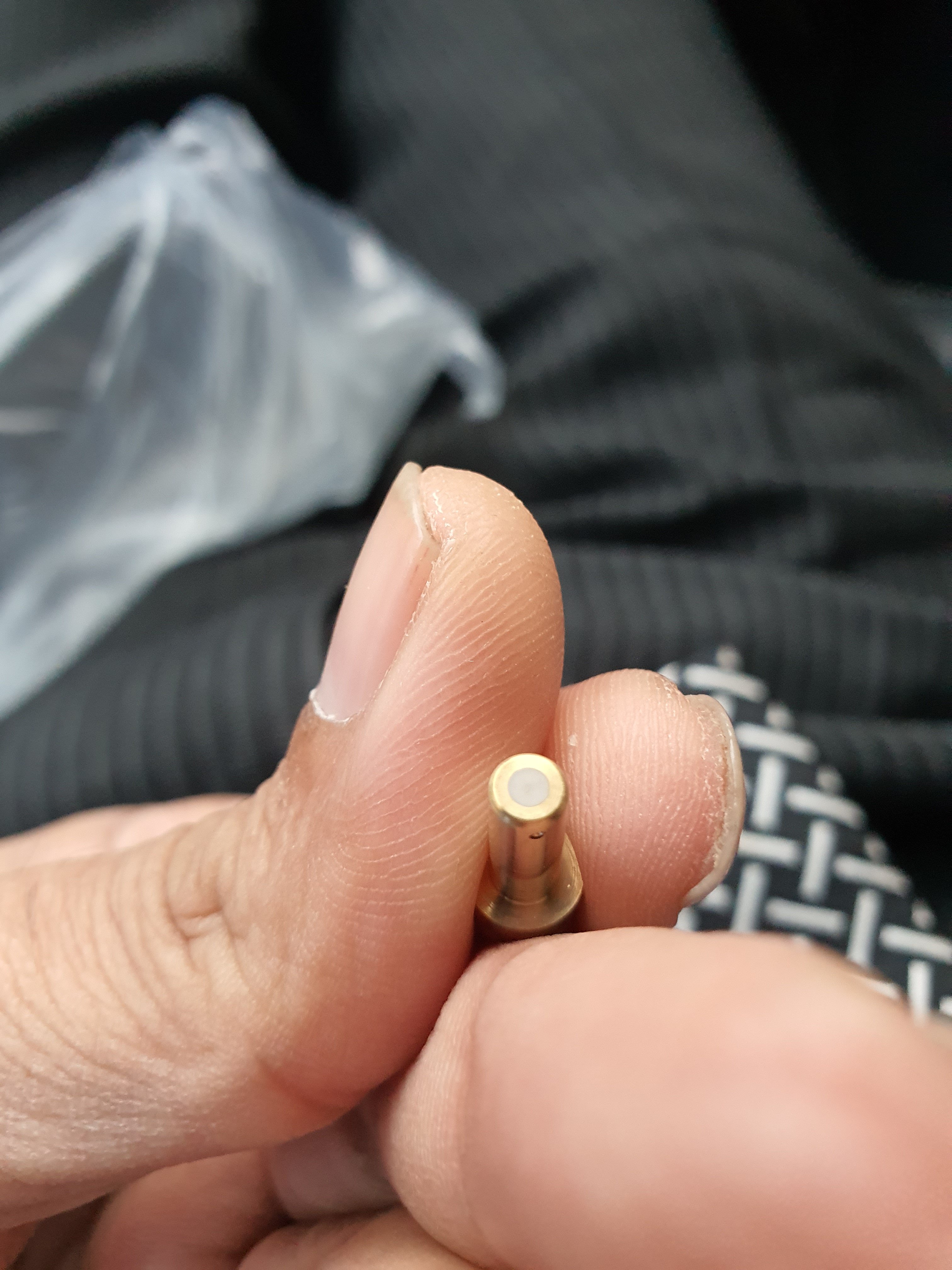

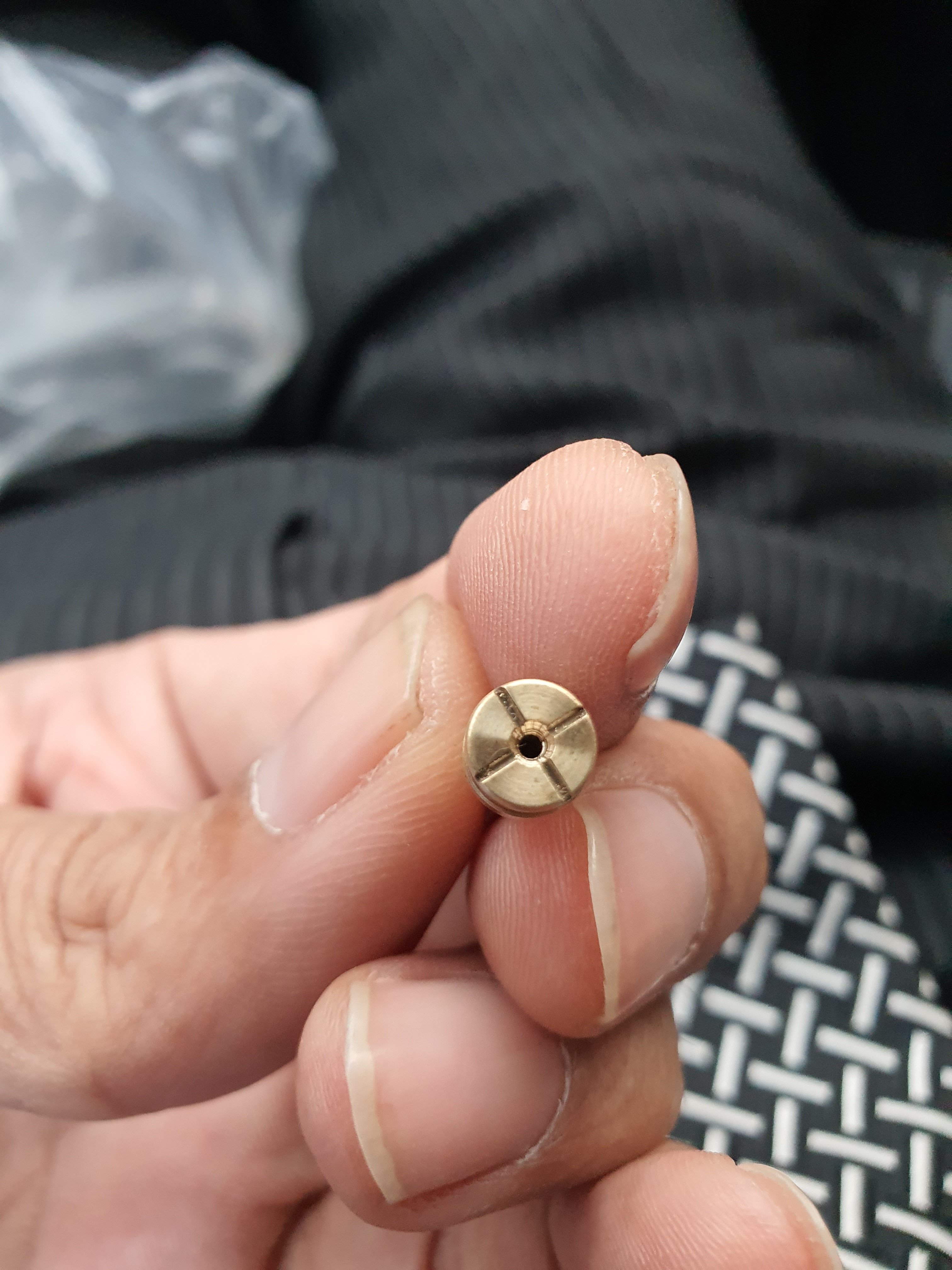

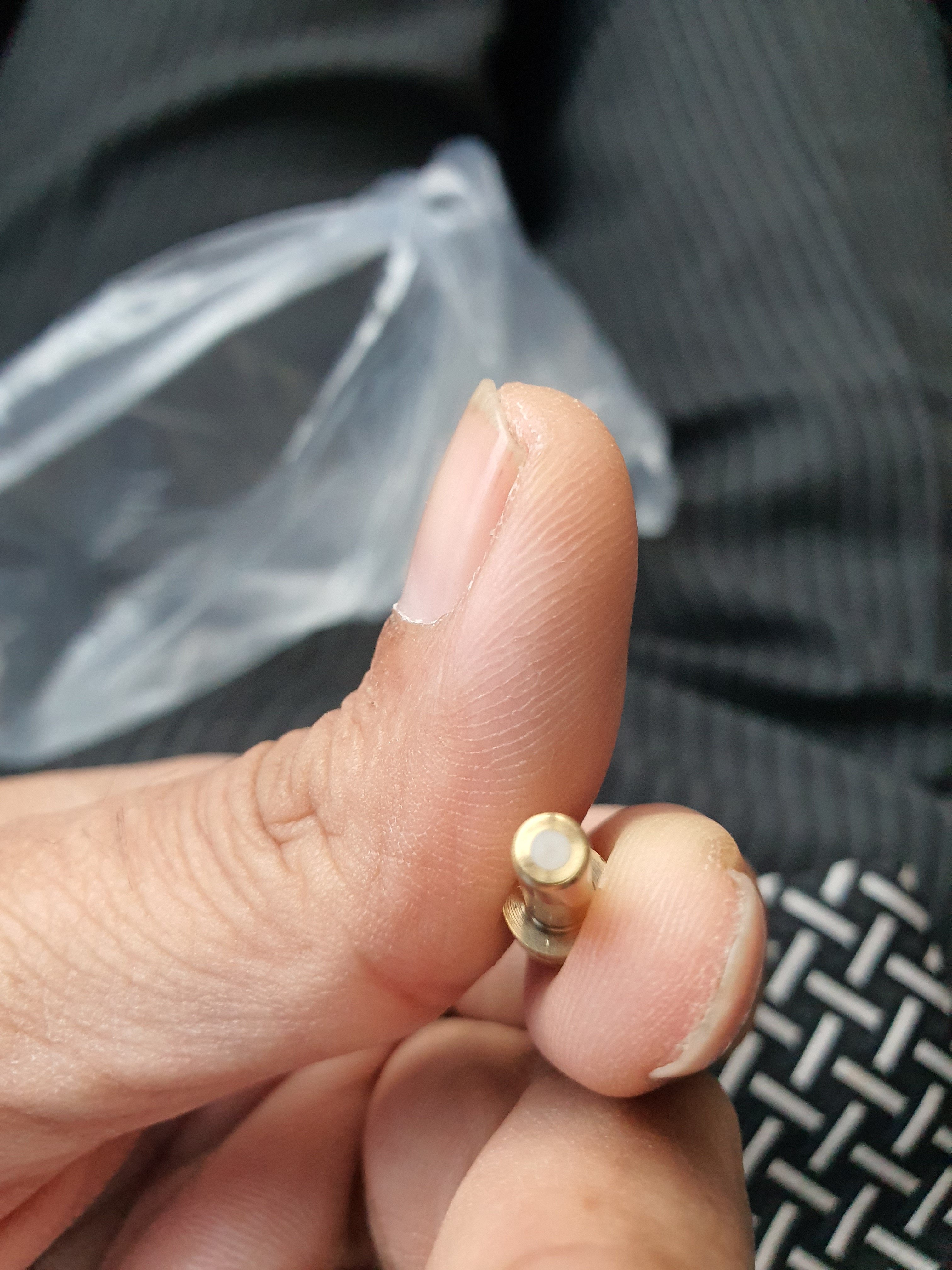

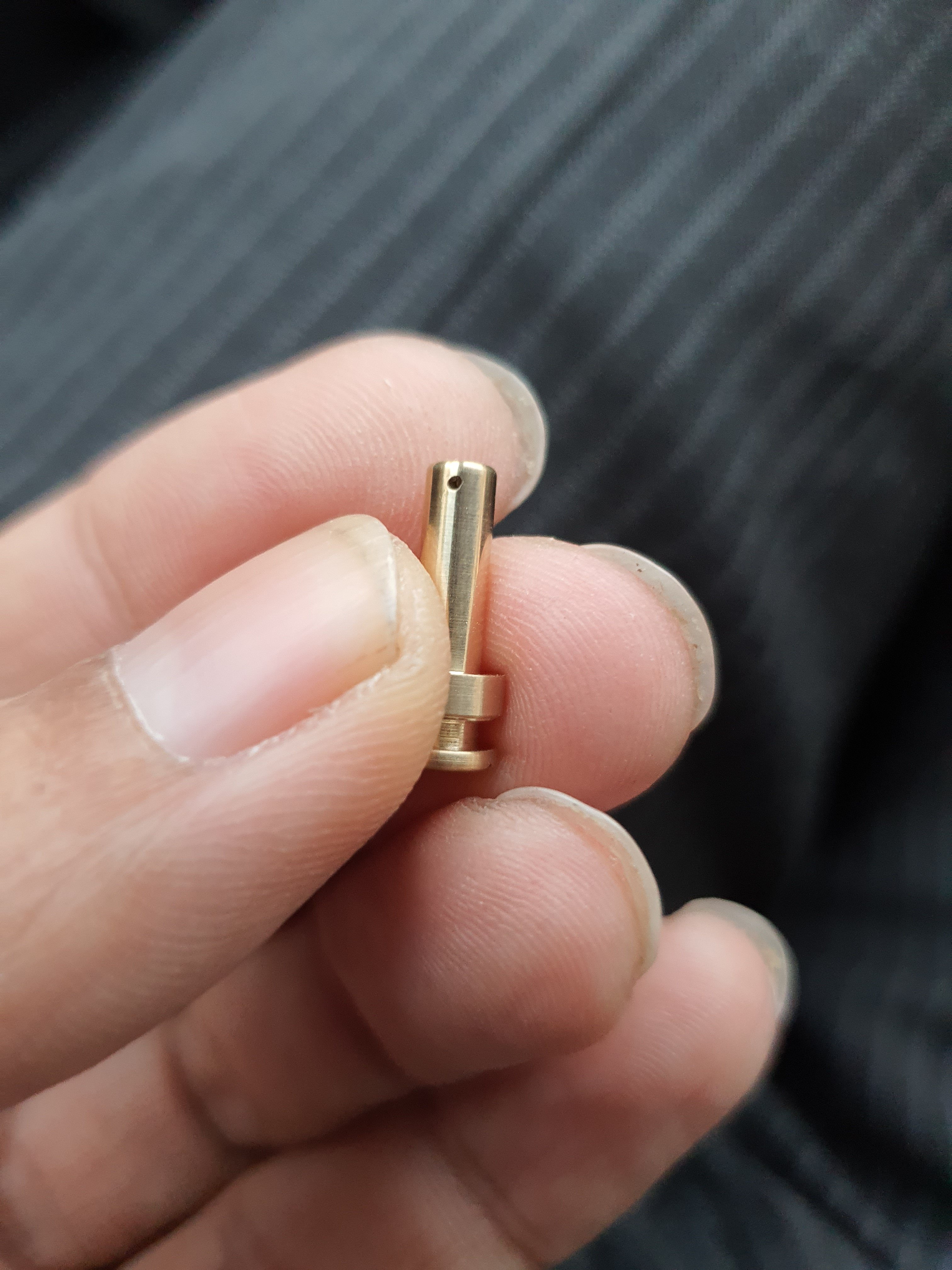

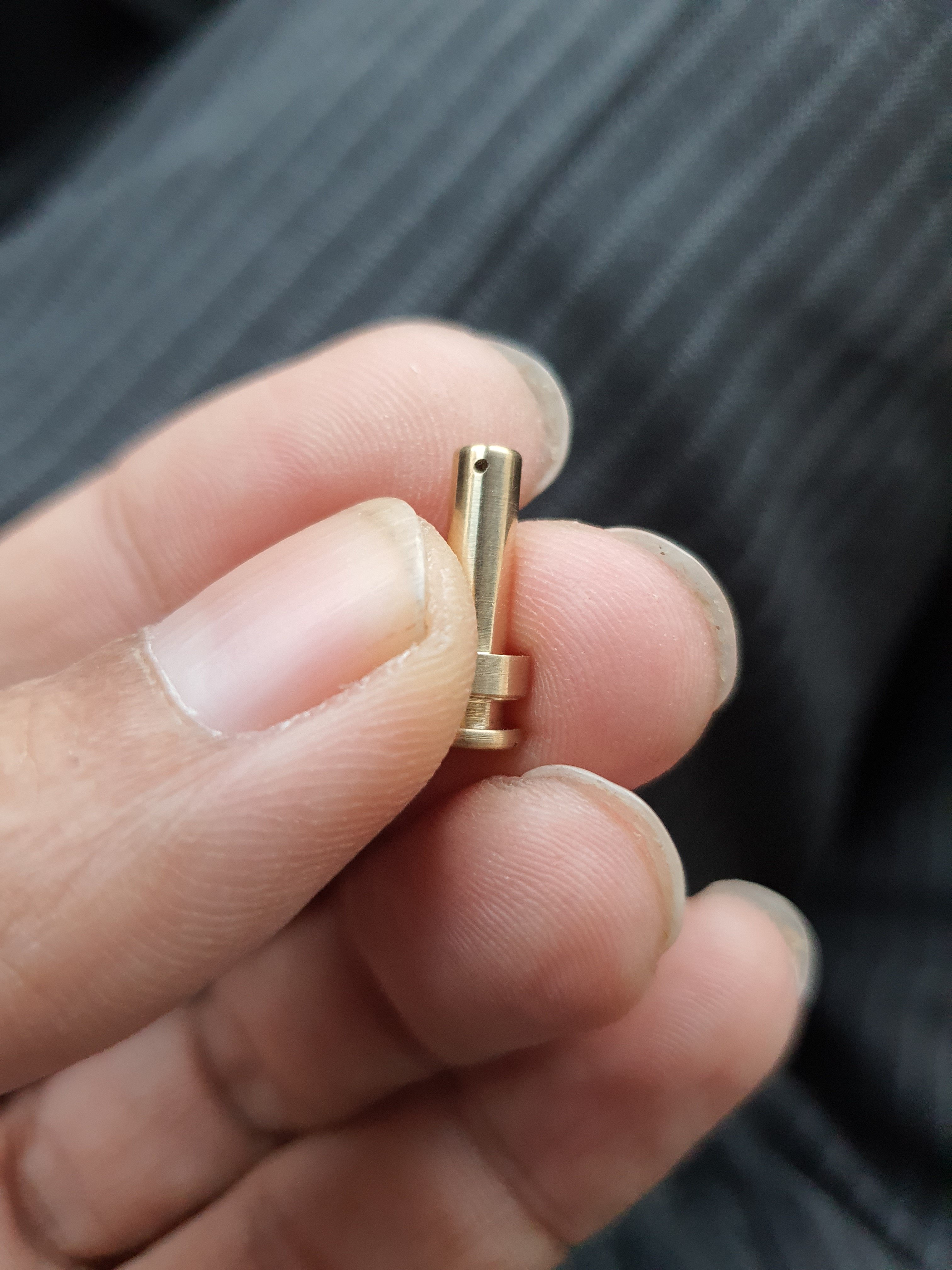

As FX moved to brass piston bodies for regulator, I also made a couple but with peek seat.

Yes the brass pistons offered by FX have a bit bigger air hole. That may help quicker recovery of regulators.

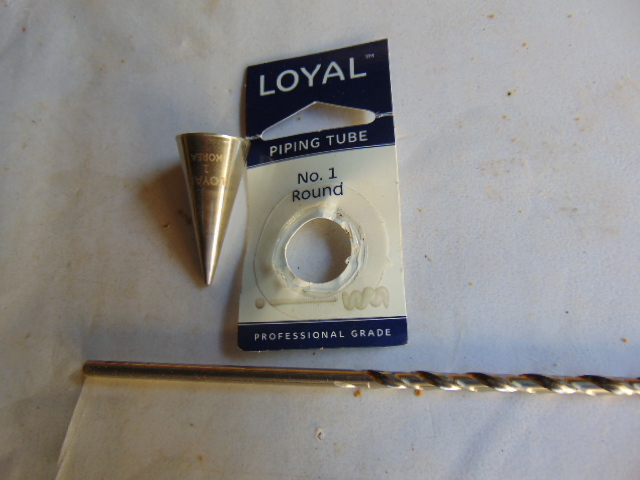

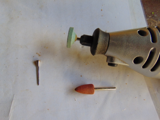

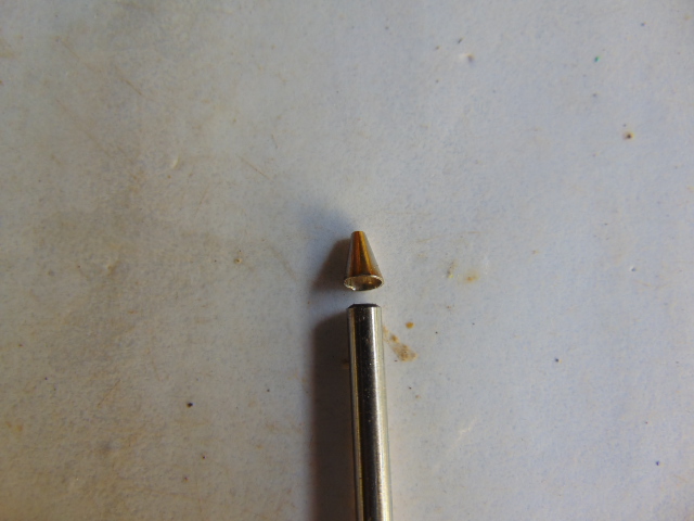

The cone is a chrome cake icing tube called a piping tube. There are numerous small plastic bottle tips that would also work and be easier to build but I liked the chrome for less friction. I used a Dremel for all the cutting, grinding and deburring work as per the photos. I left the cone slightly longer and put a chamfer on it. I put a nail into it to hold it to get exact cut lines.

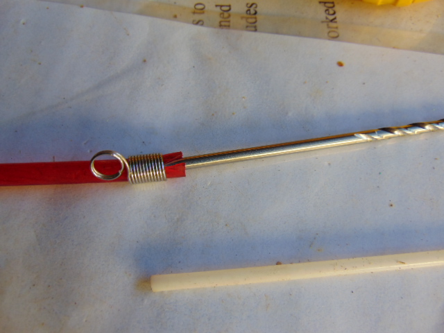

The piston is sometimes difficult to remove as it has a tight O ring around it. As Mubhaur said the piston shaft OD is 4mm so I used a new 4mm drill bit as a gauge. I used some very soft plastic. I think it was once speaker cable. I cut a slot in the end. Basically you push it onto the piston shaft then turn the spring to lock it on. It grips very well because the inside of the cable is fluted. For putting it back I do not think I need a push rod but just in case I will get some dowel and glue a rubber tip to it.

I just completed an install of a brand new, current, AMP reg on a members impact. 16mm piston and 10mm 11 stack washers. The new brass pistons #19696M had the delrin seals at the tips now flush like Mubhaur’s version, and the reg bodies have 3 air passage ports on the threaded lower half of the reg body.
Previous piston tips when they first came out protruded out from the piston tops. Nice that FX flushed them out
