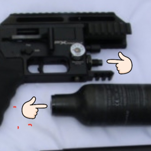

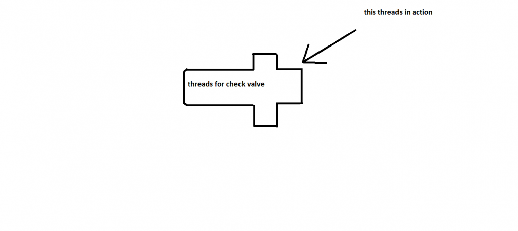

Can someone with a FX impact could tell me or measure for me .the threads on the gun where you screw in your bottle. Looking this info for a new built.

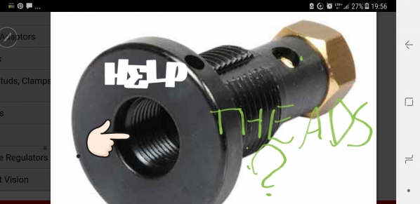

The bottle threads are m18x1.5. I am looking for the inside threads of the valves bottles that screws into the gun.
Id like to use a fx bottle so i can make my new built has a take down rifle.

So the thread pitch is 1.00 mm I measured from the adapter hole as it was asked in the picture very above.
