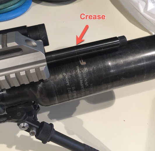

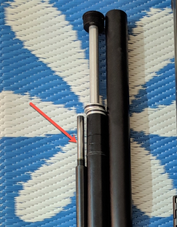

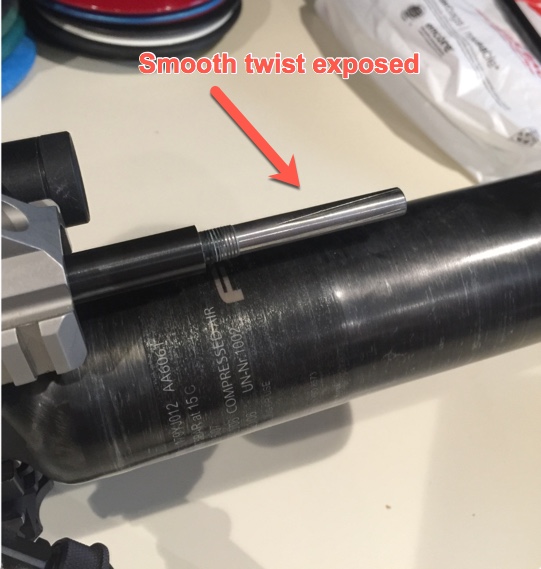

Ok problem solved. I've heard of this come up a few times but now I can see what's happening. A customer sent me a few pictures and I'll list them below to document for future people.
I didn't know there are two pieces to the barrel.
If you take off your shroud and you see the smooth twist part, put some red loctite on the threads and screw it back into the shroud. Leave it over night before attempting to remove the shroud again.
