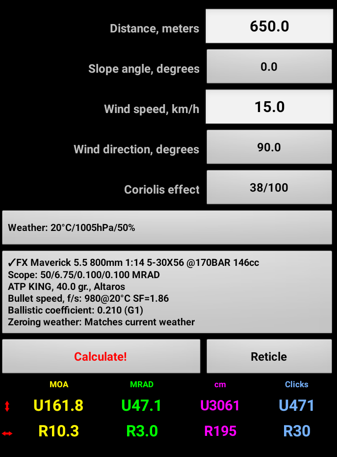

Have you done doppler testing for those slugs? Since altaros says its 0.21bc at 250m/s and I assume its the highest BC value with most optimal speed they put out. I wonder what the actual BC value is at 1000fps range?
I test the bc by shooting at different ranges from 60 yard up to 400 yard and validate the drop, the 32.3 altaros says its 0.18 but find it to be 0.17 on my gun at 975fps however the 40gr at 900fps it actually spot on with the given BC

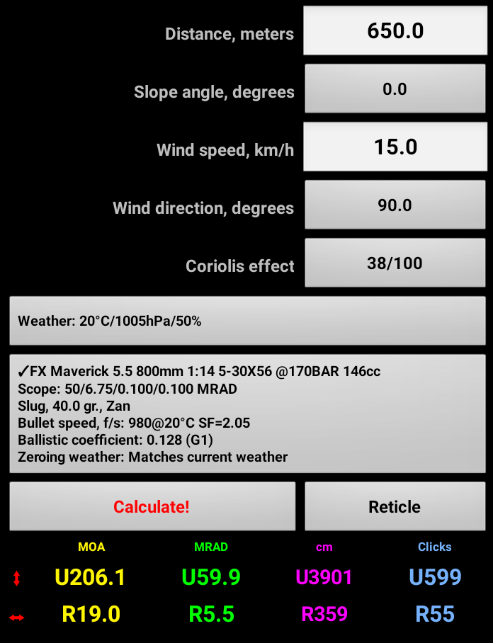

By the way if you have the means and the scope set up try it a bit further, when i get some i will try to extend a bit since i maxed out at 600yds with 40gr Zans (whithout loosing 50m zero or using range extenders). The previous had a BC of 0.128 G1
I am using a 32mrad elevation optic plus 10mrad stadia wich should by my calculations let extend the range in theory to 700-750yds (although what i really want to find is how bad an angle will the projectile impact and how big a group i will make.

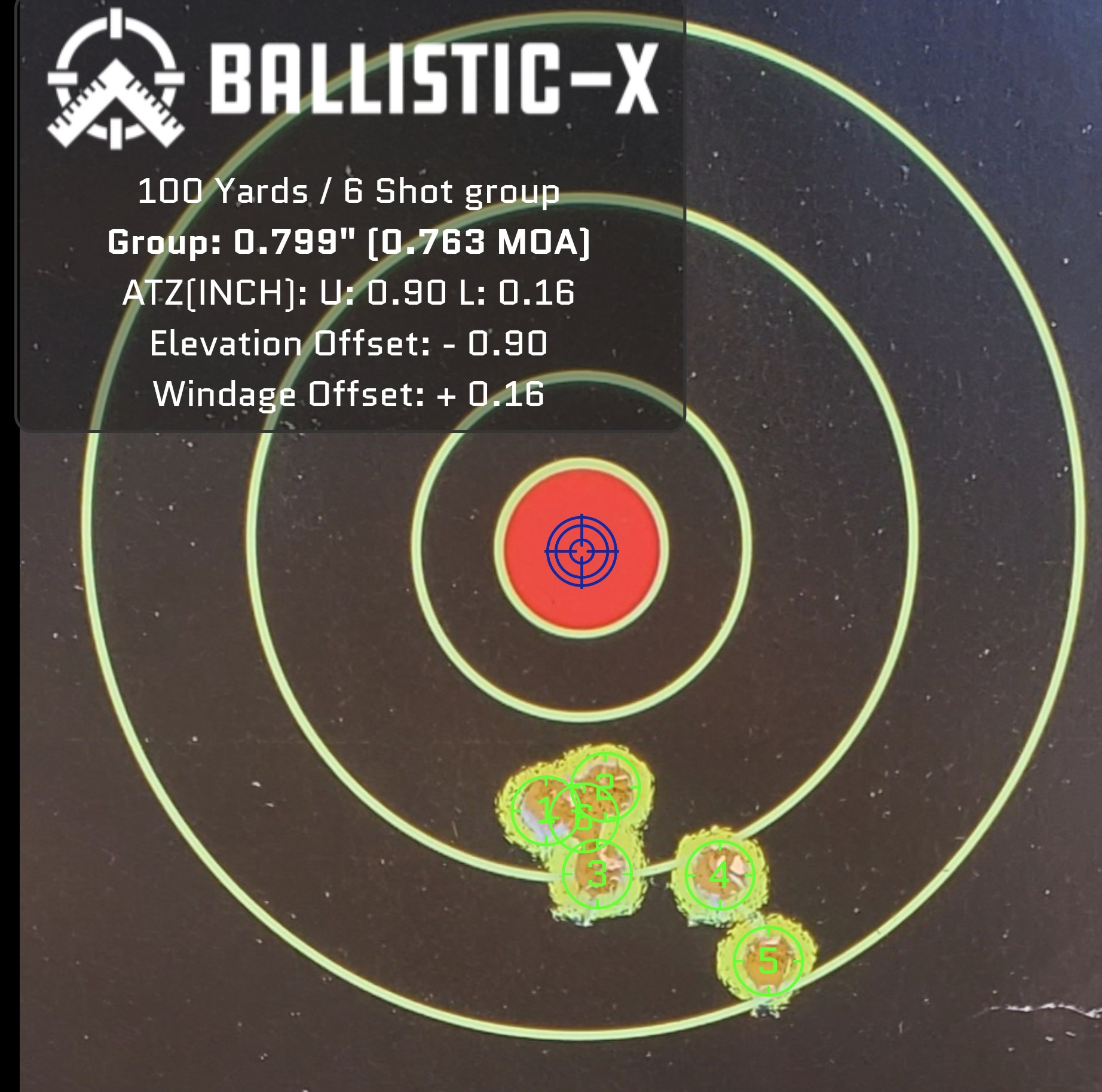

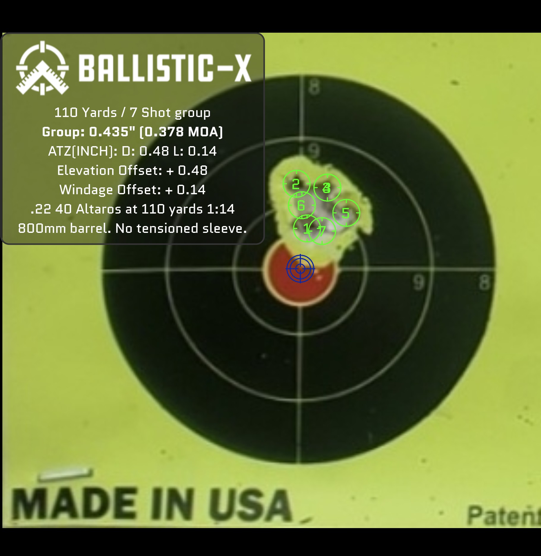

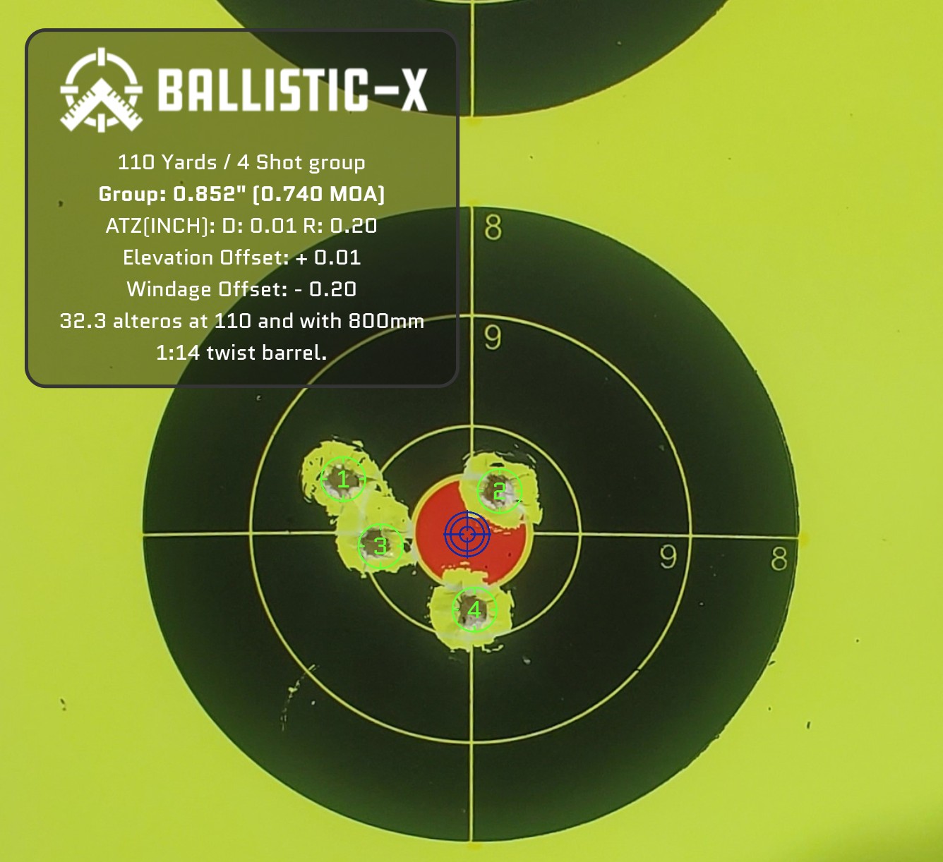

Well today I went to the range with almost 2 boxes of prepared Altaros slugs. This weekend I clean the 1:14 and the 1:18 800mm barrels as well as clean and lube the slugs. I just put a box on a clean paper towel sprayed with lemon pledge, rolled them around and transferred to a dry towel and rolled around a let dry. I installed the 1/14 800mm barrel onto my mostly stock mk2. Shot it up to 30 yards at the house for a speed that gave me a decent group. I settled on 950fps figuring I could always slow it down. I probably should have started higher.

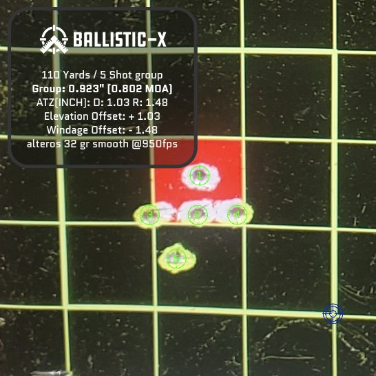

The groups were decent and tightest 5 was .802 MOA
Actually 0.74 MOA.

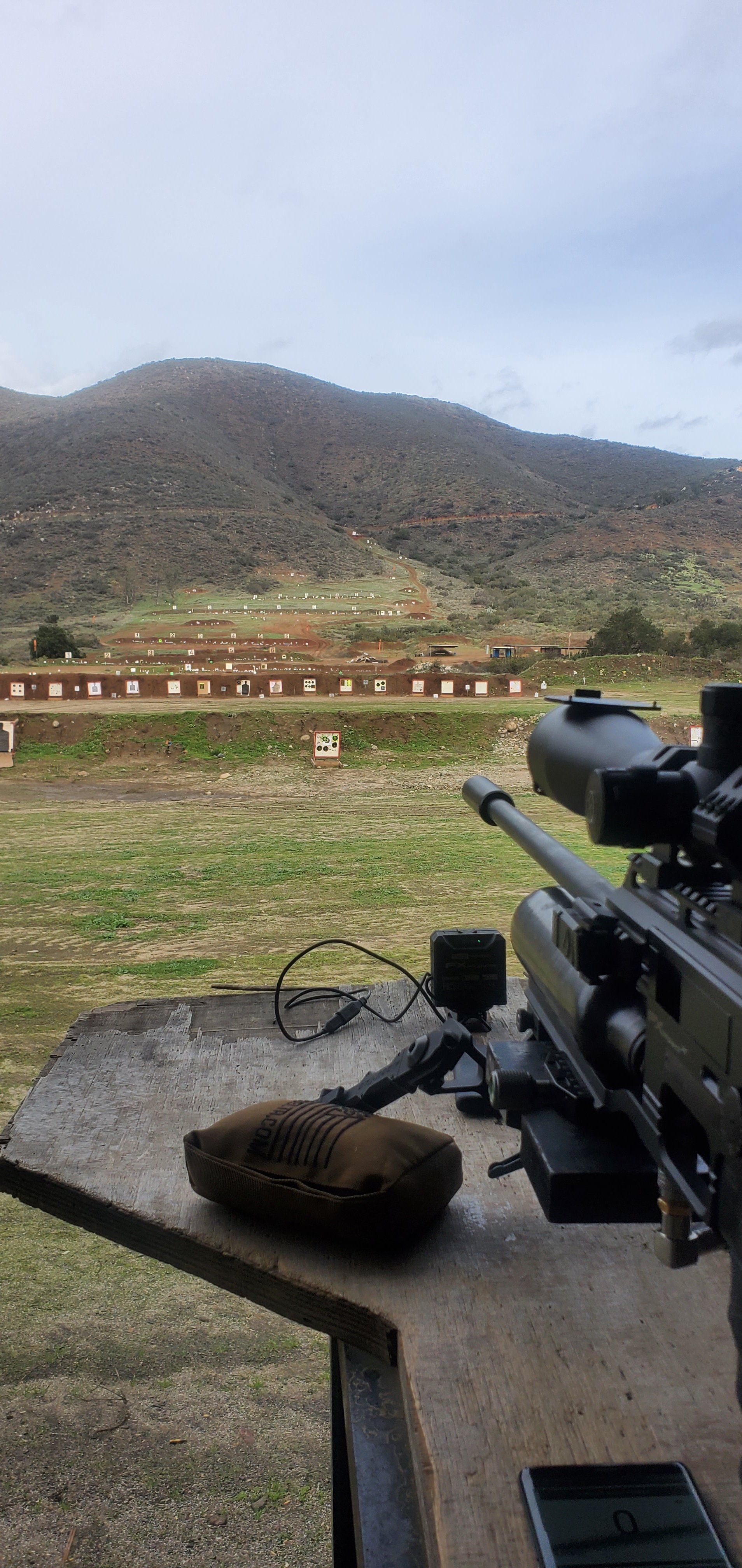

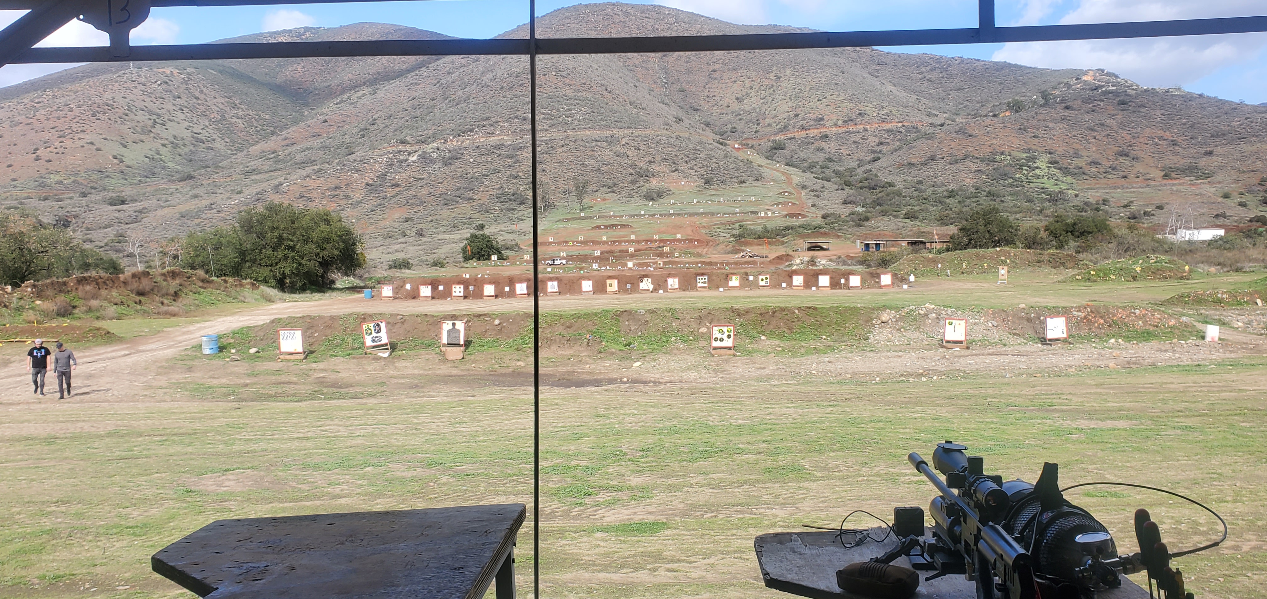

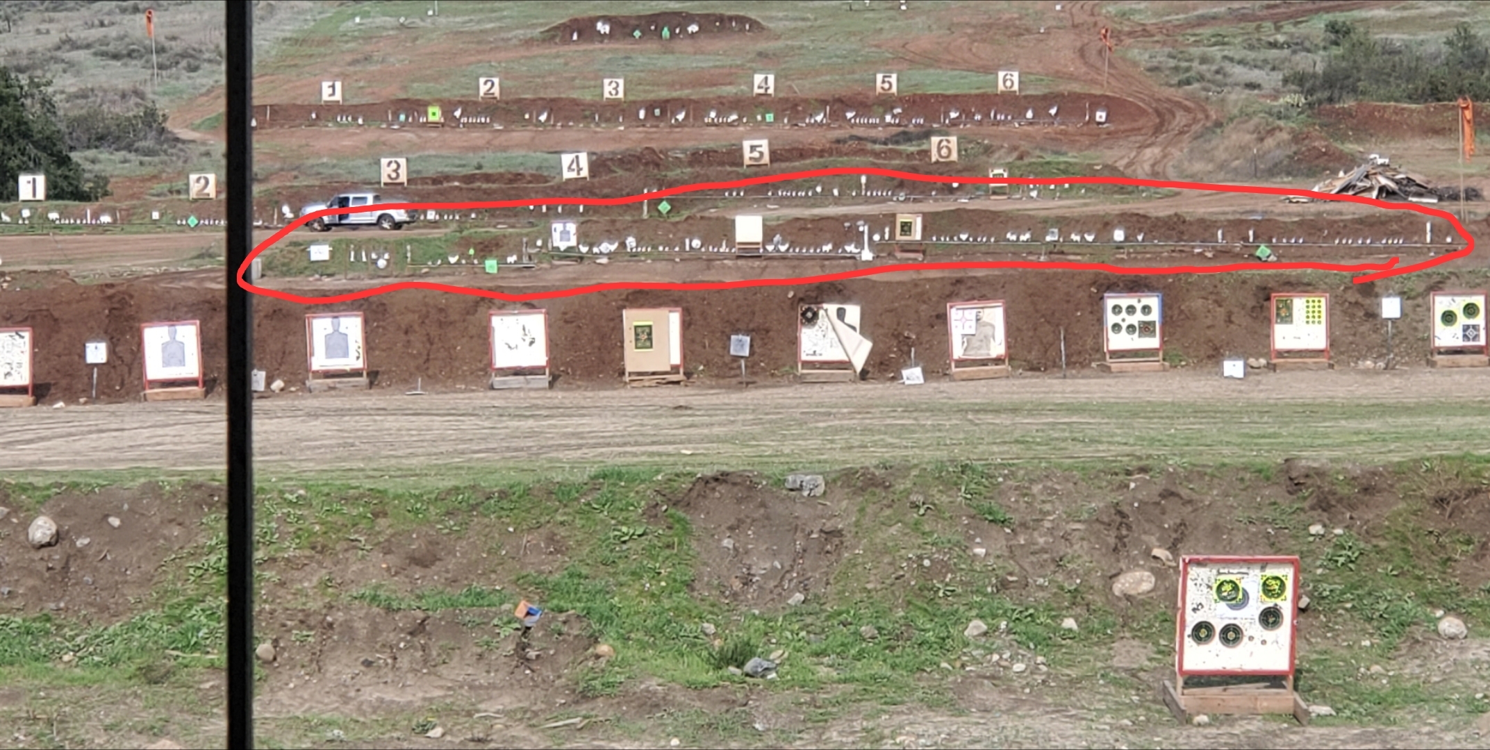

At 200 yard it got bigger. I was shooting the little bunny silhouettes that were about the size of a soda can. The groups at 200 were about the size of two soda cans. I knock about all the bunnys at the 200 yard line. i wanted to go to 300 but i realized i did not have adjustable scope rings on this setup.
This is the 200 yard line where the bunnys are. 300 is where that truck is.

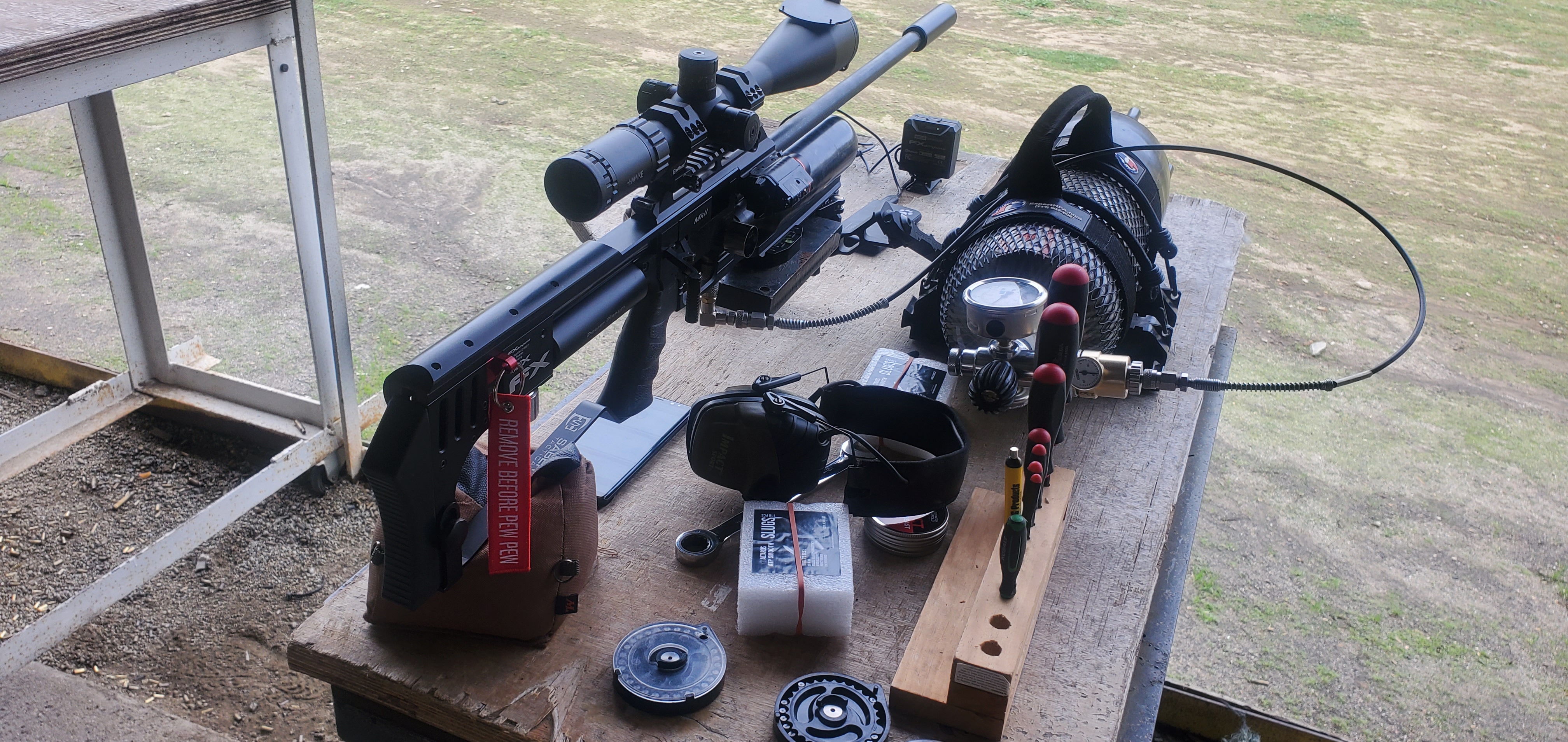

I had the airgun tethered so I would not go too low on pressure unfortunately I shut the valve off each time the firing line was called. Of course I forgot to turn ot back on almost every time lol.

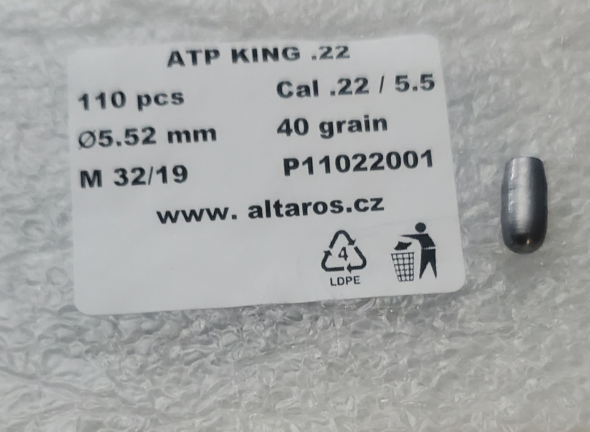

Ammunitions: ATP King .22 40 grain, dieamter 5.50mm ( .2165 ) - CNC turned lead slugs More information about Altaros ATP King: https://www.militaryairgun.com/domu/184-atp-king-550mm-22.html
