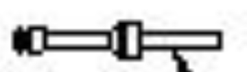

I only say that as the picture on the pdf shows the valve pin as having a 2 part section (o ring & metal perhaps) where it was a 1 piece derlin/acetal part before (below).
