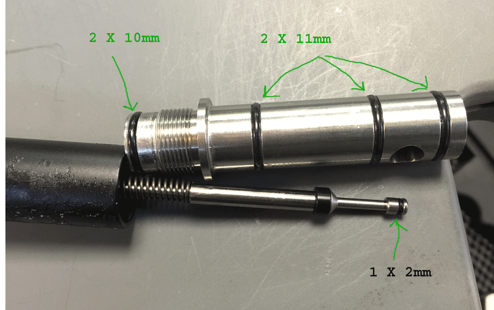

I agree with Heavy. I just had a problem that sounded exactly the same. I took my gun apart 3 times, changed the or o-rings and the problem persisted. I ended up sending in my Impact and it was the valve/valve housing. I would start by looking at the o-rings on the outside of the valve housing(4), then check the valve itself for a crack or bad o-ring. If you don’t find anything there, check the valve tube(plenum). These are good places to start your search.

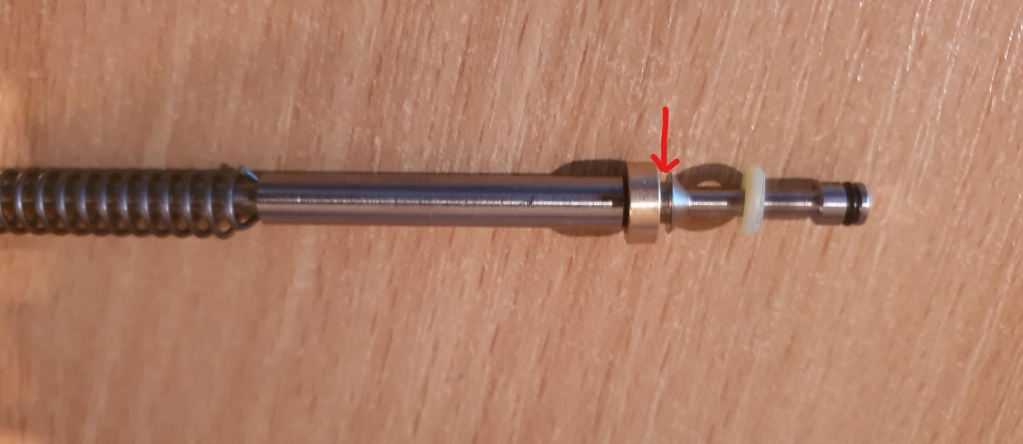

So I've started to strip my Impact down to try and figure out where the leak was coming from and found this when I removed the valve pin / valve stem which doesn't look right so can someone tell me if it is right and if there's suppose to be a gap where I've arrowed (red) or is the white o ring suppose to sit there? If the o ring doesn't sit there where's it come from?

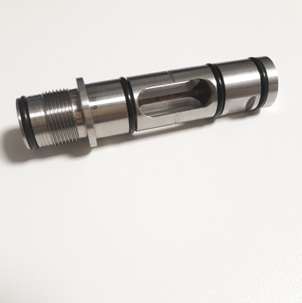

Mine's the top picture and the bottom picture's off Ernest's website of another valve pin / valve stem which looks different to mine.
You have a defective valve stem assembly. Call FX and tell them the symptoms, and what you found, email the picture to them as well. They should send you a new valve stem assembly at that point. BTW, you have the updated valve housing. On another note, take a closer look at the valve seat. It may be dented and marked up from the valve stem assembly rod failure, so you may nee another valve seat as well.
