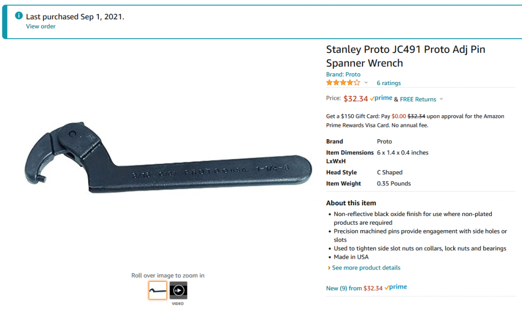

Is there a tool available to remove the 400 Bottle end cap ? Spanner type wrench with pin also best way to secure the bottle since some force probably required.
I could only find a home made one in a video. FX USA does not have tools.
Best option if you are in the USA
Stanley Proto JC491 Proto Adj Pin Spanner Wrench
