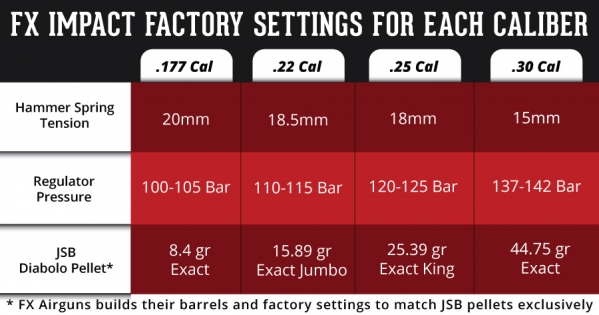

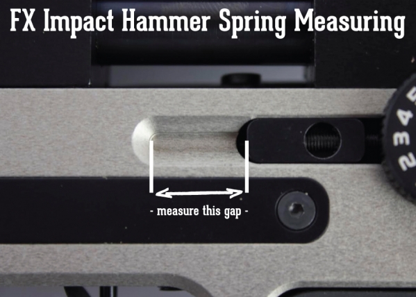

I tried moving the barrel, but there was not too much play and the fps remained the same. frank320, you may want to play with the hammer adjustment screw behind the power wheel. At max, my adjustment is about 17.10 mm and at power level 5, 4 etc. it will increase the distance

I tried moving the barrel, but there was not too much play and the fps remained the same. frank320, you may want to play with the hammer adjustment screw behind the power wheel. At max, my adjustment is about 1710 mm and at power level 5, 4 etc. it will increase the distance
Funshine, I was totally thrown for a sec when I read 1710mm (17.1 cm)...What!!?? and I started thinking "now wait just a second here...Funshine's FX has got a helluva lot more adjustment than I do!...I've been shorted!" ;)
