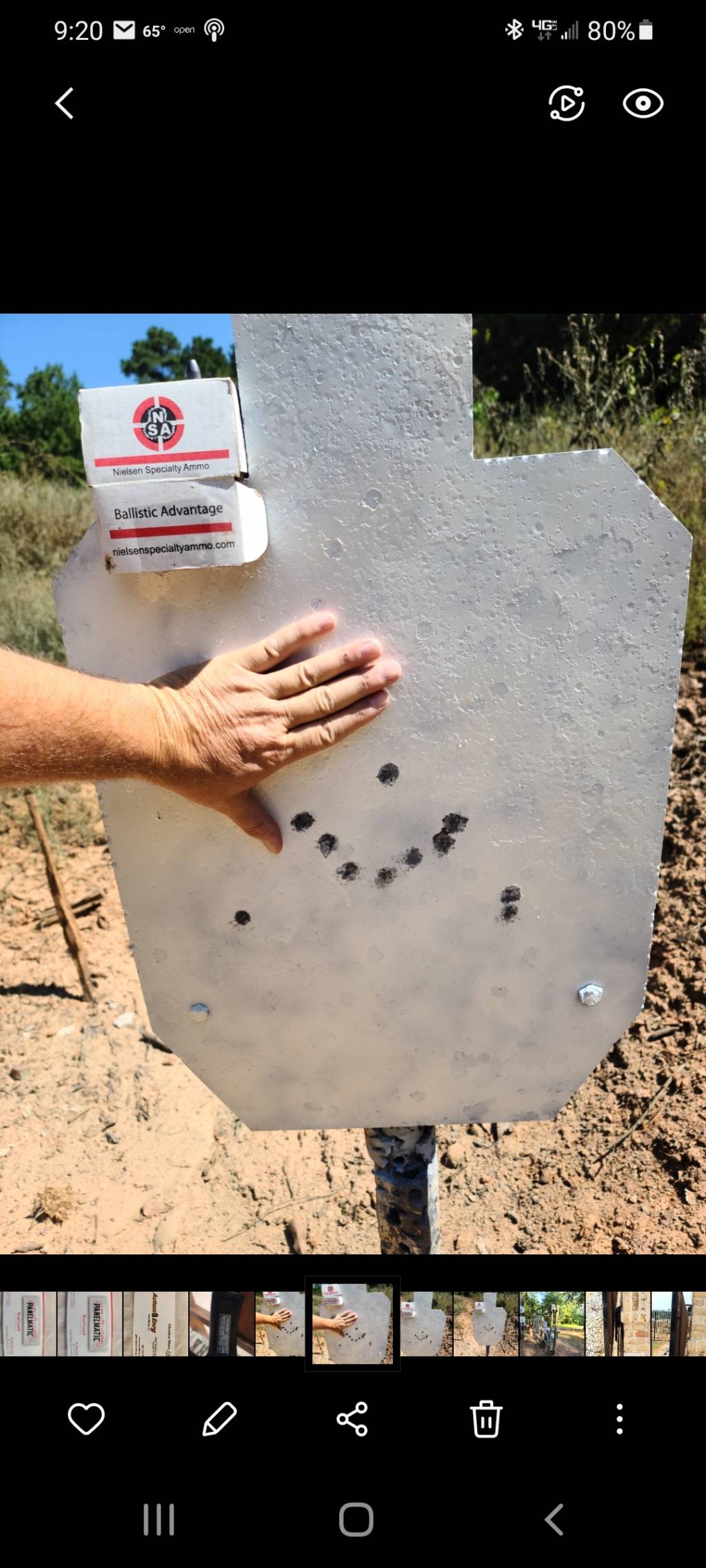

Group @ 200 Yards
Nielsen .357 caliber 93 grain at 865 fps reg set to160 bar FX gage +/-. Nielsen Specialty has three different sizes be sure to use the .357 size.
