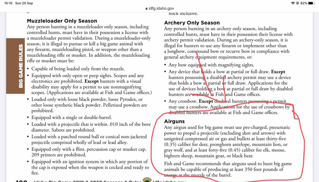

I am not a big game hunter though, though i am thinking about doing with an air rifle when I go home next time to Idaho. I have an FX Impact MKII chambered right now in 22, but I know I can upgrade to 35 cal. It will take some upgrades, but it can happens. However, Idaho has pretty strict minimum limits on the and the FX Impact even in 35 cal aren’t even close to meeting the minimum power needed of 350 ft/lbs at the muzzle.

I know air gunners in Idaho and other states have lobbied for years to hunt with high power / big bore air rifles, and making ground, so maybe go for something with more punch if you want to go big game with an air gun.
