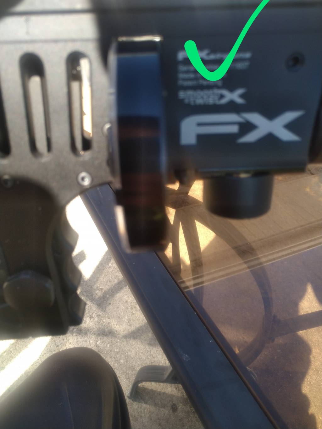

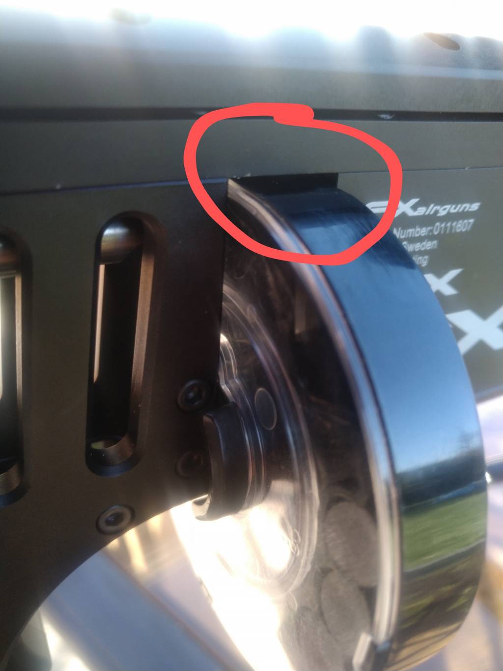

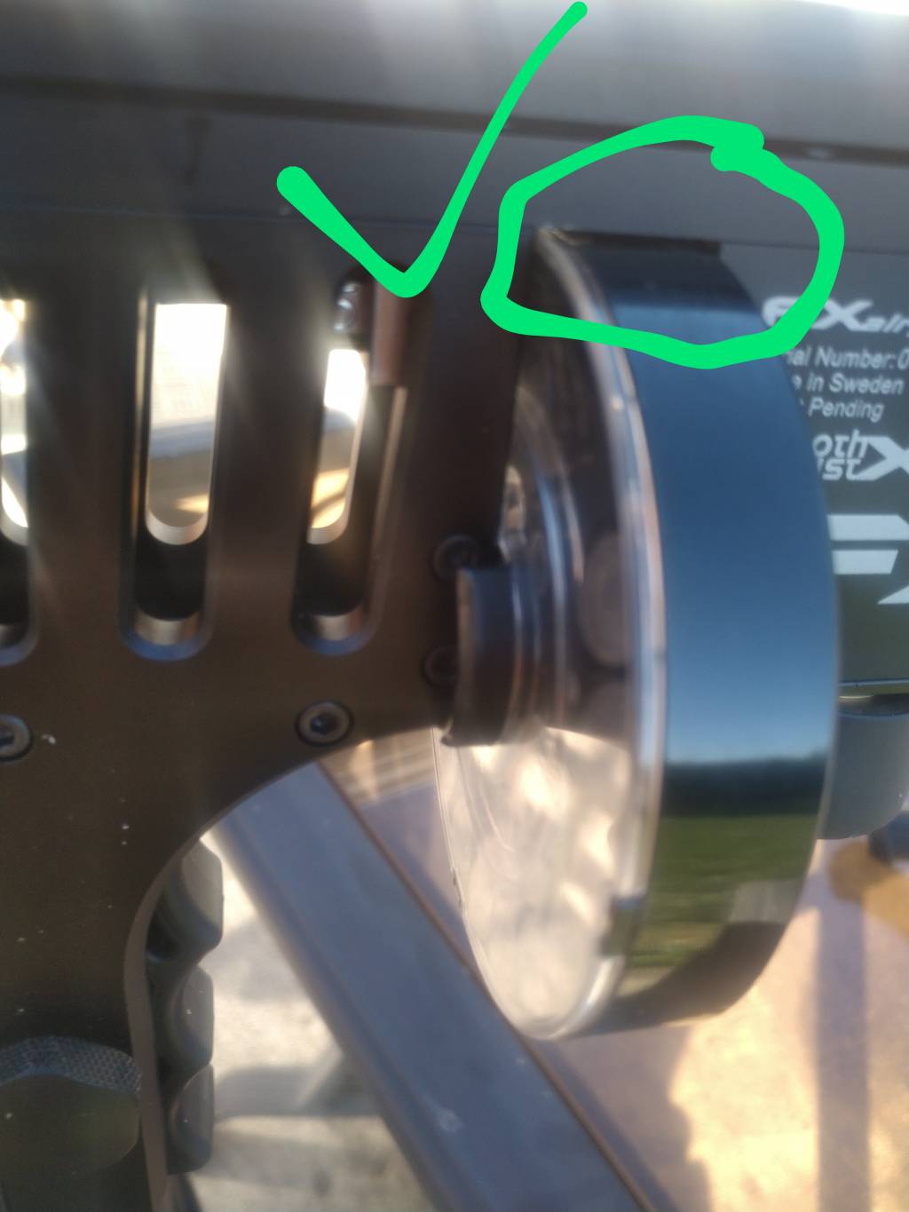

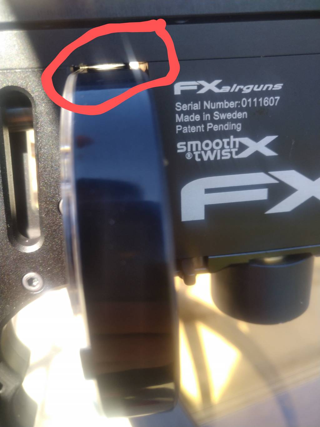

Here are still pictures. It's pretty hard to tell but the magazine goes DOWN when I cycle the sidelever back. The red circles represent what it looks like when I cant get the probe forward. The green is what it looks like when its in the right position and is cocked and loaded. Here's a 15s second videolink on youtube where you can kind of see the magazine fall down when I pull the sidelever all the way back. What's easier to see ia the correction of when we push it up I can get the probe back through the next pellet

This is well said better than I could say it. I am uploading pictures of the issue. Its kind of hard to tell from still pics so will also have a 40 ish second video link to youtube....
Uploaded pictures and a youtube link in the original post. Pictures are kind of hard to tell but I think the short 40 second video explains it all as you can see the magazine drop as soon as the pellet probe goes all the way back and the magazine rotates to the next pellet. This happens every single time the magazine is full. If about 6ish pellets have already been fired, it stops happening so weight seems to be the issue.
