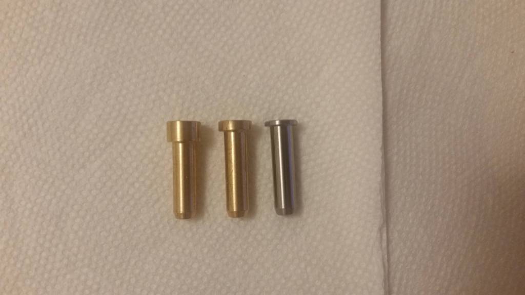

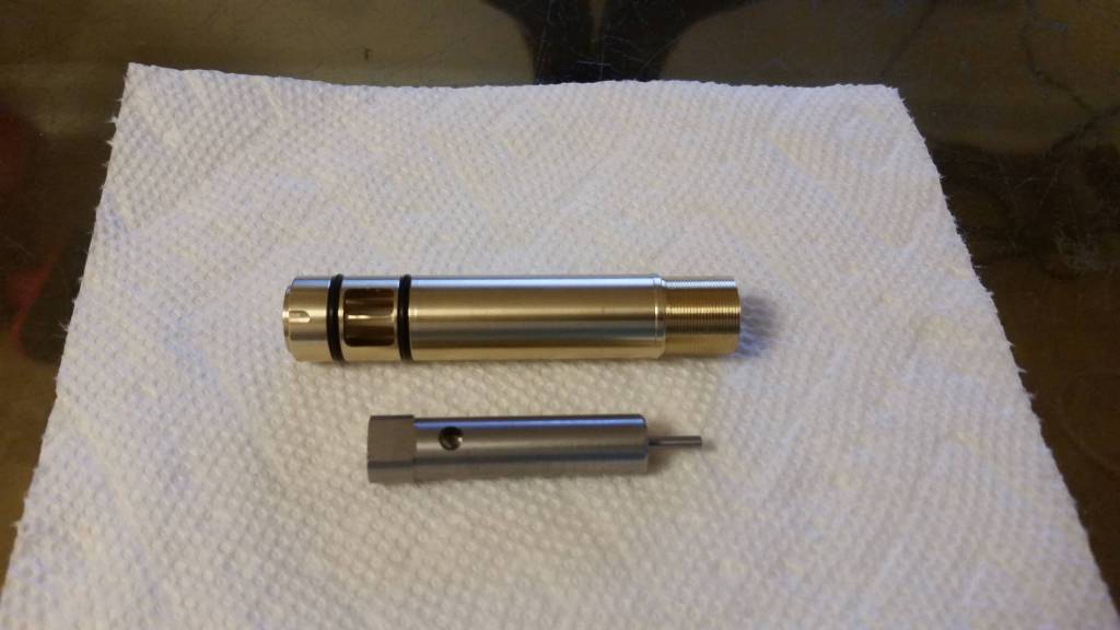

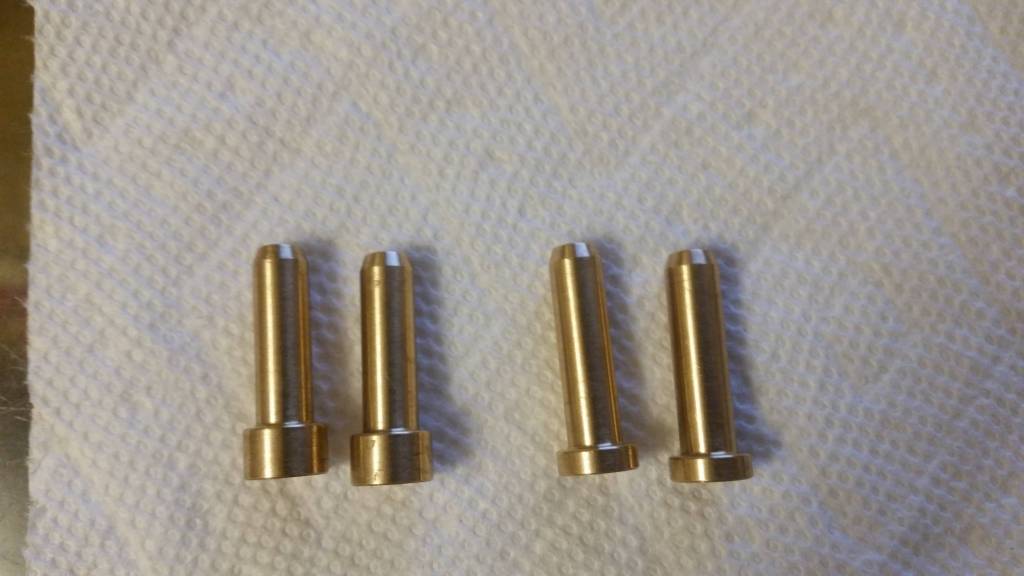

I recently asked my friends at Huma to make me a .35 caliber dual ported barrel inlet & pin probe to test on an FX Impact .35 caliber barrel. So they made me two prototype sets to test, and with these new parts I had my friend's M3 shooting NSA 93gr slugs at 160 ft. lbs. I was shooting the same NSA 93gr slugs with that .35 cal. barrel on my MKII Helga at 970 ft/s for 194 ft. lbs. Since these beautiful new parts passed all my tests with flying colors I advised Huma to go ahead and put these parts into production. You should also know that the o-rings Huma used on either side of the dual transfer port are 11x1.5mm in case you ever need to replace one.
The first photo below shows the new barrel inlet & pin probe from Huma, and the second photo shows the new Huma parts next to the factory OEM FX parts. Note the difference in color between the Huma & FX barrel inlets...the Huma barrel inlets are a much lighter color because they are not made of plain brass, they are made from a special proprietary blend of brass and other metals that makes them several magnitudes stronger than plain brass. These new brass barrel inlets & pin probes will be available at Huma very soon for you guys that may be interested.

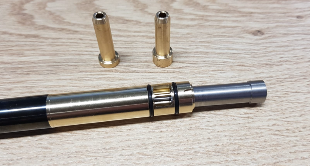

heavy-impact: By installing a barrel inlet with a Huma Dual Hole Transfer Port that's larger than the tp hole for the valve, valve house, & rear block, and by also replacing the factory pellet probe with a Huma Pin Probe, the increase in the velocity of your projectile will be approximately 30 ft/s or more depending on the caliber, and the hammer spring & valve spring settings. This has been proven many times over in the last two years.
