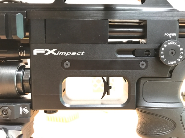

This following sounds like someone who has done a lot of research, most likely exactly what I'm looking to do-- but what is meant by disabling the VS adjuster? What do I need to change? Thank you.
"sniperlabyo"I lowered the reg to 130b to max speed of 860fps with 44g, with 48 shots I like this setting giving the best balance of power,accuracy and shot count. with all my testing I disabled the VS adjuster giving me lower ES.

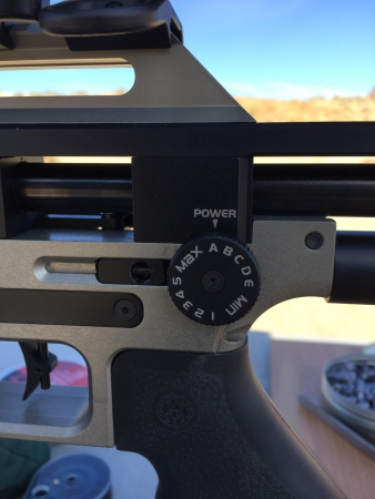

i think vs is the valve spring adjuster maby he ment losening it or tightening it im prety shure its the thing on top of your air tank with the white lines you should probably take note of how many revolutions you make if you adjust it .im not shure why my gun shoots the 45.75 better at 200 bar but it dose and i havent messed with the factory settings for reg pressure or vs but when i orderd my impact told aoa i want it set up for the 50.15 grain jsbs and it realy is ,it stacks them on top of each other at my 45 yard back yard range but like i said the 44.75 are accurate out of my gun to just at 200 bar and less maby it has to do with harmonics of the barrel
"hawkeye"there is a video that shows how to tighten hammer spring all the way if you havent done it yet try that first i dont have a link but you remove the power whele and tighten an allen head screw and re instal the power whele
