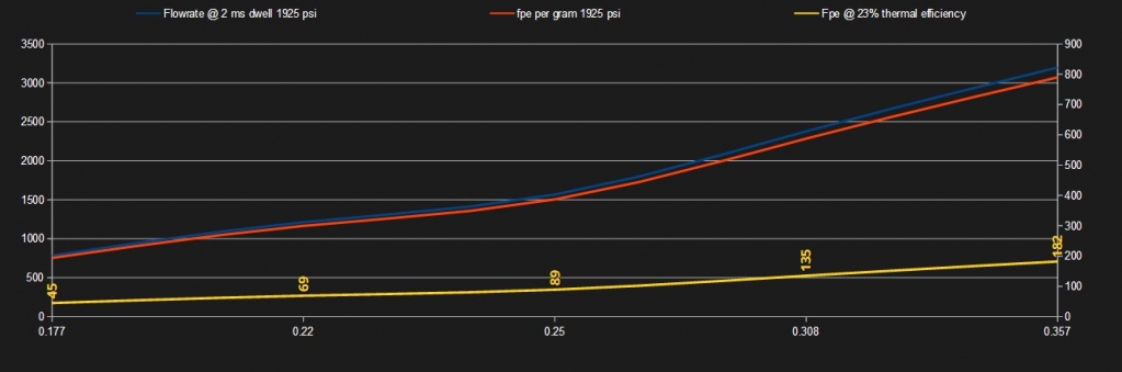

The differences between .22 and .25 are so minor, they might as well just make a .235" caliber and get rid of them both...that way its .177, .235, .3...ahh more symmetry in the scaling of calibers..There is very little a .22 can do that a .25 can't, and there is also very little a .25 can do that a .22 can't...
Heres a simple graph demonstrating energy potential in your average pcp operating at 1925 psi based on caliber change alone.
The increase in energy is equal to its increase in surface area...
.22 can make ~55% more energy than .177
.25 can make ~30% more energy than .22
.308 can make ~51% more energy than .25
.357 can make 34% more energy than .308
The smallest difference in calibers here is obviously between .22 and .25, while .308/.357 comes in second, but note that 34% of 100-200 is a lot more than 30% of 40-60...so again, the difference between .22/.25 is the least between any two calibers.

Thanks a lot for the graph and data. It's really not much difference between .22 and .25.

And my .25 cal does 20 to 60 fpe with the turn of a dial. I mean as I stated the two calibers aren't really out performing one or another...there is always an argument against one caliber or another, and IMO...its a wash...
The 35% cost difference in pellets is nearly identical to the increase in their performance. While a .30 cals increase in price to 80% more than .25 cal with their performance difference being much less...see where I am going here? Its pretty silly to try to argue your way to saying either .22 or .25 are more superior than the other. JMO!
