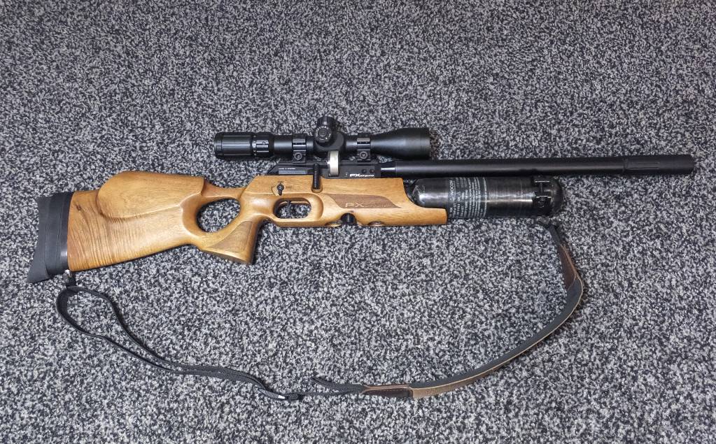

I have a Crown with a 380mm barrel. It is short and handles like a dream. However the Wildcat MK III compact is absolutely tiny. Shot count will however be a lot lower due to the small tube versus a 480cc bottle. The Crown will also have more adjustability if that matters to you (both have an adjustable Hammer Spring, Hammer Spring pre-load, and regulator. The Crown also has an adjustable transfer port). Pretty much a toss up in my view, if you are looking at the synthetic stock Crown. The laminates are beautiful, but not work an extra $400 IMHO.

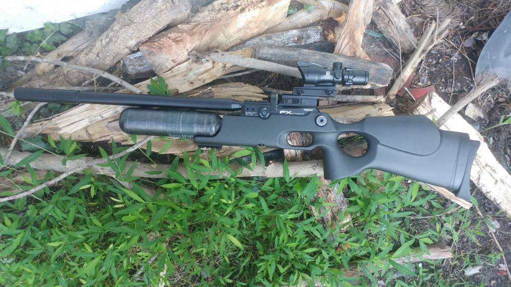

I have a Crown 380, and it's brilliant for about 75 yards. Past that I dont trust the .22 pellets not to drift in the wind. I'm currently throwing a 500mm shroud tube at it and 500mm superior liner. Will be tuning for light weight slugs to confidently shoot out a little bit further.

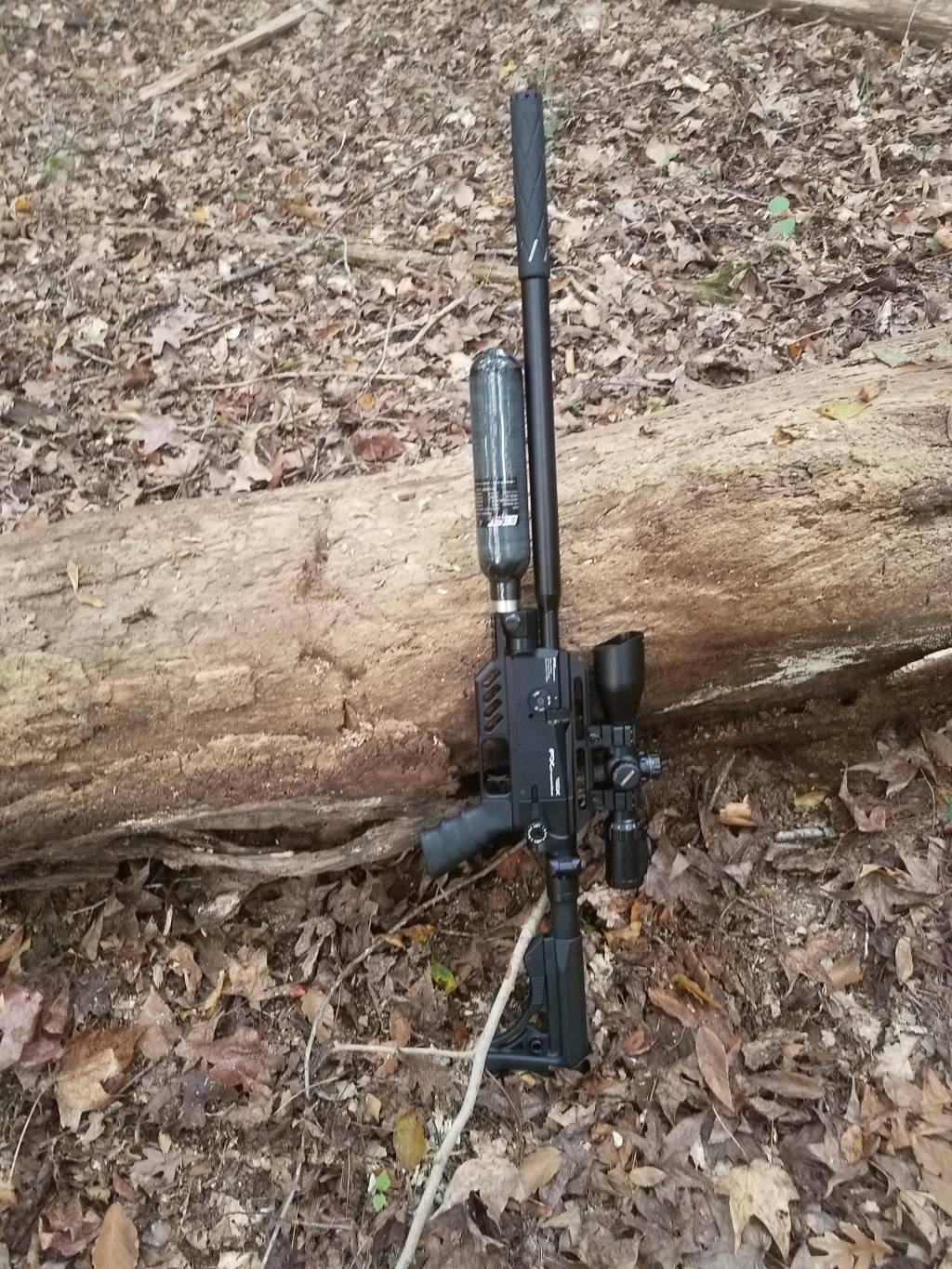

Wonderfully light, and very comfortable to carry long distances like this. I am using a little smaller scope than most use on this gun, and a hatsan 12 shot magazine to get my scope to bore axis low.
I'd go with the wildcat or the crown in 500mm .22 and tune for slugs like I'm doing, or get a larger caliber if it's needed.

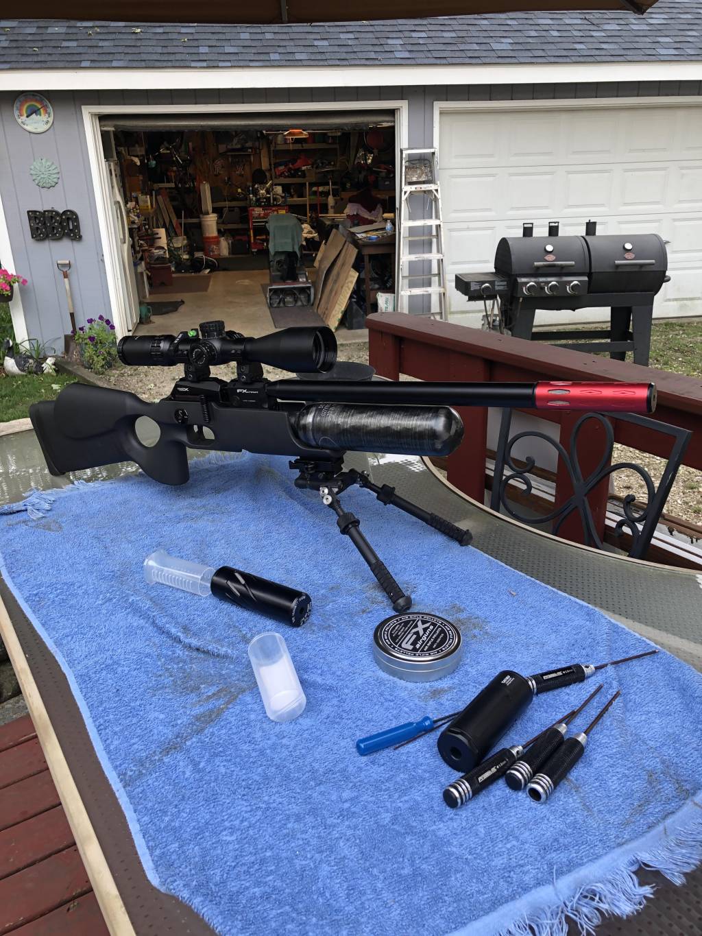

As pictured. 8lb and 7 oz. 4-14x44 ffp scope
With synthetic stock I can get the gun down to 7lbs with a 4x scope and moderator.

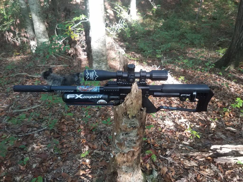

So I've left out some details from you guys! I have the current guns! Fx impact mk2 600mm .25cal loaded! Fx dreamline tac compact .25cal!
I like both guns alot but really haven't decided yet on weather there the right fit for me. Dreamline trade off is the flimsy folding stock that has way to much wiggle in it! Tuned at 715-730 fps to matinee shot count. The impact is amazing but really heavy for long walks especially here in Tennessee and Arkansas where I hunt were there are mountains and hills! Also cant get my tune exactly right with all the added mods! My powerwheel doesn't increase and decrease fps like it should! Which really really ticks me off!! Because it came tuned?? And still didn't act right. Also the impact doesn't hold like the crown I've held before with the 600mm barrel but way to long!

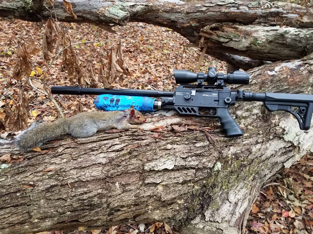

Given the fact that you have the Impact, then I would go with the Crown. I have an Impact as well and I love it, but to me it doesn’t fit me as well as the Crown. The 380mm barrel is, as Long_Gun_Dallas says, not really great in .22 past 75 yards. However With a slightly longer barrel (500mm) it still handles well and delivers more power for longer shots. I have 2 Crowns, and recently converted the .22 Cal to a .25 using a 380mm Dreamline barrel. I get great accuracy at 50 yards (haven’t taken it out to 100 yet) and great power (782 FPS using JSB 33.95 pellets for 46 Ft Lbs). It’s just perfect for walking through the woods.
