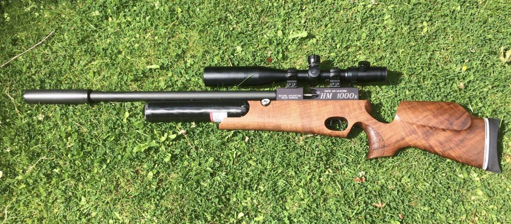

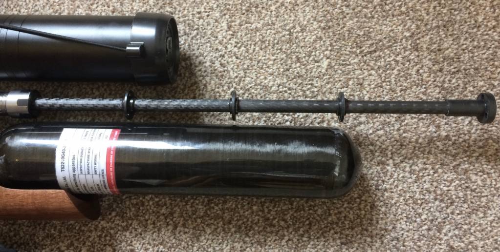

      When I got my impact, accuracy wasn’t good, I blamed the liner assembly so went about modifying it, accuracy improved but still not as good as any of my other guns. So I swapped the liner for a lw barrel, accuracy improved again but still not as good. No matter what I did, I could not get the impact to shoot as accurately as I would expect.
      So out of frustration, and to rule out the liner, I made an adaptor to fit my Rapid, hey presto the liner was as accurate as any of my other barrel.👍
      I now have a FX liner fitted to my RAW and will buy more Fx liners in the future, I haven’t got the Impact any more and won’t be getting another either.
      so while my opinion about fx liners has changed my opinion about the way the liner is fitted to an impact hasn’t.
