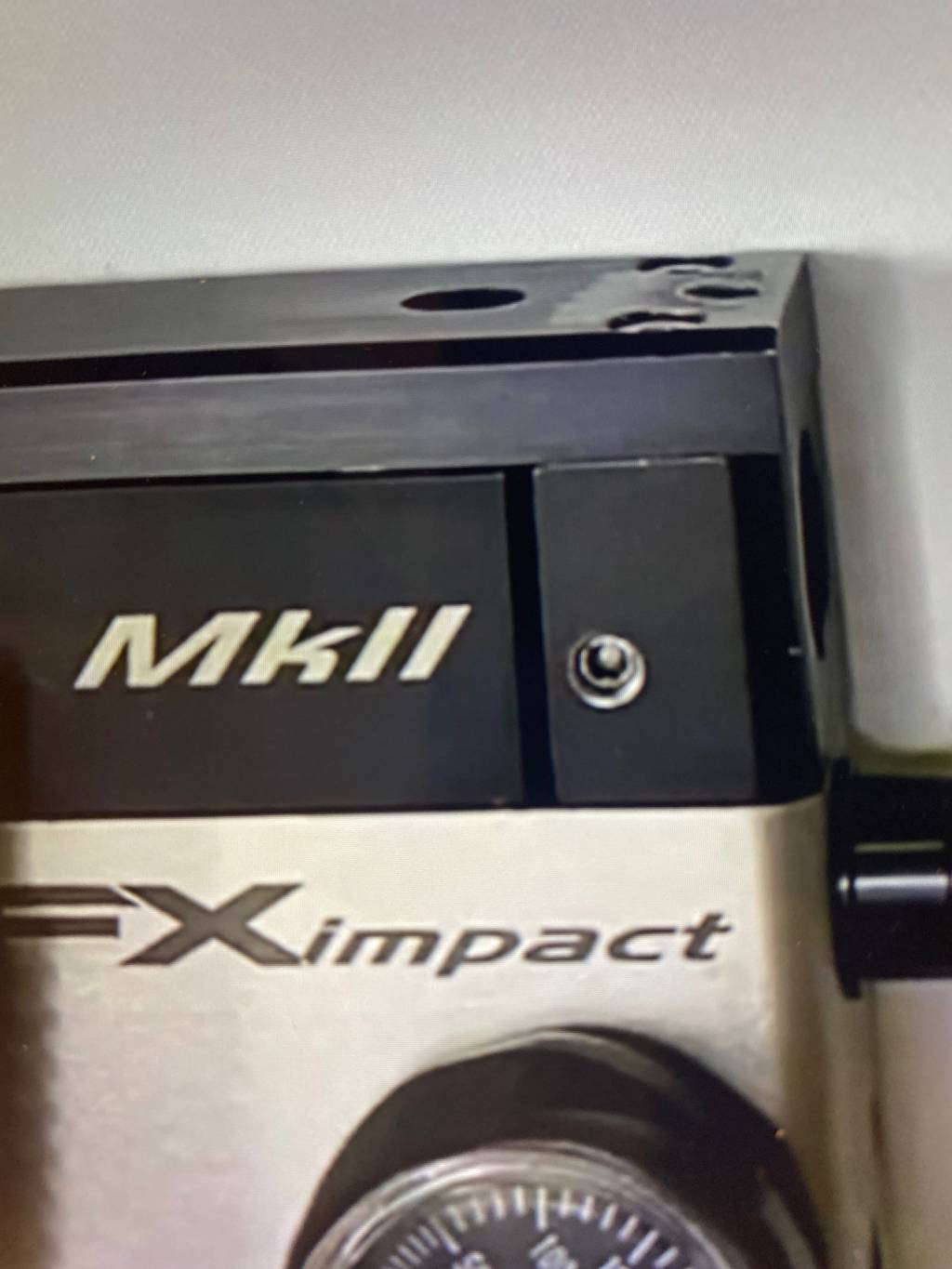

On the FX Impact I noticed that Ernest adds (2) set screws on both sides of the front block, just below the center point, and very lightly snugs them up to further reduce POI shifts. Curious to know if anyone else has tried this mod yet? As I understand it, he uses set screws with nylon tips.

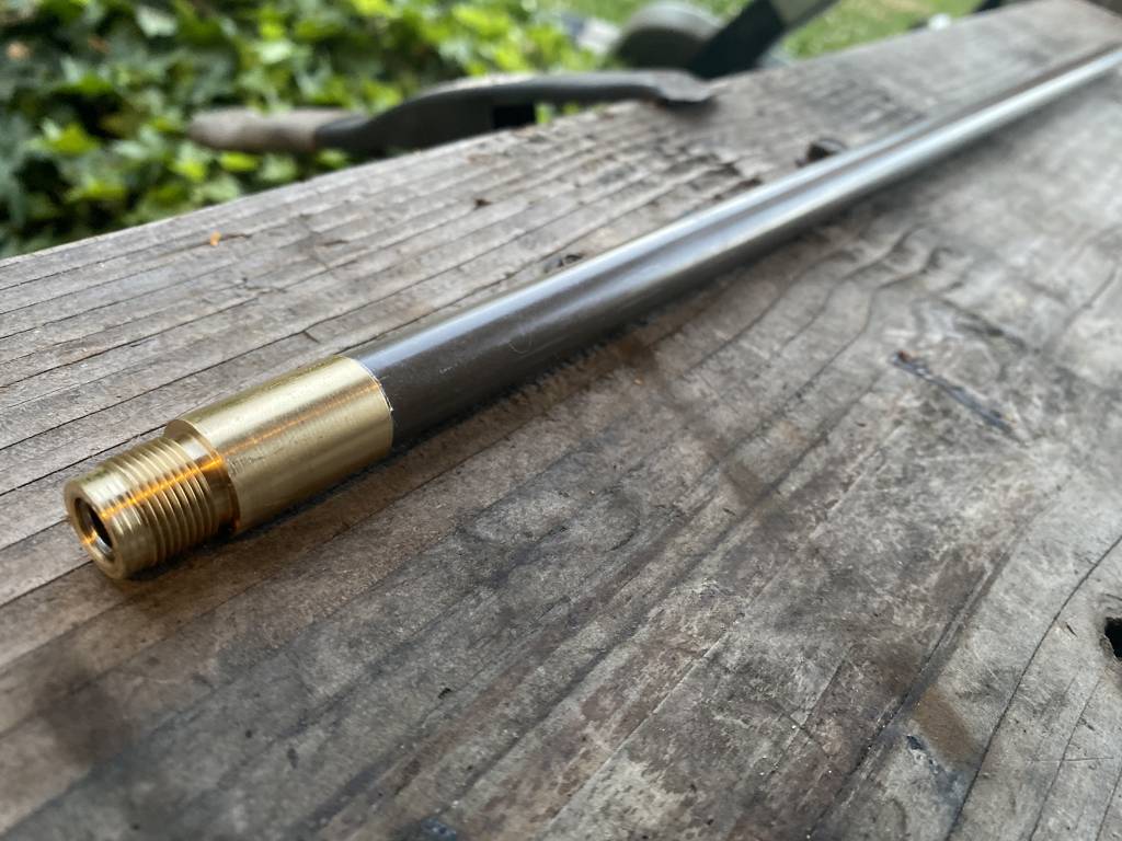

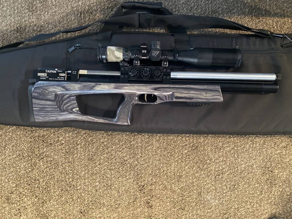

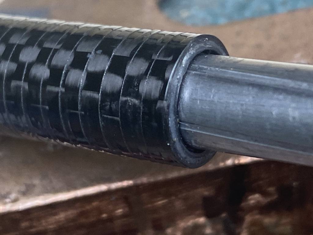

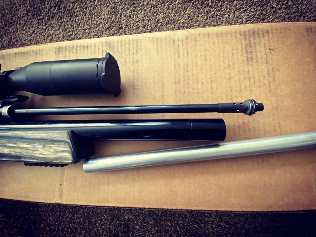

You can always beef things up. I run FX liners in my custom Taipan Veteran. Eliminated harmonics with double carbon fiber tubing in epoxy around my 22 cal liners, upgraded the sleeves with CrMoly, and built a custom shroud tensioning assembly. Had to do this to support my goals for precision with 40gr BT slugs, but it was definitely worth the efforts.
...Ernest adds (2) set screws on both sides of the front block...
I like him, he is not afraid to try things. Ernest have lot of pictures and videos in "early phase" more for entertainment vs a real improvements on a score card.
Call that R&D. Of course more fun if you have plenty of spares in your drawers.
It would make more sense to me if both the front and rear block have these setscrews on both side (4 in total). But that would lead to an other -> user problem 😏
another example of a experienced modifier👍
