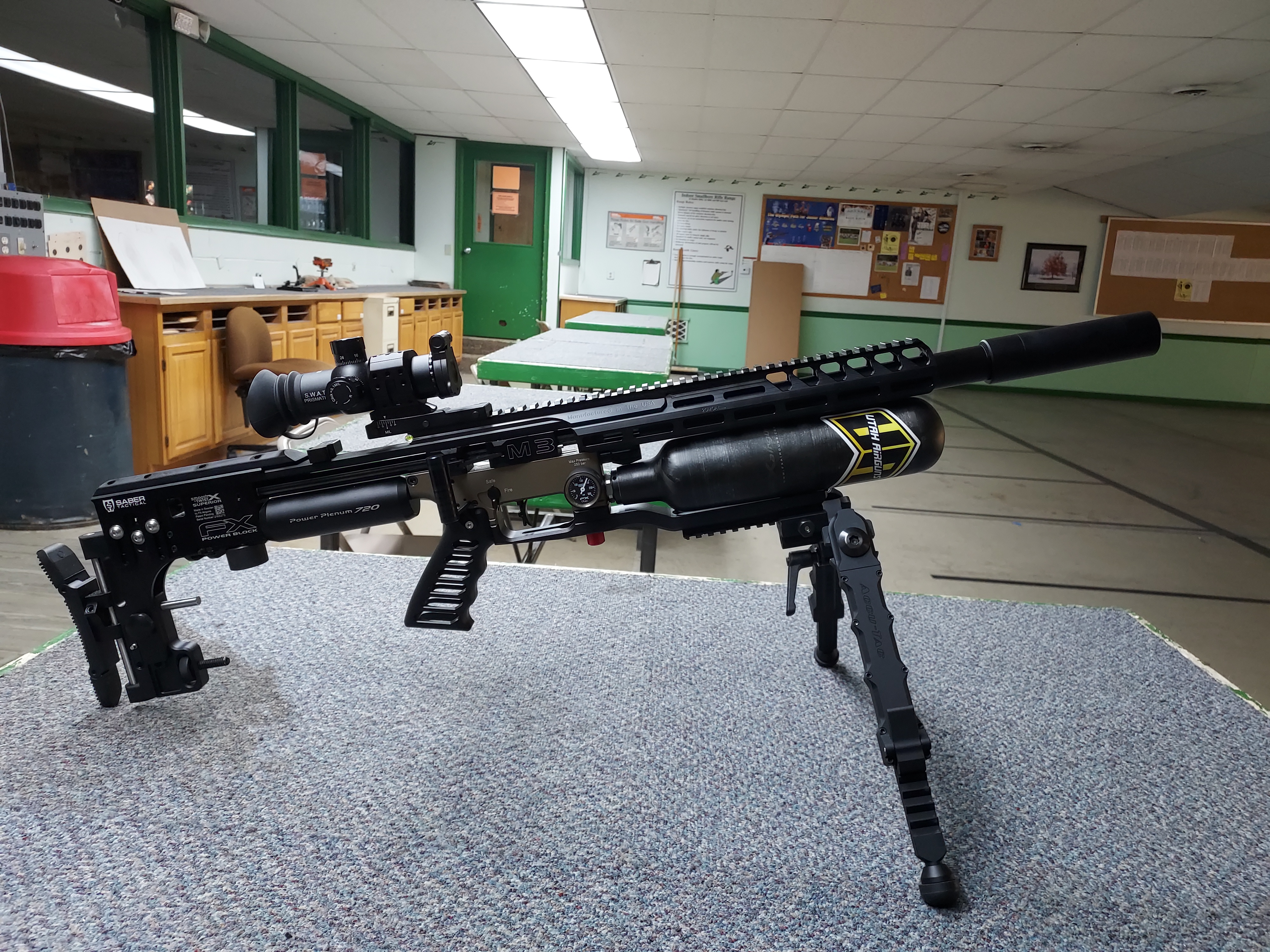

0.30 caliber tuned to 60 yards by Mr. Buck at Cape Fear Airguns LLC. Scope DOPE has two zeros (elevation settings), one for 20 yards indoors the other at 50 yards outdoors for N50. No POI issues at either distance and no first shot issues.
600mm barrel, Air Valve = 3, Macro = 16, Micro = 3.5, Regulator outputs = 145/115 bar, FPS = don't care, only 5 round edge to edge dispersion group size matters for N50.

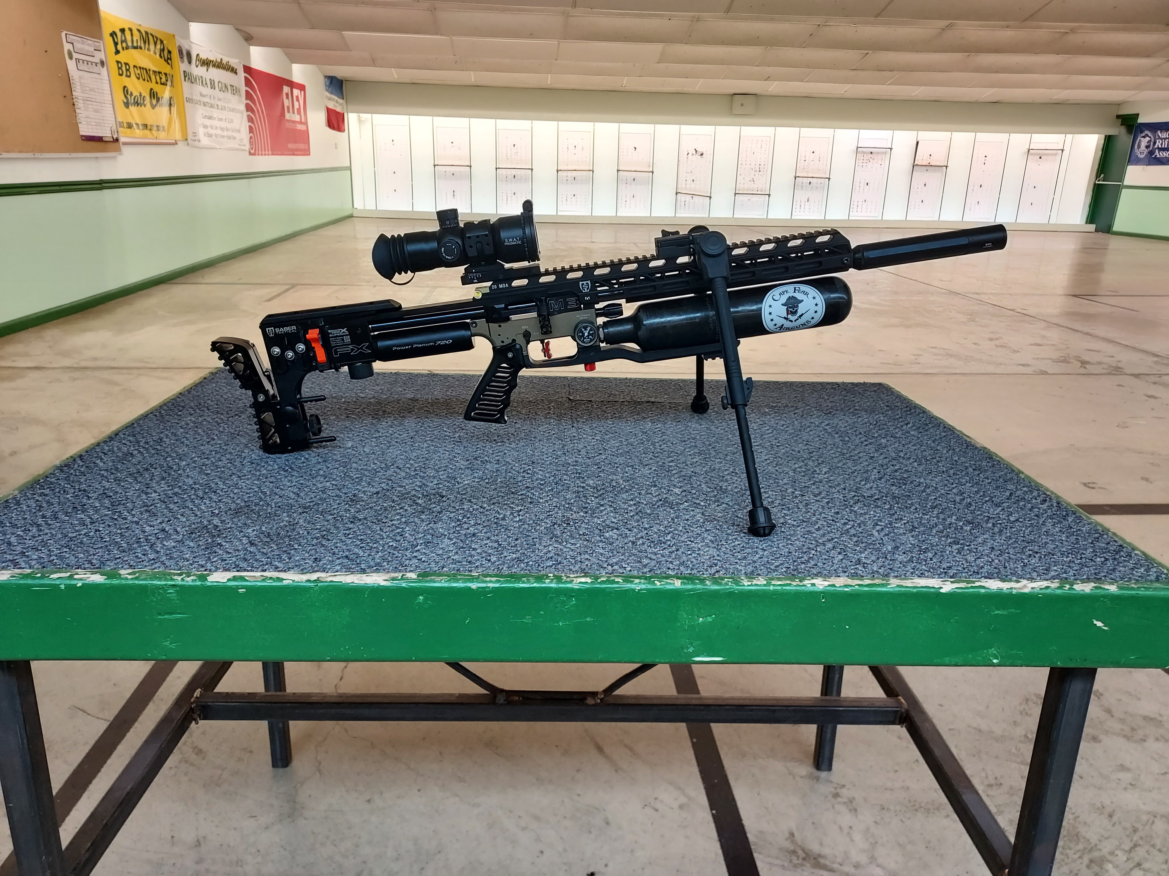

0.177 caliber tuned by me to less than 12 ft-lbs for WRABF Lite Air Rifle. Scope DOPE has two elevation settings, one for 20 yards indoors, the other for 25 meters outdoors. Same DOPE for three + years. No POI shift or first shot issues.
600mm barrel, Air Valve = 3.0, Macro = 1.0, Micro = 1.5, Regulator outputs = 120/70 bar, FPS = don't care as long as whatever so called "accurate chrono" used to check FPE indicates </= 12. Again only 5 round dispersion group size matters in WRABF.
