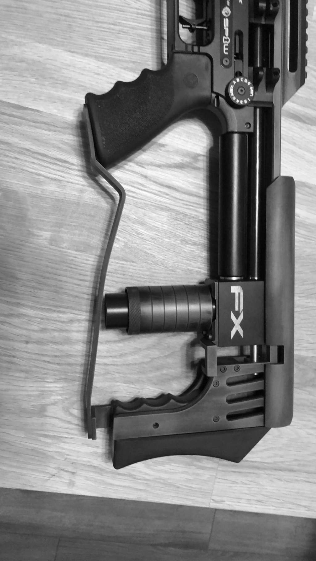

UpNorthAirgunner SPAW Power Plenum Update! So you have an FX Impact and saw the new FX Power Plenum released.... You have a MKI or earlier MKII FX Impact and thinking about sending it to get the Power Plenum upgrade? The new kit from FX is super clean looking with out that dangling cylinder, but hear me out real quick.... I would 100% consider the Southern Precision Air Weapons LLC. (SPAW) kit from Ken Hicks as an option if you want the most power and adjustability for efficiency.

The new FX factory kits look fricken amazing and will take your rifle to the next level, but Ken's new M14 SPAW Power Kit eeeks out just that bit more power on the upper end and across the full spectrum of adjustability. Ernest Rowe designed this kit and can attest to the amazing performance it offers.
I have my rifle set up right now in .30 cal configuration and just waiting for the .35 cal kits to be released. I wanted every ounce of juice I could get out of this FX Impact MKI platform so I went with the SPAW Power Kit.

So if you want the biggest power possible - go with the dangling plenum from SPAW and add a Saber Tactical Inc bag rider under it. It will protect the plenum and add overall platform rigidity. The hangy-downy dangling plenum might not be as streamlined as the factory plenum, but it is just a good visual indicator your FX Impact has the biggest balls possible! Just think of it as your Low Hanging Power Scrotum! HA! #DanglingPowerScrotum #MyFXHasBigBalls #FXImpactDeerHunting2020 #MyFXImpactBallsHangLow
Ya - I've seen some of those low cost kits and they are just using the same diameter as the threaded pressure gauge port. Ken actually adjusts the block to take the larger M14 size of his plenum. Agreed that the factory one does look cleaner and it is pretty fricken sweet, but.... When I go up to the .35 cal kit when it comes out - I want every little bit of power I can get for Deer hunting. Even at the projected FPE the .35 Impact is going to be able to deliver, it is going to be marginal for Deer hunting and with only the very best placed shot into the vitals. We will have to see though once they get released.

Ya - SPAW puts much more into this kit than just a can hanging off your guage port. There is a fair mount of porting and mill work that is done to the valve and housing, heavier hammer weight, delrin C3 and larger external regulator plenum. Plus he puts a warranty on his work if anything ever happens to your gun due to the addition of his kit. He tunes each and every gun before it goes out and he includes a performance report when you get it back. I can't say enough about his attention to detail.

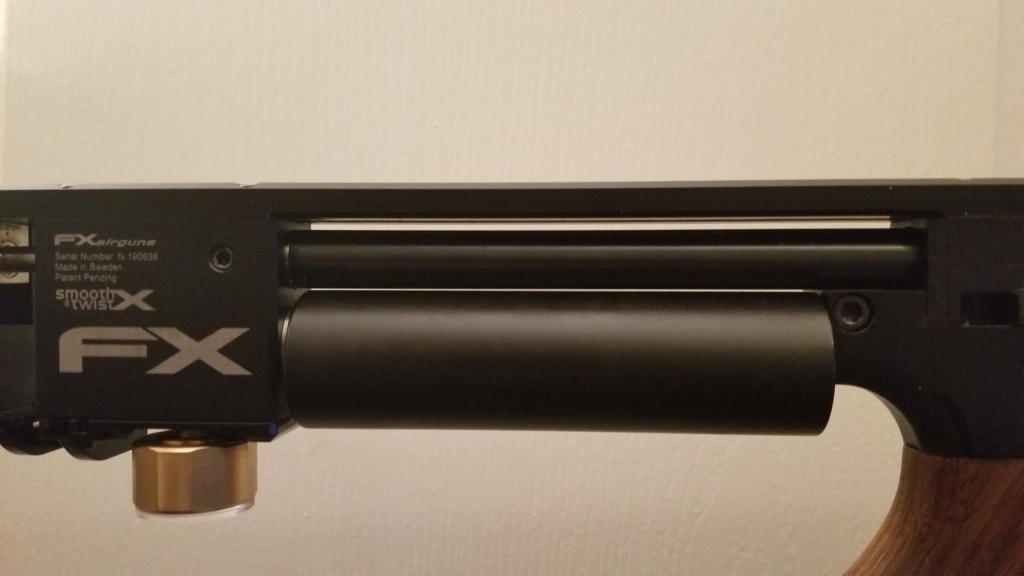

Me personally I prefer the fx plenum as it is build into the rifle and not attached where the reg gauge goes. There are many so called external plenum folks are selling for $40 to 50. But I rather folk up the $300 just to get the fx plenum as it build into the gun and looks cleaner imo.
Those $50 kits are just cans to attach to your gauge port. You're getting a lot more with the SPAW kit. Read more: https://spaweapons.com/products/spaw-power-kit-for-fx-impact-mk2-impact-x?fbclid=IwAR3NGzPNvZVWd6LAII5R-Z6uwUYZBfFLY24IvwyXO-xK1Ajf4CUziPO1V0U

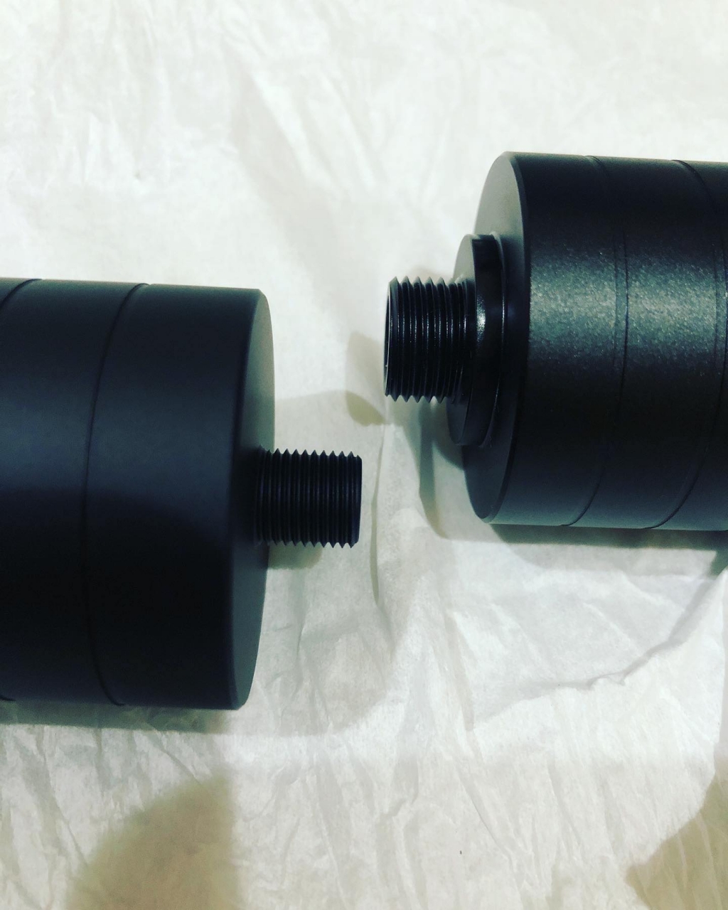

The version of my plenum design that FX produced looks really nice for fit and finish but the version being produced by Michal Osyda in Poland is larger than the FX or SPAW options, doesn't require any modifications and gives the greatest tunability and performance in .30 cal. Smaller calibers don't require as much plenum volume. Proper porting is necessary to get the most out of the gun with or without a larger plenum. Mr Osyda has increased his price recently but it's still the best upgrade on the market.
Pics of the larger volume Polish version...
Installed on Glem.Chally's gun.
If you want the Polish plenum avoid scammers trying to sell you one for $400 + 250 installation. Buy directly from Michal in Poland for $150 shipped and install it yourself. If you need free help installing it just PM me here.

The external plenum is far better option as it can be removed any time during shooting.
It's a matter of couple of minutes to remove the external plenum and get full benefit of lighter pellets.
Lighter pellets normally do not like low reg and high quantity plenum to achieve the accuracy with same fps.
So to me external plenum is all the way.
If someone never needs to shoot lighter pellets and always has to shoot slugs at high power then inbuilt fx power plenum is OK.

You can keep higher reg pressure and lower velocity with the valve stop and hammer spring.

I have tried all this but for lighter pellets I get best results with smaller plenum.

Does anybody has the idea to install both of them ? I mean the new Fx kit plus an external plenum (Ernest type) . I think technically is possible without any restrictions. It supposed of course that will be done all the rest modifications ( hammer weight - porting etc)We will have 54 cc (Fx plenum)+around 45( external plenum) = 99 cc. ( it depends on the size of the external plenum).So if we have a quantity of regulated air around 100-120 cc would we gain anything? And I am talking for the owners of .30 caliber who are looking for more power in order to shoot heavier slugs. Is just an idea and I post my thought here to take some opinions from the impact experts .
I'm using the larger version from Poland plus a 20cc yong heng external to reach 132 fpe at 150 bar. There is no gain adding more plenum, at least not through a 6.35mm valve. I made a 7.1mm valve and PEEK seal but haven't installed them yet.
