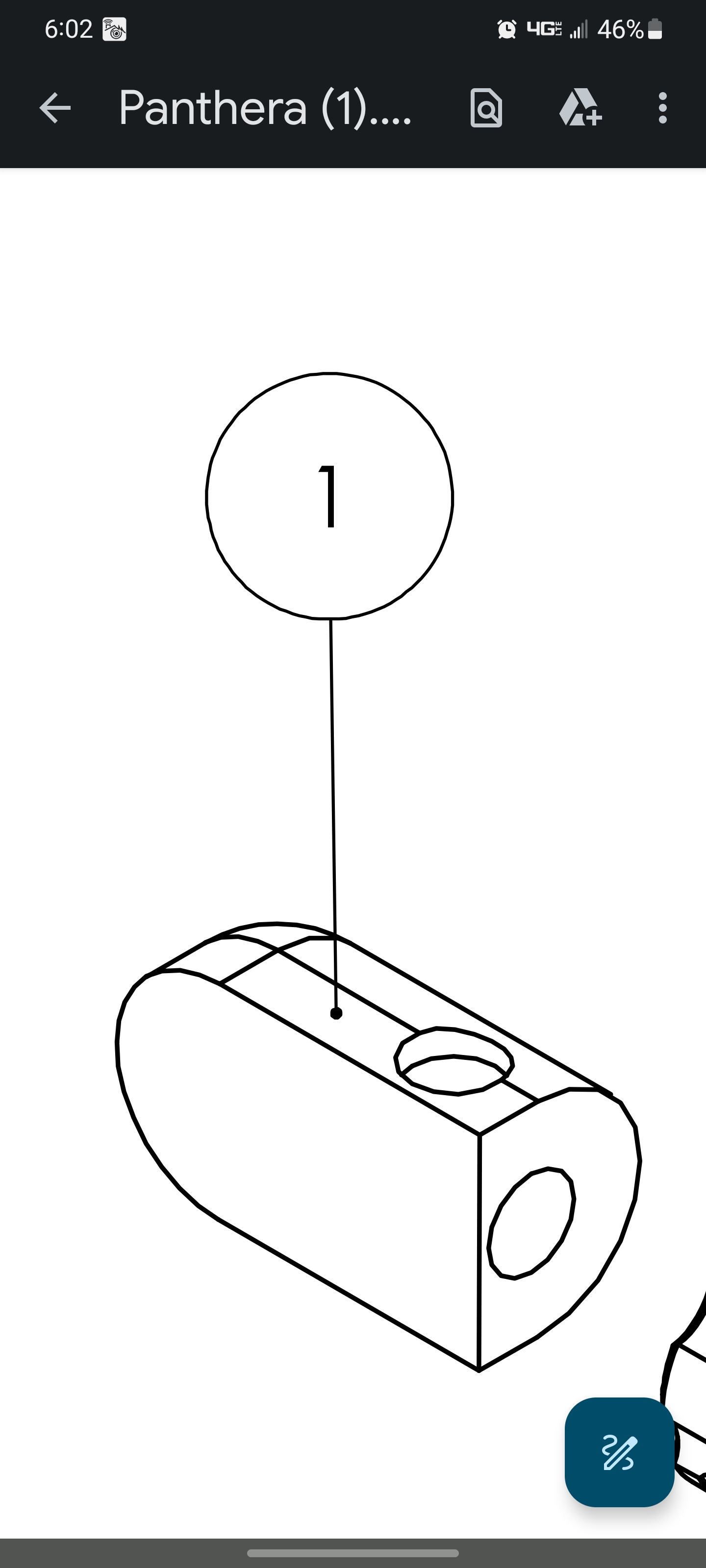

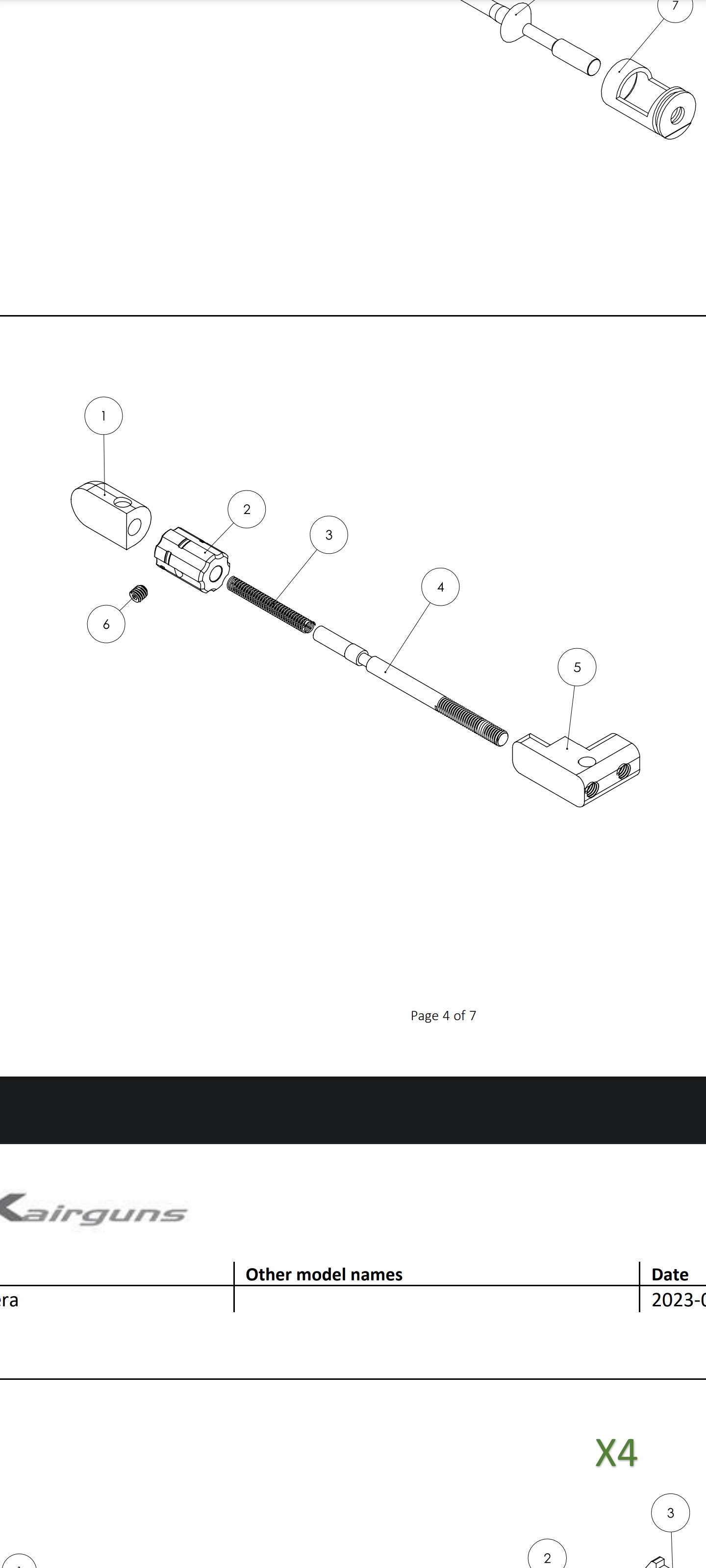

That set screw wasn't even touching the Quick adjustment guide on mine. The only thing that was holding that in was a lip on the Kings stock. They also made a mistake with the counter sunk hole, it's on the top instead of the bottom 🤔...
Make sure you didn't lose the ball bearing and spring for the adjustment wheel. Unfortunately, you have to go through everything on these guns. Mine was just slapped together.
