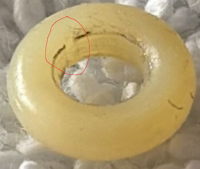

The slow first shot happens because an O-ring around the valve pin tends to stick. This usually becomes noticeable after an hour, or sometimes even after 24 hours. The first slow shot is typically about 30–40 FPS slower or even more.

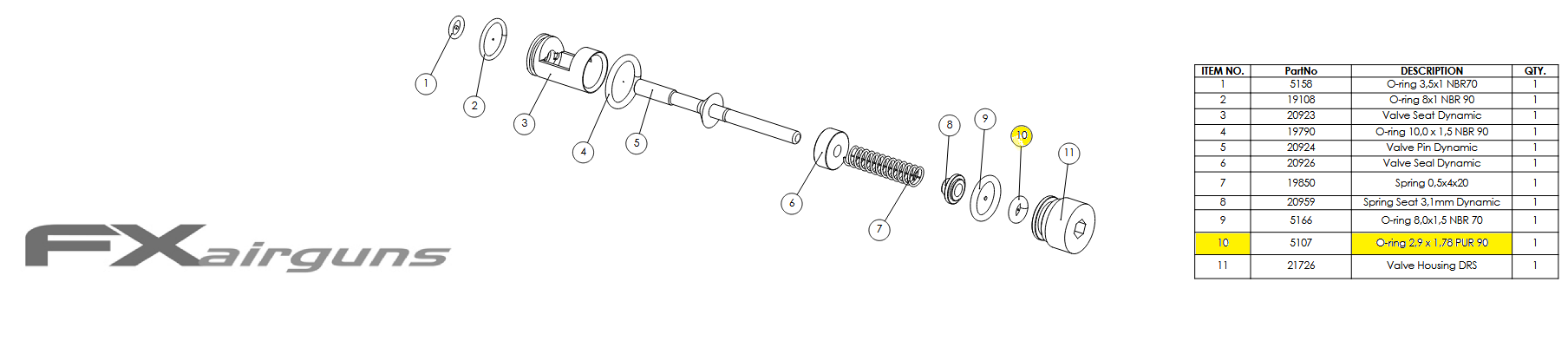

O-ring #10 → 2.9 x 1.78 mm PUR 90 is the O-ring that tends to cause the issue. Look at the O-ring that came out of my DRS, not good.

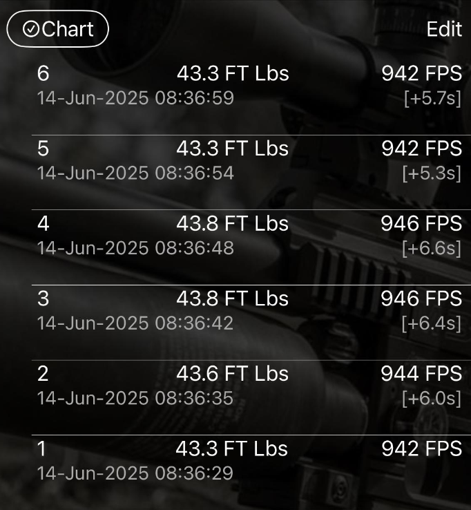

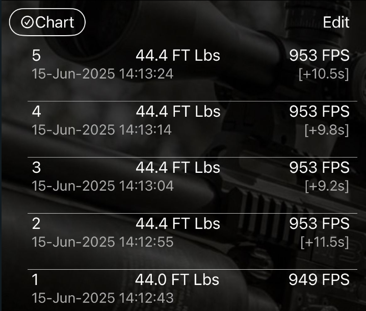

After 24 hours, the first shot remains consistent and accurate. Keep in mind that temperature can affect pellet velocity. Here in Belgium, the weather has been quite warm in the past few days, which may influence results slightly. The first image shows the shots taken in the morning. The second image shows the shots taken one day later, slightly after noon, so nearly 28 hours in total between both sessions.

Which one was in your drs?
It was black and i think 90 duro not sure if the color indicates a different material
