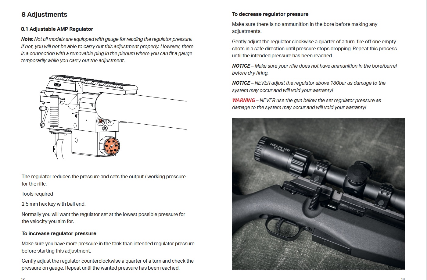

No,it's not degassed . I put a digital gauge to set the reg.When i set the speed , i adjust the hammer spring and reg at the same time 🤷‍♂️ It was a bad idea?

Old habits die hard (for me). I have always been used to only increasing a regulator under pressure. And having to de-gas the gun & plenum space to decrease regulator pressure.
But it appears that you can adjust the new FX AMP regulator (which is in the DRS) in EITHER direction while the gun is pressurized. So if you followed what the manual says below then NO, what you did was not a bad idea. You may just have a sub-par regulator from the factory.
Reactions: Normkel
Correct but is the digital gauge left on the gun all the time ? I bet if it is and you check after it sits the pressure in the plenum is a bit higher than where you set the reg at. This would account for a Cpl higher power shots after the gun has sat a bit.
After i set the regu i shot a few dry shots.After that i am using the chrono .The plenums pressure get higher a little,2-5 bar. Now i am totally confused.
After i set the regu i shot a few dry shots.After that i am using the chrono .The plenums pressure get higher a little,2-5 bar. Now i am totally confused.i observe a thing.If i am waiting between shots a few minutes it is much better.But if i shot all the magazine one afther another maybe 6-7 shots are hole in hole , the others are going to side 4-5 cm on 20 meters
If the regulator is 'creeping' (kind of the same as leaking) it will allow higher pressure air from the over-the-barrel air cylinder into the plenum space. The regulator is the "gate-keeper" between the high pressure in the air cylinder and the set pressure you want in your plenum space. So reg creep would do what you say - the plenum pressure gets higher a little.
