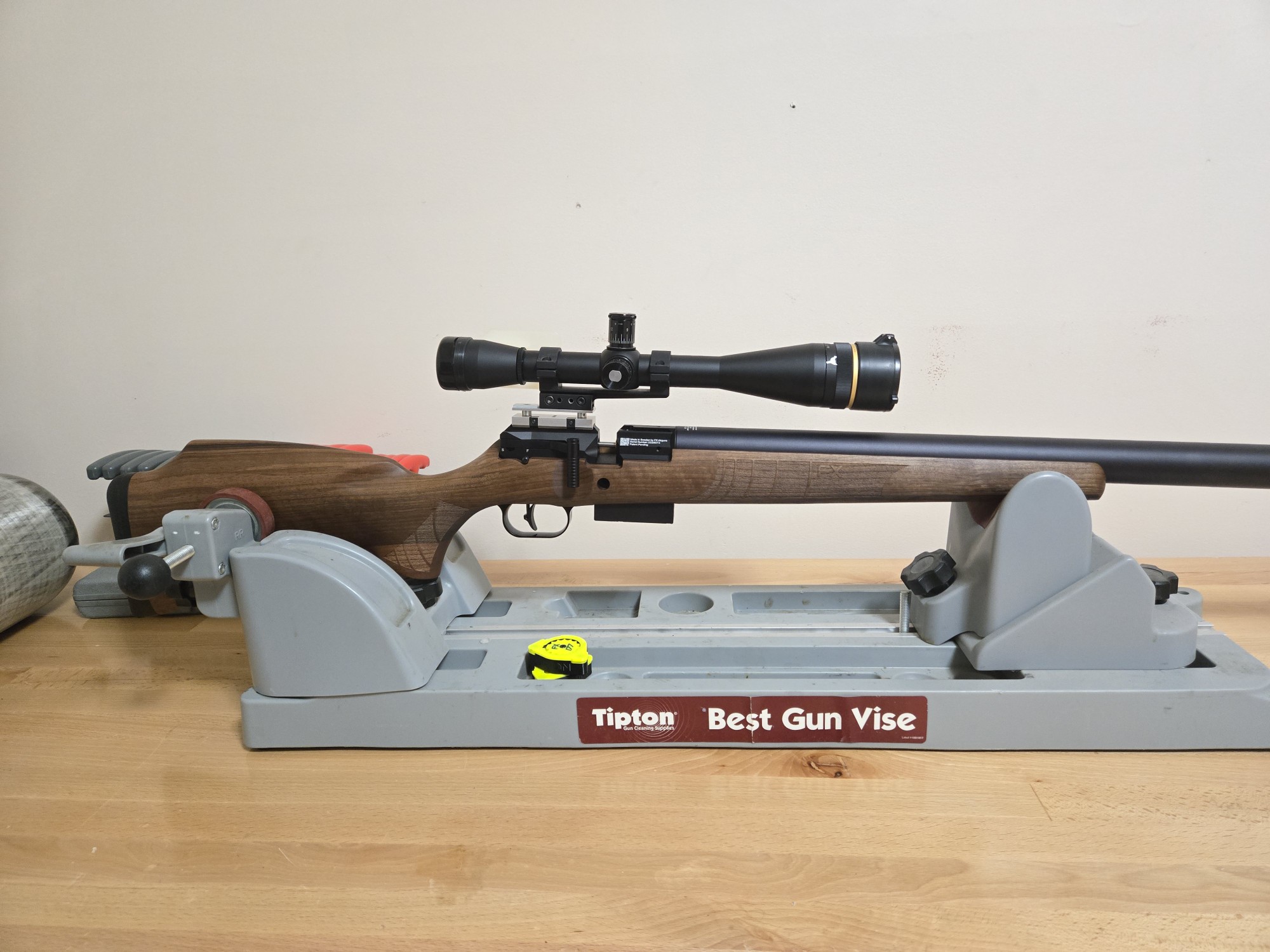

I got my drs Saturday, 600mm classic. Came from Utah Air with the inspection sticker saying 10.3 gr at 900fps. Been too cold here to do any real testing, but 10gr h&n slugs were grouping 6 to 8 inch at 30 yards. Switched to 10.65 gr baracudas and grouping about 2 to 3 inches at 30 yards. This was all from standing, so I am happy until I put it to paper and do some tuning
