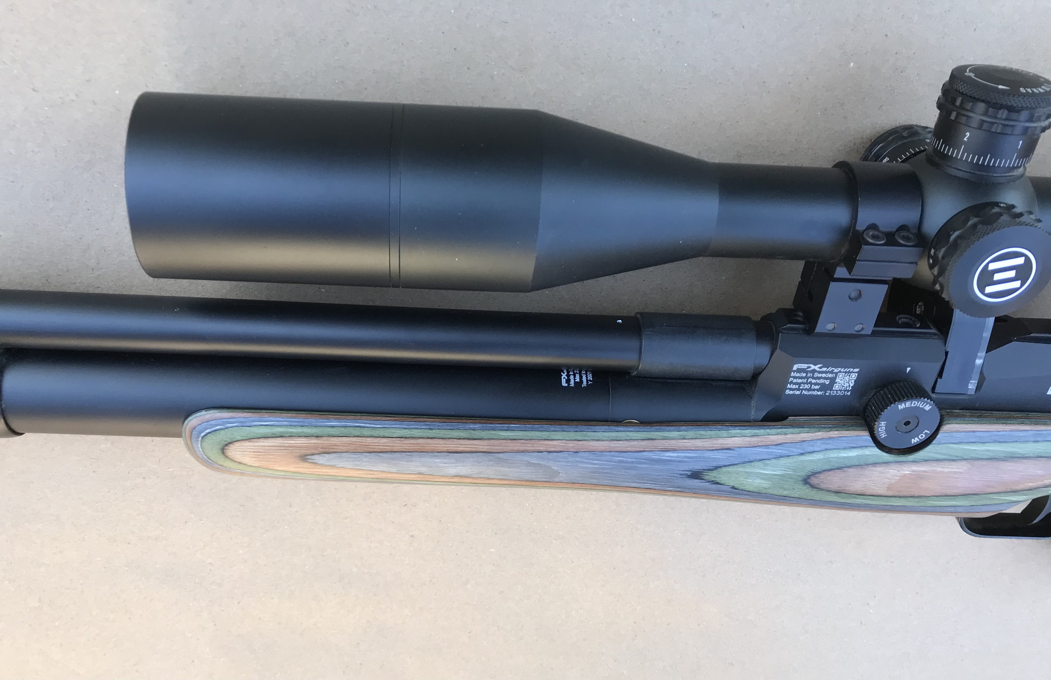

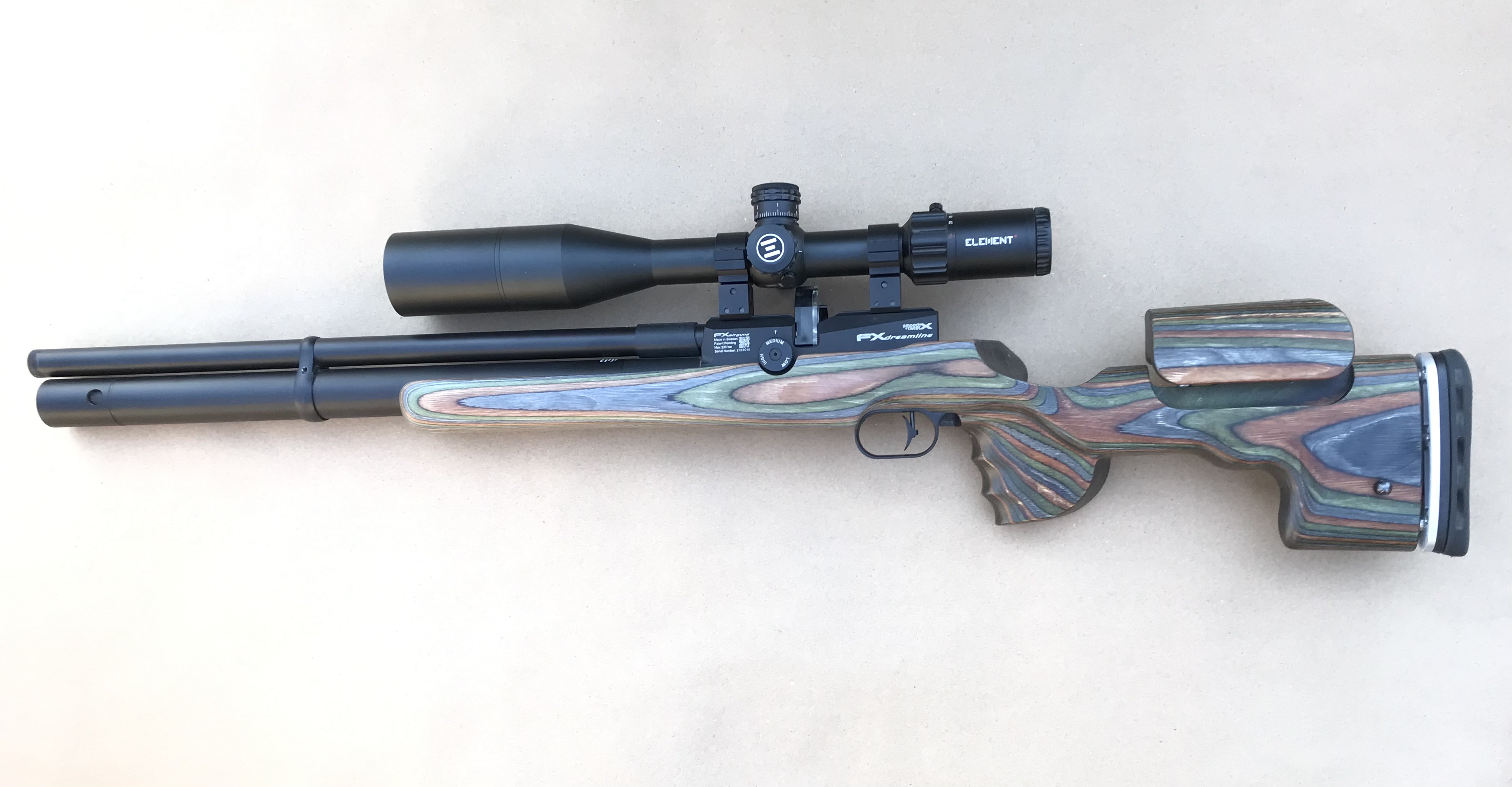

I thought that I'll give a parts list for making Your regular FX Dreamline to dual regulated like FX Maverick and FX Wildcat MKIII. Parts list from the point of view making Dreamline Tactical to Classic with GRS stock and Maverick regulators/plenum system:
You need to convert tactical safety to Classic/bullpup safety.You need (part numbers from FX parts drawings):

To make Dreamline dual regulated You need:
1. Power adapter Dreamline - 20268 - 1pc (this is plenum)
2. Power adapter with regulator hole - 20325 - 1pc (second regulator body)
3. M3x8 bolt with allen key head - 1pc (for plugging hole in second regulator body) Read topic in Airgun Nation forum
https://www.airgunnation.com/threads/fx-maverick-second-regulator-tube-degassing-screw-hole.1298199/#post-1579965 4. O-ring 23,0x2,5 NBR 70 - 19485 - 1pc (one comes with powerplenum but for second regulator body You need one to buy)
5. O-ring 10x1,5 NBR90 - 19790 - 1pc (that one goes into the second reg. hole)

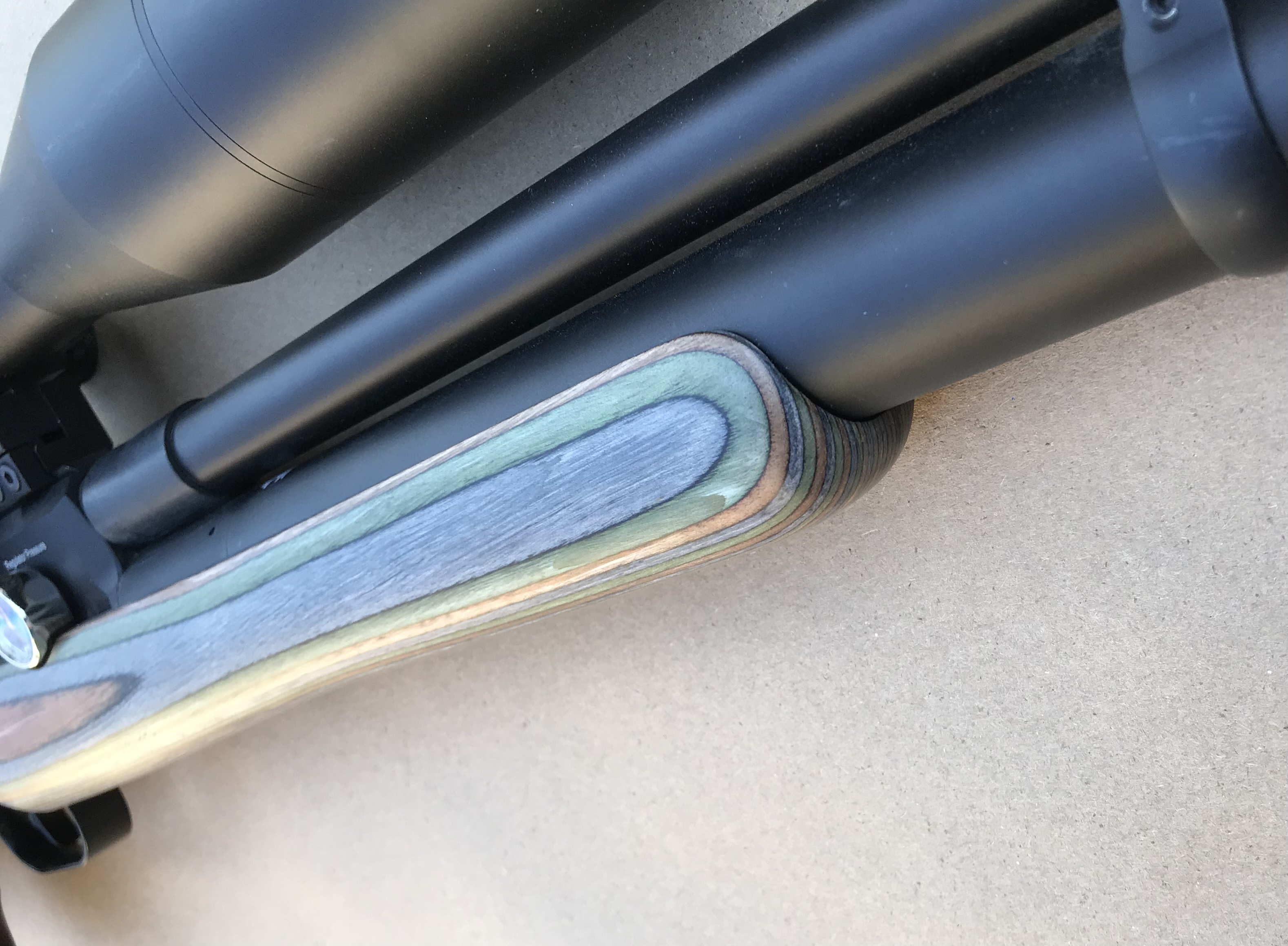

Oh, and the GRS Green Mountain Camo riflestock. From Krale.
I'm shooting 20gr .177 ZAN slugs with it and to be able to do this I have changed few parts when it was in Tactical settings (for JSB KO 13.43gr .177 slugs).
1. Huma High Flow V2 Dual Hole Transfer Port For FX Impact, Dreamline, Crown, Maverick and Wildcat MKIII
2. FX Dreamline Slug Power Tune Kit By Huma-Air
3. FX Dreamline External Power Plenum 17cc - stacked 2 plenums.
4. FX STX Superior Heavy Liner 500mm

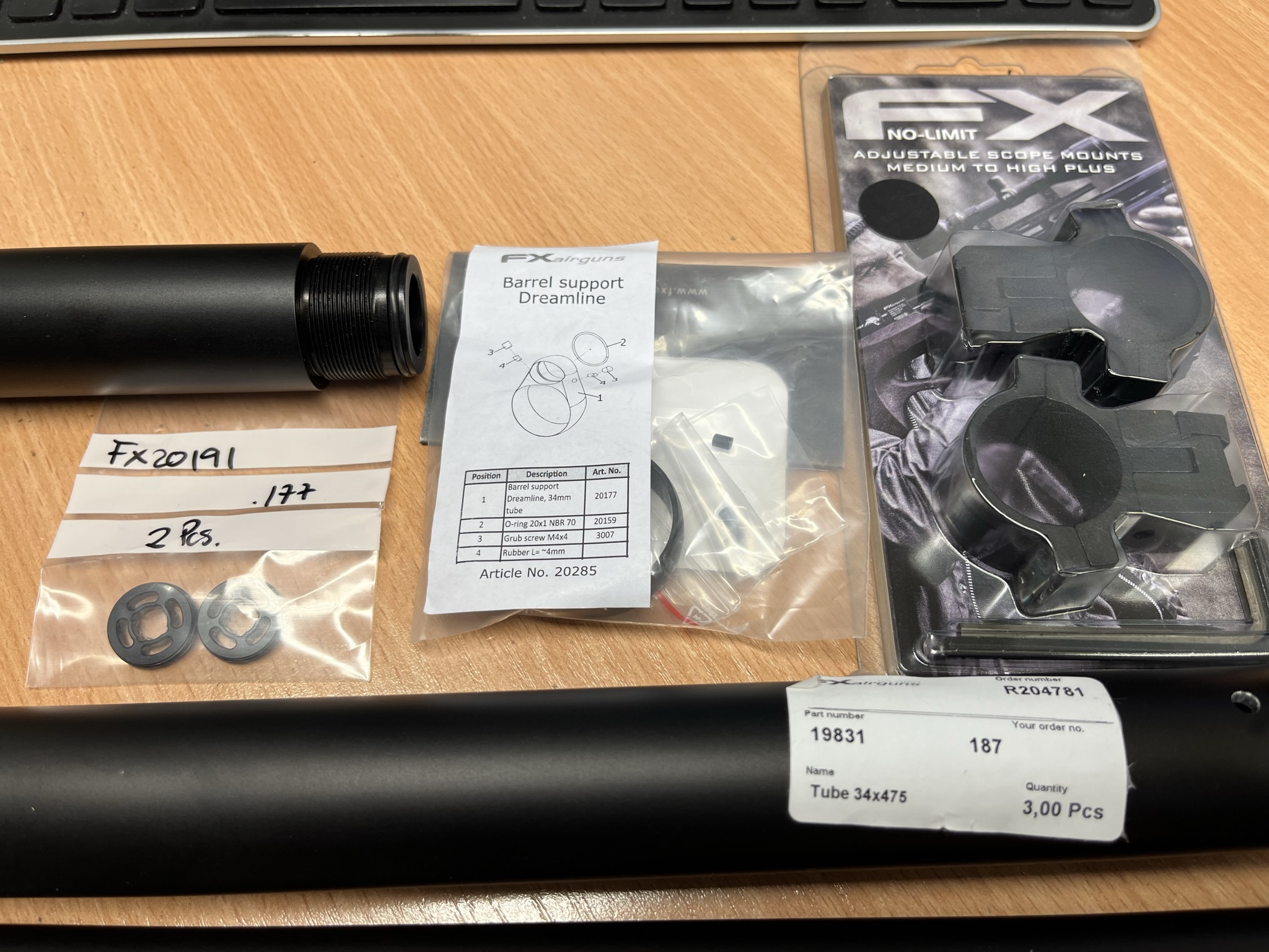

To go from JSB 13.43gr to ZAN 20gr, I switched from 500mm barrel to 600mm barrel. For that I had to order few extra parts.
1. FX STX Superior Heavy Liner in 600mm
2. Shroud 20x585 - 19867 - 1pc
3. O-ring 14,0 x 1,5 NBR 70 - 19718 - 3pcs
4. Pipe bushing 7mm yd 17,6 - 20191 - 3pcs
5. Compensator .177 - 19807 - 1pc
