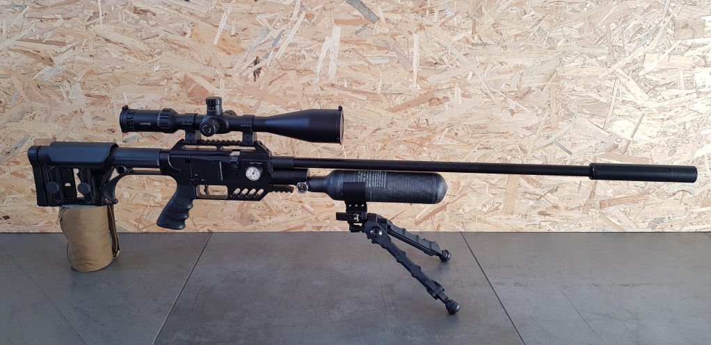

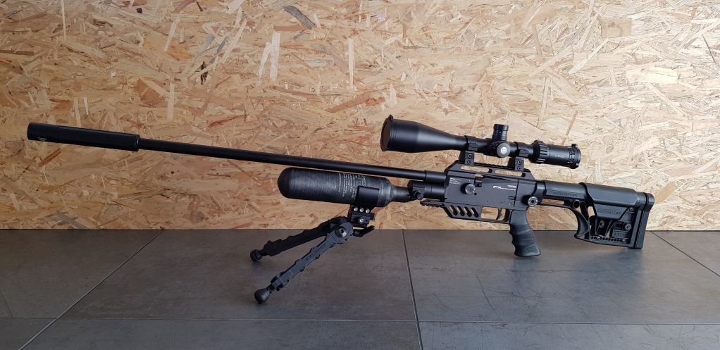

So what? I had been looking at the Dreamline Tactical for quite a while, with an idea in mind: having a good tune for the local 100m (109 yards) range. So I finally decided to buy the gun after I figured out what my ideal config had to be:
  • .25 cal
  • With 480cc carbon-fiber bottle
  • With FX plenum extension
  • Accu-Tac SR-5 G2 (since it has longer legs than the BR-4)
  • Saber Tactical bottle clamp w/ picatinny rail
  • CARM single shot loader
  • Wika reg gauge
  • Element Optics scope (either the Helix or the Titan... not sure yet)
  • Adjustable rifle stock Luth-AR MBA-1 (can be used with a rear sandbag)
Want to see pics? Nooo. Not now. With this $*# virus, international deliveries take soooo much time. CARM SSL, Luth-AR stock, PatchWorm .25 kit are still on their way. And the E.O. scopes are not gonna be available before mid-may. Nevertheless, I can already say that it's gonna be a pure beauty :)

It took a few weeks to get all the components for the new DL-Tac .25. And some time to tune it with the plenum extension. I'm using the optic of my Streamline because the Helix has not shipped yet.

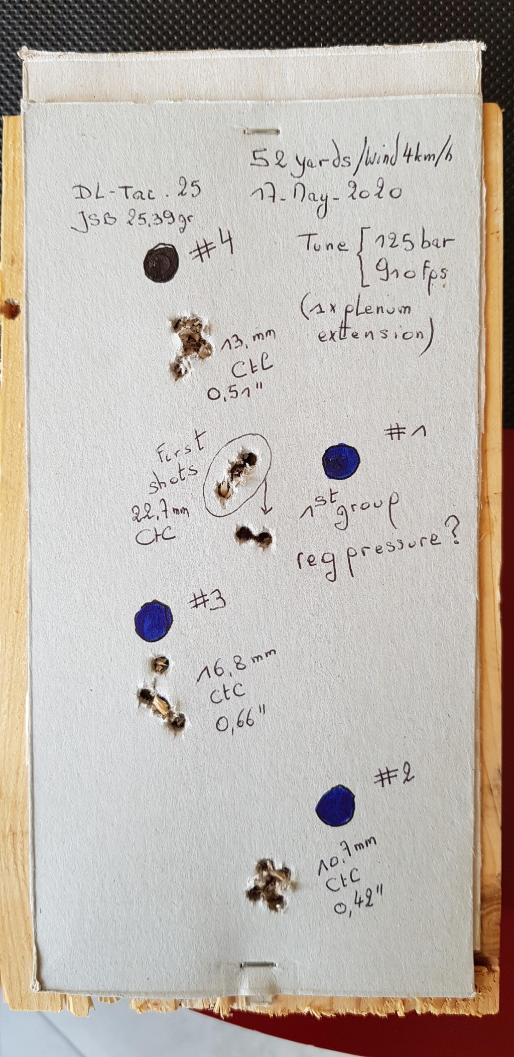

I've set the regulator pressure to 125 bars to shoot the JSB King 25.49 gr at ~911 fps (2.5% below the plateau velocity). ES for 26 shots is 11 fps. ES% is 1.2%.
Shot the very first groups @52 yards this morning (5 rounds each). Looks quite promising. Group #1 was not good but I suspect that the first 3 shots were are at higher pressure... I wouldn't be surprised to see this phenomenon for few weeks until the regulator is broken in.
After group #1 and #2, I corrected the windage, that's why groups #3 and #4 shifted to the right.
