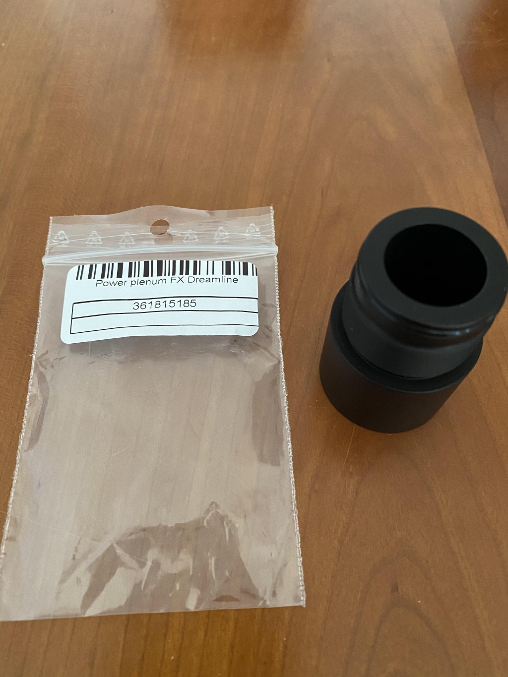

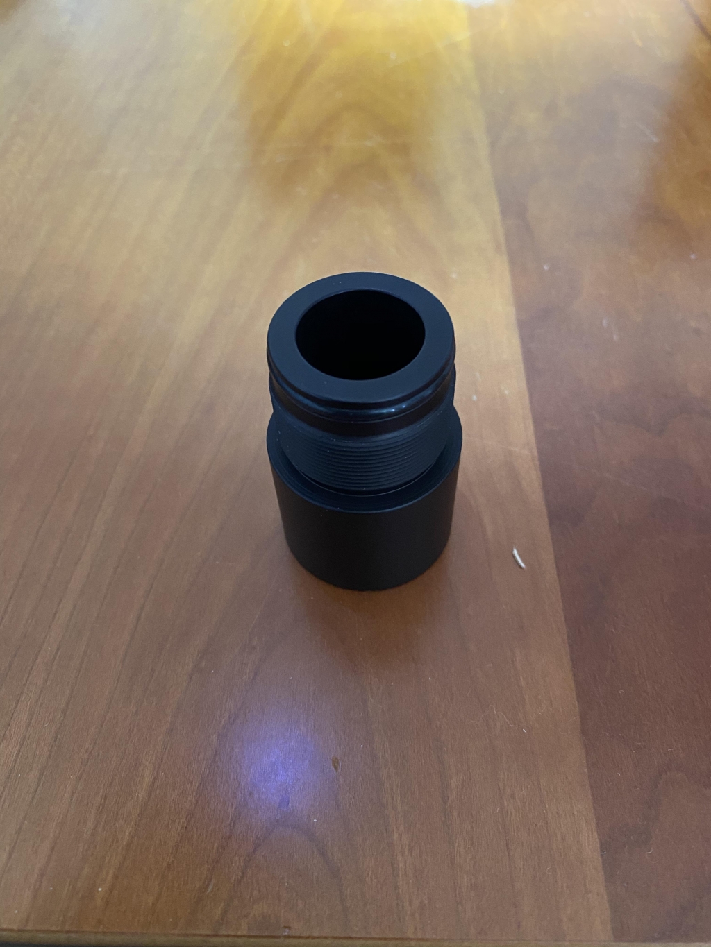

FX dreamline power plenum
it is only 380 for the 25
300mm for the 177 and 22
According to Utah Airguns the .177 and .22 are 380mm and .25 is 480mm.
The reason why this wasn't brought about before was it wasn't in the plans until recently is my guess. Why would they design guns that wouldn't work with this, like the Compacts and classics, if it was in the plans already?
https://fxairguns.com/wp-content/uploads/2020/02/F10184-dreamline-compact-kit.pdf
I believe what that is talking about is the shroud not the barrel. I know others have actually measured there barrels and confirmed the barrels are 380mm for the .177/.22 and 480mm for the .25.
Great thread guys. I've been trying to sort out how to make the .22 compact work too. I really want one, but the barrel shroud and bottle size is a deal breaker. Most of us are going to put a moderator on it so I'd give the minimal dampening. The other issue I have is bottle size, at 180cc it's too small. Having a .25 Wildcat, I really want a higher shot count. I've found a couple of CF bottles on ebay that might work for the Compact .22. I'm probably optimist to think either of those bottles will work with a moderator at the end of the 380mm barrel.
FX really need to provide more barrel options for the Lego gun. I may have to go with the Tact with 500mm barrel and 480cc cf tank, but I really like a shorter gun.
Dairyboy, I agree with your research. Current production sales indicates .177/.22= 380mm and .25=480mm.

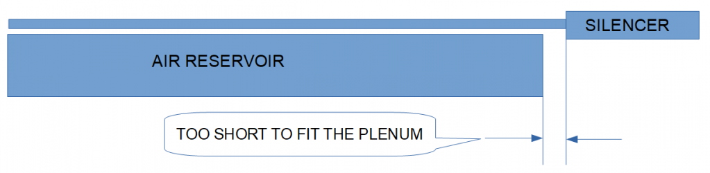

A 300mm barrel would technically be shorter than the 170cc air tube if i'm not correct.

This bottles could be fitted with the oe shroud but both of them are longer that the shroud. Ir you change the shroud you could fit a 0,37l bottle (61mm width x 230mm long).
Yes, the barrel of the compact it’s shorter than the bottle and more shorter with the plenum
