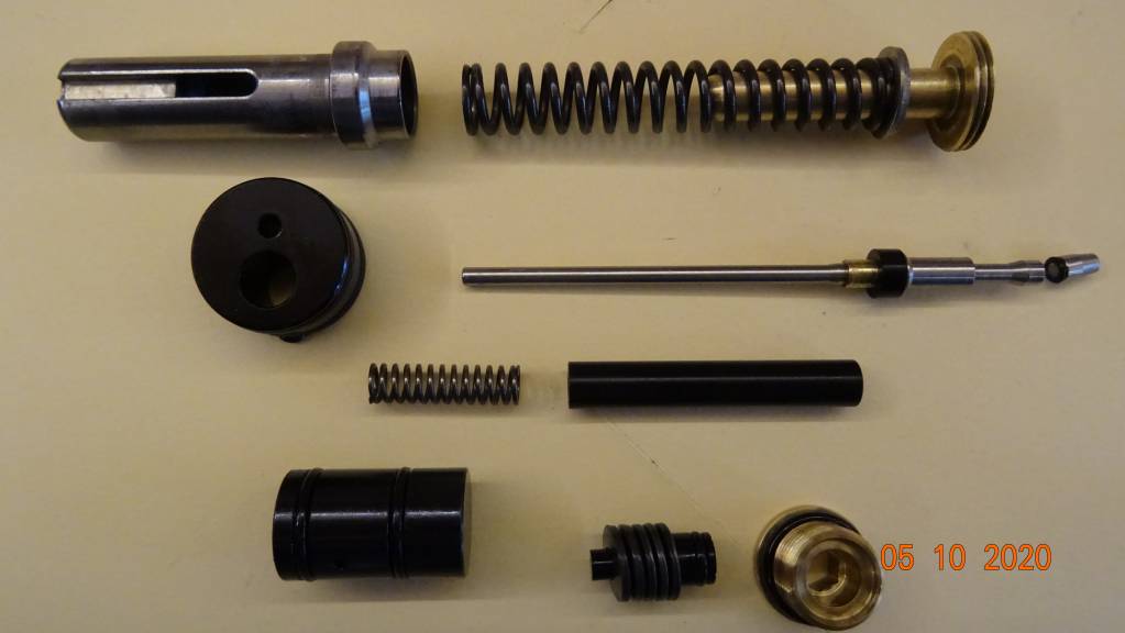

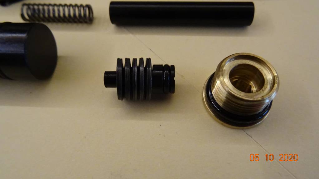

german parts - fx made some changes! we can see a guide on the valve needle and a shorter spring
german transfer port 1,5mm / 0,059"

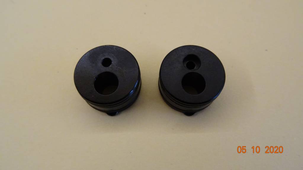

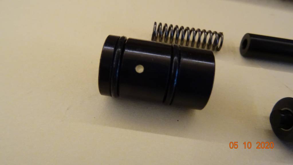

left german valve cover - right full power valve cover

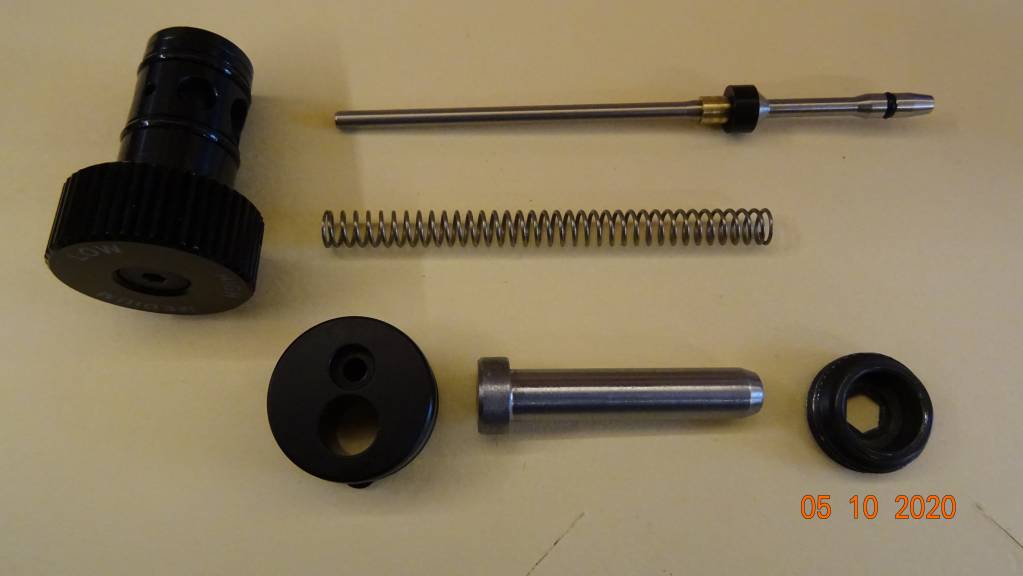

full power parts

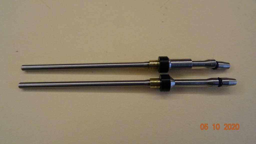

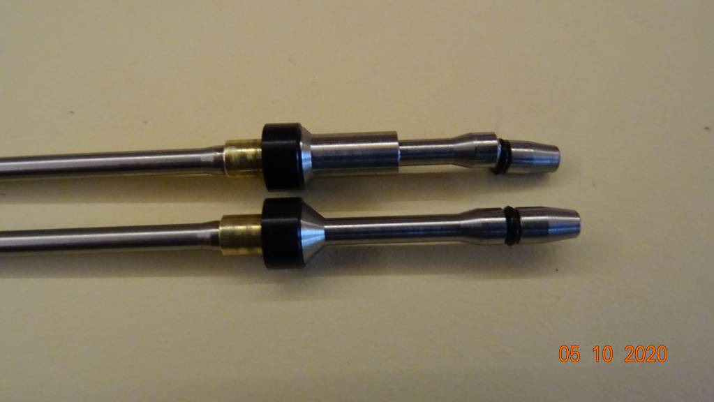

german vs full power valve needle - german version has a different throat and is allready broken

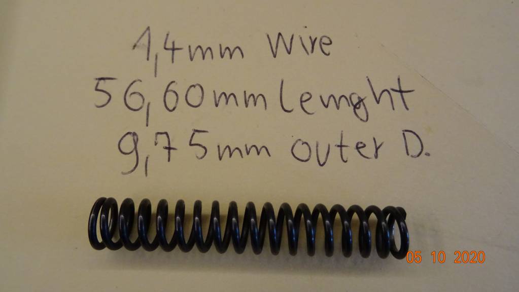

german spring or also the full power spring ? wire 0,055" / length 2,23" / outer diameter 0,38"
fx made setup for 7,5J / 5,5ftp
max preload with one washer
60 bar reg pressure / 1,5mm / 0,059" transfer port size
very stiff to cock and after around 2000 shots fired the valve needle allready broke

can someone explain to me what the different shaped needle does ? releases it with less travel more air ?
Please note I have no experience with the Dreamline but stiff to cock and the same hammer spring at 7,5J makes no sense to me
I own a the FX Typhoon in 40J with direct pull hammer, not side lever with gearing as the Dreamline and find that quite easy to pull, also to compare I have a Röhm Twinmaster with the regulator set up to go 150m/sec (with a much shorter barrel) with same 0,547g JSB pellet and I can cock the hammer with my eyebrow :)
Also the volume of the "plenum" of the twinmaster is next to nothing, so may guess is its about restriction in the airflow - that you could change the hammer spring for a much weaker one and open the air flow for the same result - and maybe a lighter hammer for faster lock time
Difference in valves - your version seems to have more mass in the stem and maybe that is was reduces the airflow? - again I do not know anything about the Dreamline so really not in position to give other than general advice :)

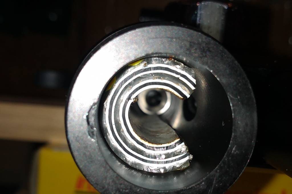

i did some more testing and reduced the plenum volume and with a reg config of ()()()()( its possible to adjust below 50 bar
