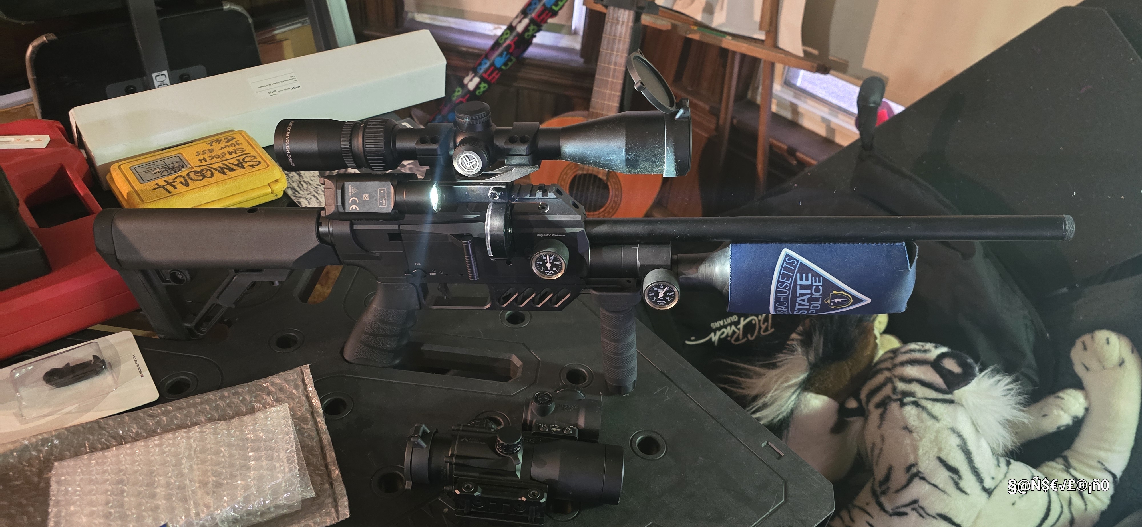

I did end up being able to acquire the tactical kit from UA. Installed it, than got the UTG S1 Ar stock. I also bought what I thought to be the folding stock adapter but it ended up being for the Dynamic/Pantera.. ( it has the 4 screw holes threw it.) should have known.. Im going to have to send it back or perhaps sell it for cheeper than what paid to someone on this site. Than I'll have to get the one that is needed to make it a folder.. or maybe even just keep it the way it is. It seems as though the folding stock adapter would make the gun 2 or so longer but wonder if it'll actually make this a true back packer! Of course I get this after the new Pantera compact just came out for around 1,500$.. But I did get a great deal on mine so definitely not complaining. Hey one question I'm sure that has already been answered about this compact bottle version of the Dreamline. Am I able to boost the power without doing any homemade stuff. Like by installing a have your tungsten hammer and spring kit that FX offers? And or changing valve to a Huma air lager diameter to a 6.3 mm from the 5.5mm that the Dreamline posseses. I believe the crown & the impact both share the bigger 6.3 valve, thus putting us/me @ a disadvantage right from the start.
All the information that I have acquired was from doing searches on the site in reading more into about how this particular gun works. Apparently with a heavier spring I believe to be a 13 test/pound, in conjunction with proper valve and Hammer spring as well as perhaps even new STX barrel that will support slugs would allow for better gains on this particular gun. Any help will be greatly appreciated. I'm also not trying to steal this tread just revive in a bit. And I think both of you who chimed in to help me perhaps you could give me some more insight on these new questions & concerns about power & and tuning thank you, -SF
